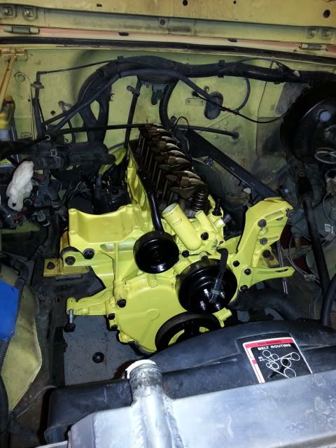

I have everything pulled on the engine down to the bare block and head. I was looking for a place to attach a chain to pull the engine and put in my new one. Are there any specified lift points on it? Thanks.

Here is a pic that shows where I attached the chain when pulling the 2.5 and then installing the 4.0L. The side that you can't see is attached to a manifold bolt, furthest back.

Thanks thats very helpful. Is the near side bolt just in one of the alternator bracket holes? Ill pick up a couple of grade 8 bolts to put in there next time Im at the hardware store.

Yep, you got it. These motors don't have many attachment points, but these locations worked great when I did my swap. The drive train will be at an angle when lifted, but it so happens that this angle is perfect for sliding the tranny down into the firewall. With a tranny jack placed below the rig to catch the transmission, everything then levels out perfectly as you lower the engine down onto it's mounts.
