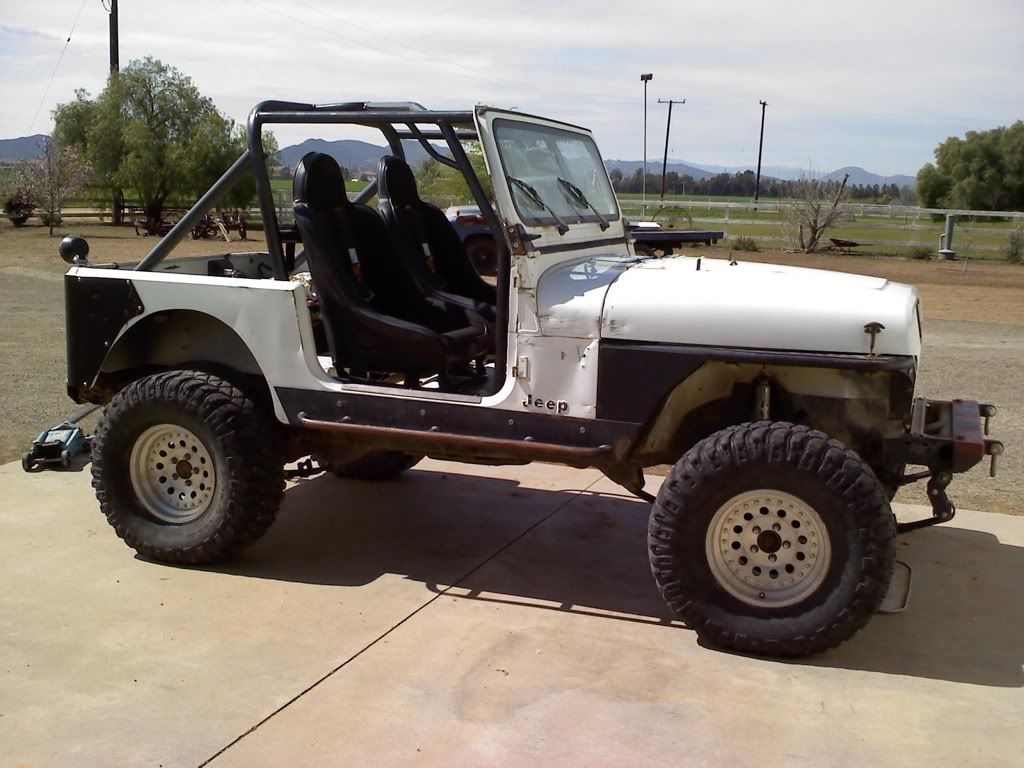

What I started with
-RE 2.5" springs
-33" MTZ's
-Dana 30 with lockright 4.88 gears
-Dana 44 with ox locker 4.88 gears

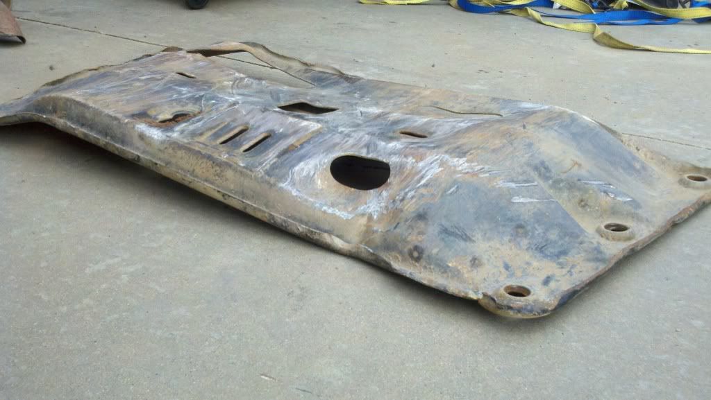

Stock skid took a good beating

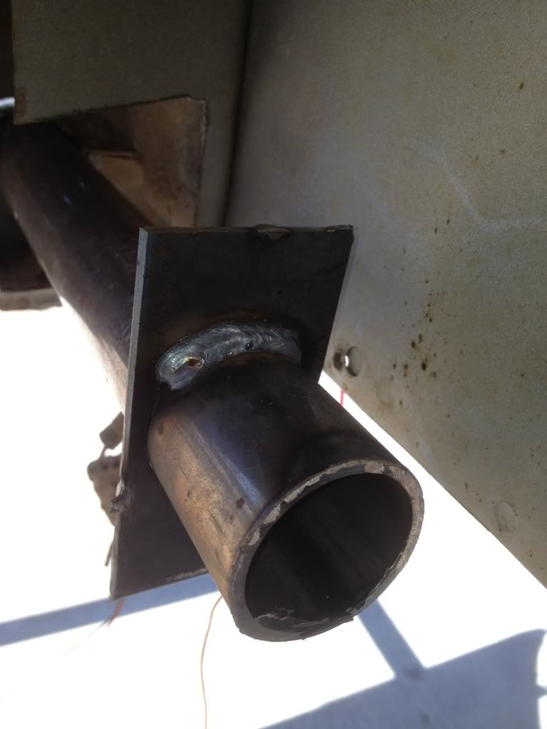

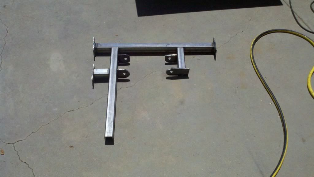

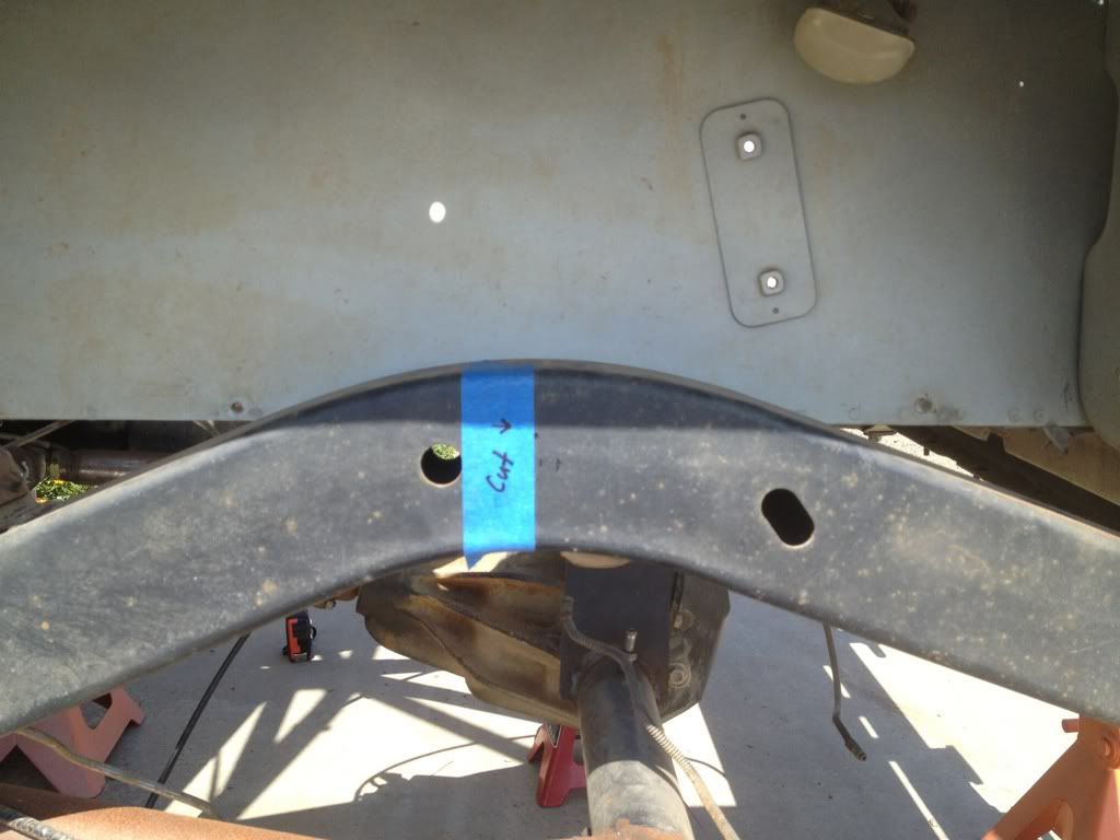

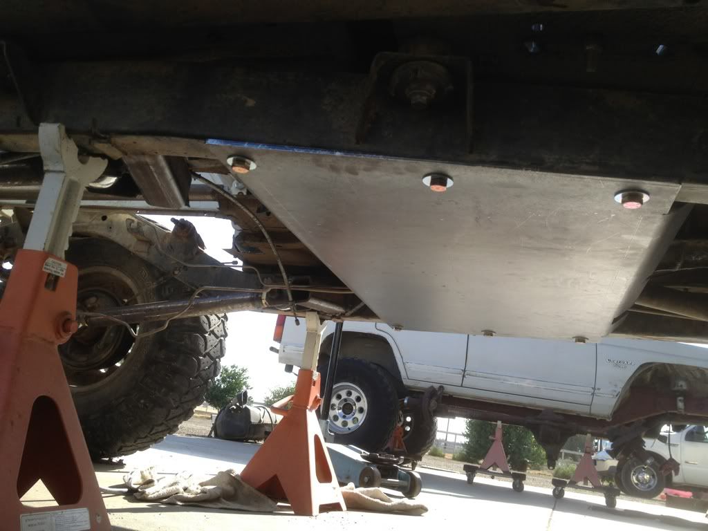

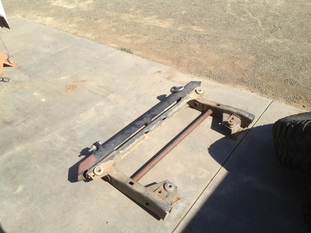

So I built a trans crossmember to get the skid plate flat with the frame

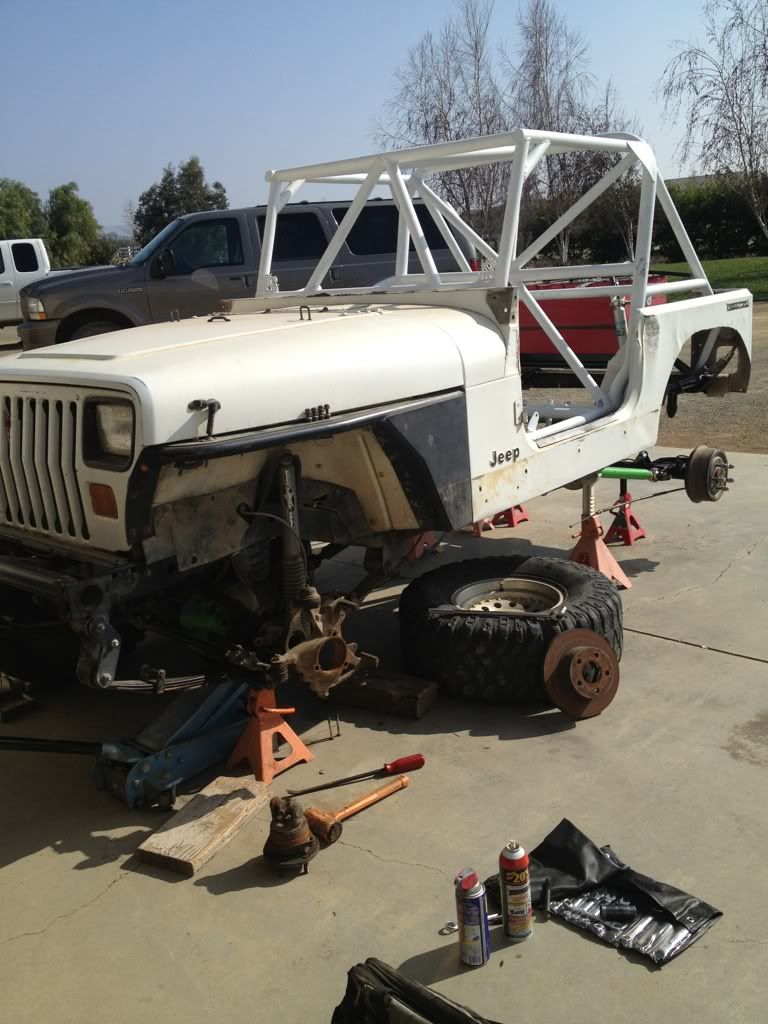

Redid the cage
Then the fun started

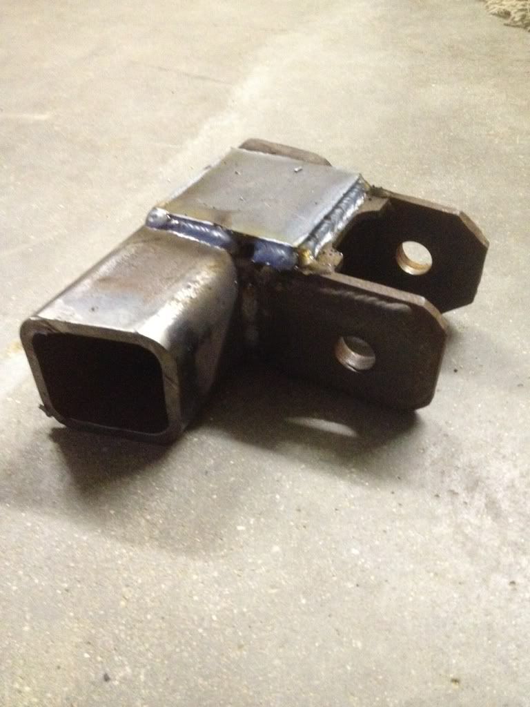

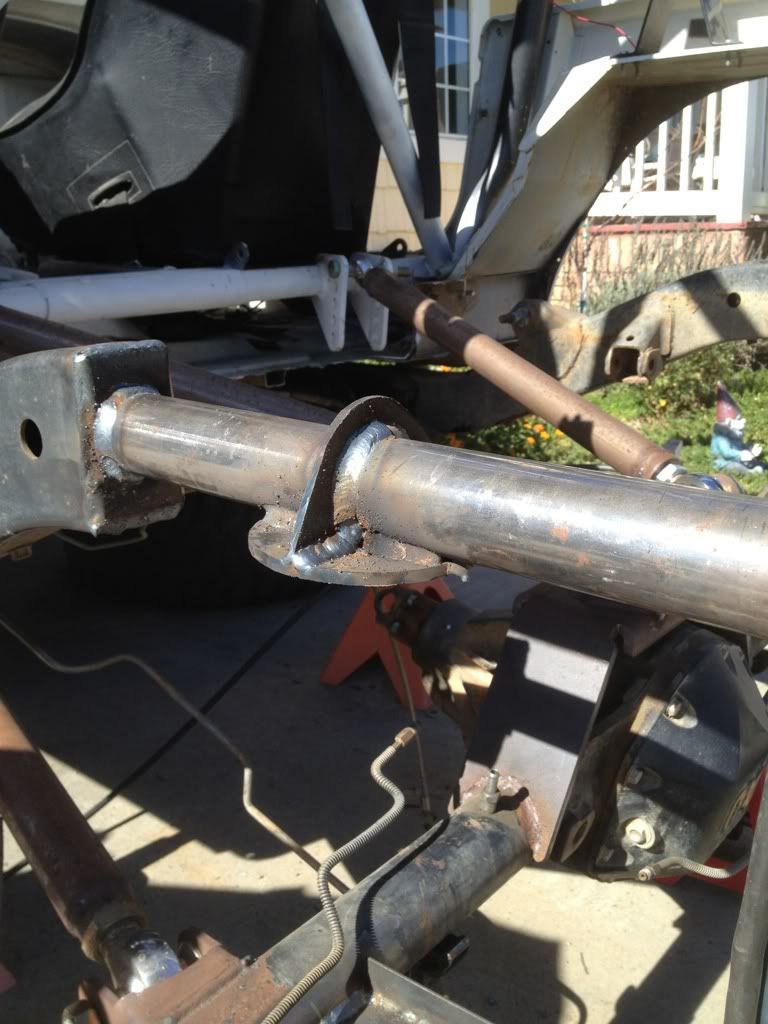

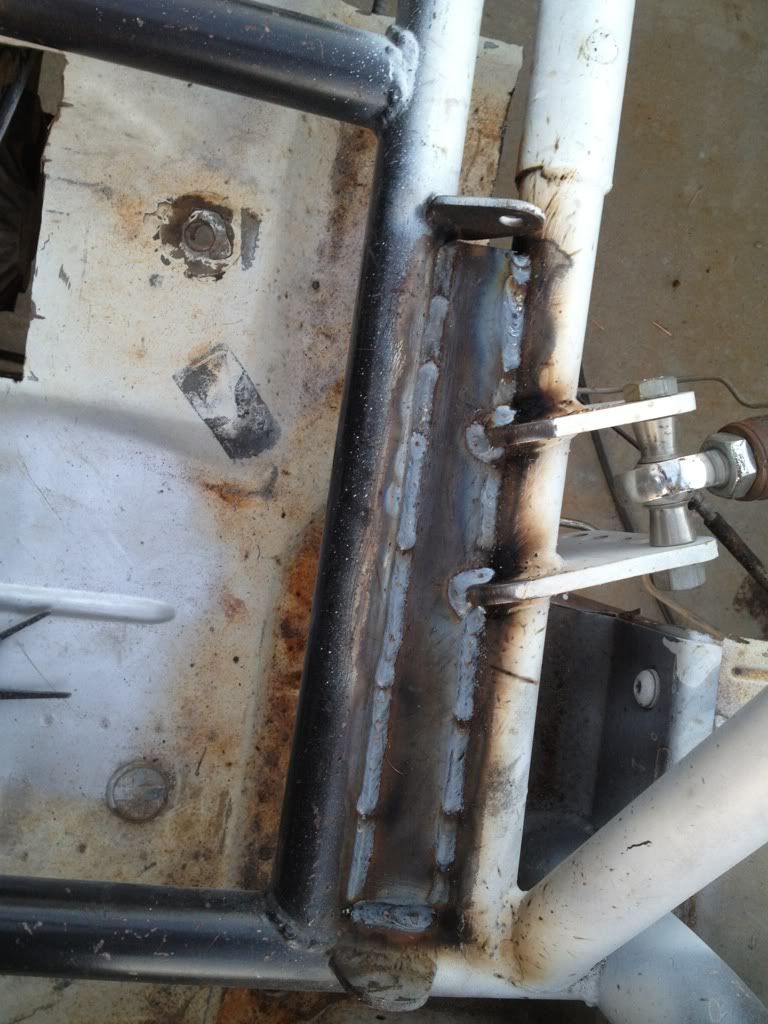

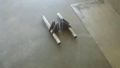

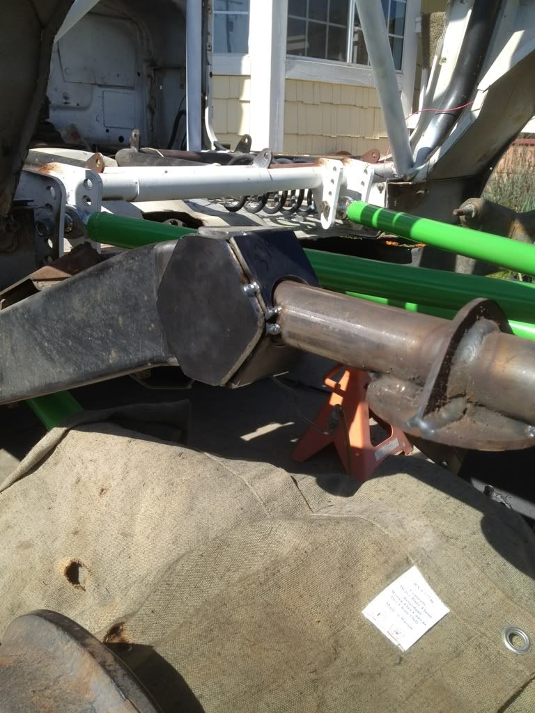

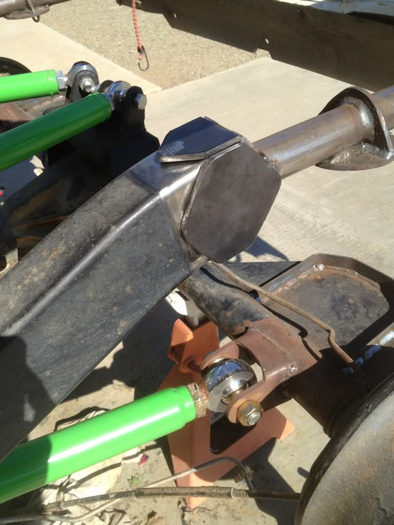

-Rear 4 link with 7" rear stretch and XJ coils
-frame backhalf
Lower link mount

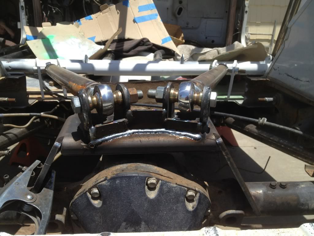

Upper link mounts
4 link
Full bump
A little more cage work

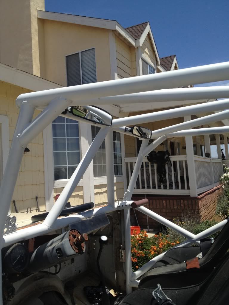

Intake
Frame backhalf
Coil mounts
More frame work
Barnes 4wd skid plate

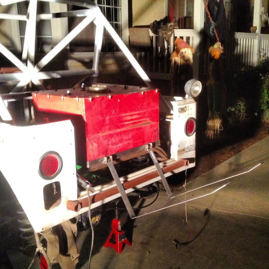

Fuel cell mount and shock mounts
Built a new rear driveshaft

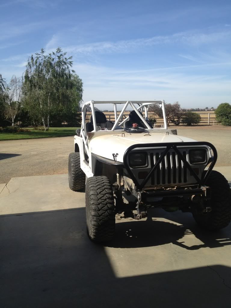

How it looked the day before KOH
At KOH and it's shake down run

need more pics of the skid and cross member
mudonthetires43 is offline
post #6 of 41 Old 02-21-2013, 11:45 PM Thread Starter
JasonMiller
Location: Menifee
Posts: 41
Originally Posted by caddyman View Post
You running TJ springs?
I'm running XJ springs
I'll get some better pics of the cross member the next time I drop the skid but its just 1.5 x .120 wall square tube and here's a link to the skid plate https://www.barnes4wd.com/mobile/home.asp?#page-97

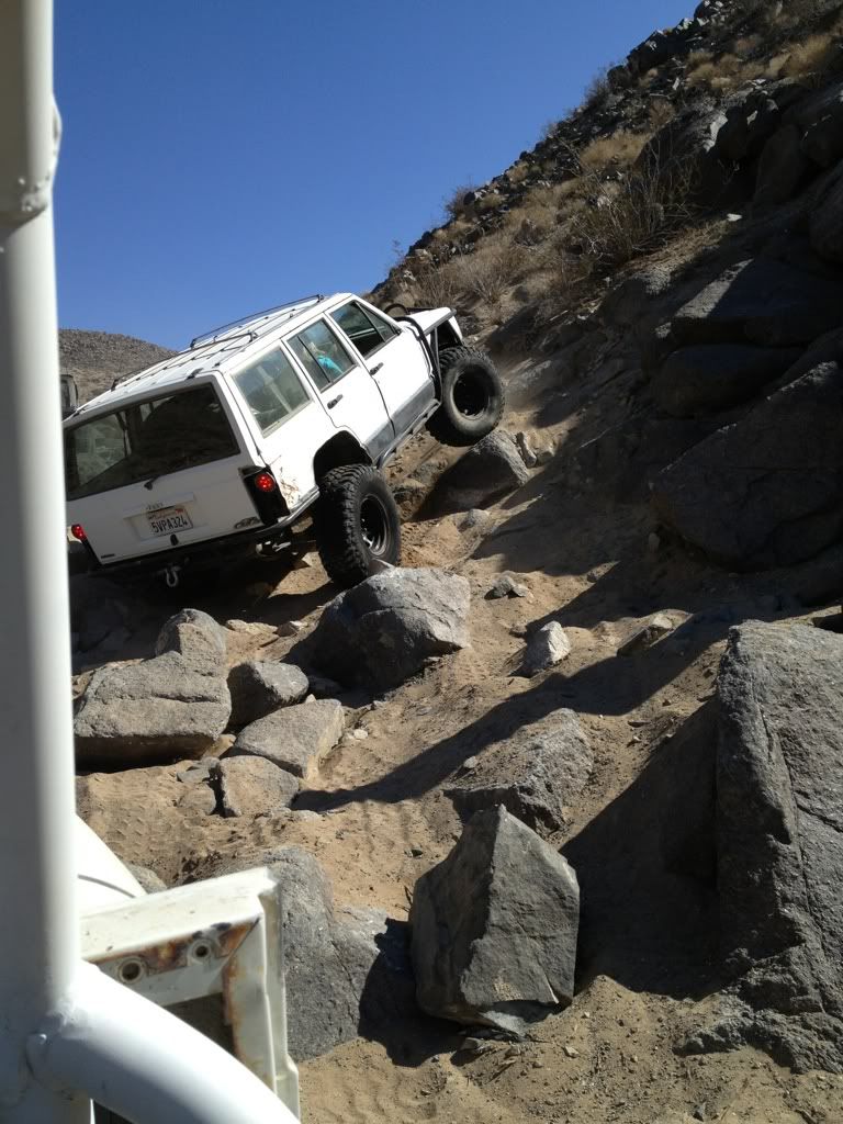

found a few pics from KOH

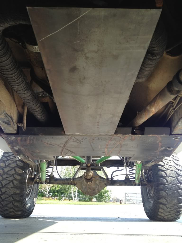

Oil pan skid plate 1/4 plate with 1/8 angle iron
Nice and flat

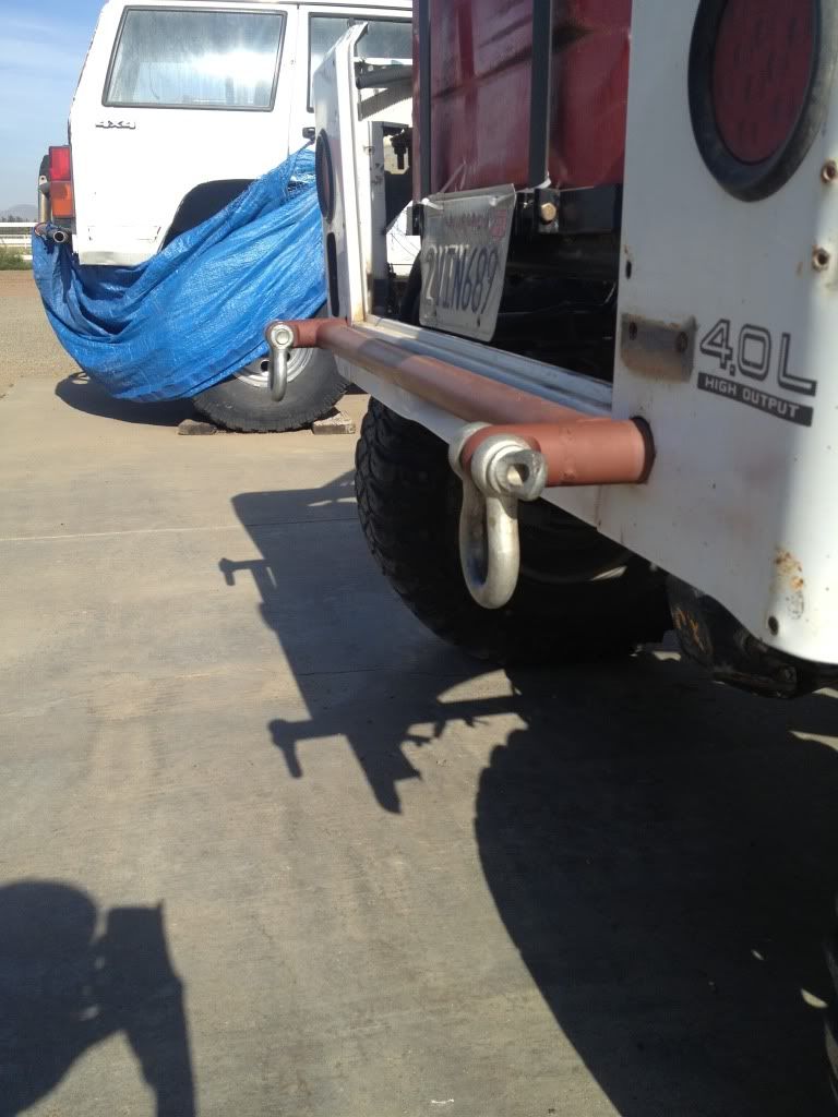

D ring mounts

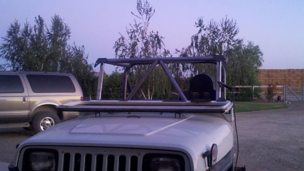

And built a grill hoop

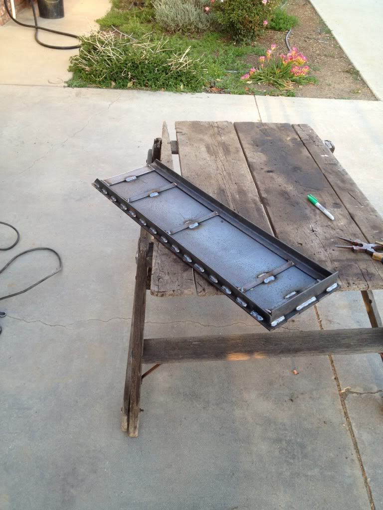

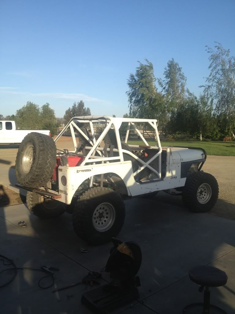

Started building my spare tire mount today
