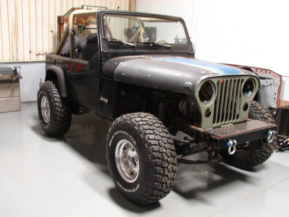

I got the CJ grille stripped down and coated with Self Etching Primer and the hood is bolted on and lined up. I had to extend my lower grille support over 2" to accommodate the shorter CJ hood. It ended up being a lot more work than I thought because my original mount was pretty rusted. Before I had the CJ hood/grille, I cut and bent a piece of 1/8" steel plate, chopped out the old rusted metal and welded the new piece in only to find out that the grille need to be moved back and I had to cut it out and do it all over again with a longer piece of plate. Now, it looks like it came that way from the factory. I'll take some pics of the lower mount when I pull it back apart for paint.

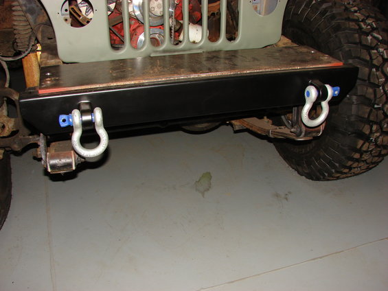

I also made some pretty good progress on the front stinger bumper and winch plate. The winch plate will actually be integrated into the front bumper and stinger that I have yet to bend up. I'm going to reinforce the stinger with some tube into the tube bumpers.

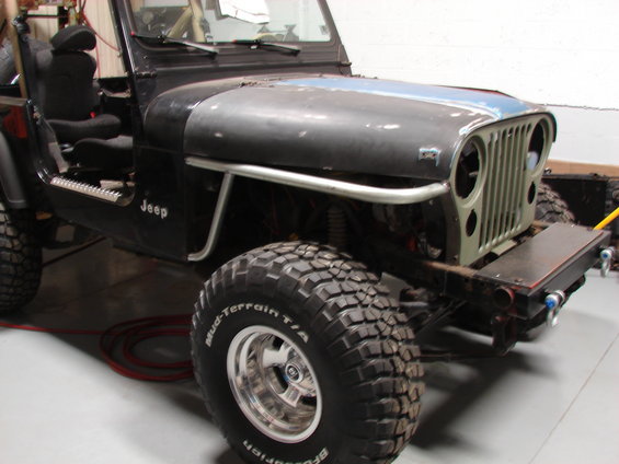

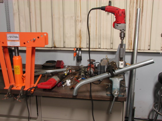

Today, I started bending up the tube fenders and tube flares and so far I'm liking the way they are turning out. Notice the cheap harbor freight pipe bender and the notching tool in the one pic. The tube flares will be tied into the sliders and be totally integrated all the way back to the rear tube fenders and flares.
I'm using 1 5/8" pipe packed with sand in the 1 1/4" pipe die and it's not kinking it too bad. It will probably be even cleaner if I were to wet down the sand, but I'm too lazy and don't want the mess all over my shop.
Here are some updated pics of how it sits now:
