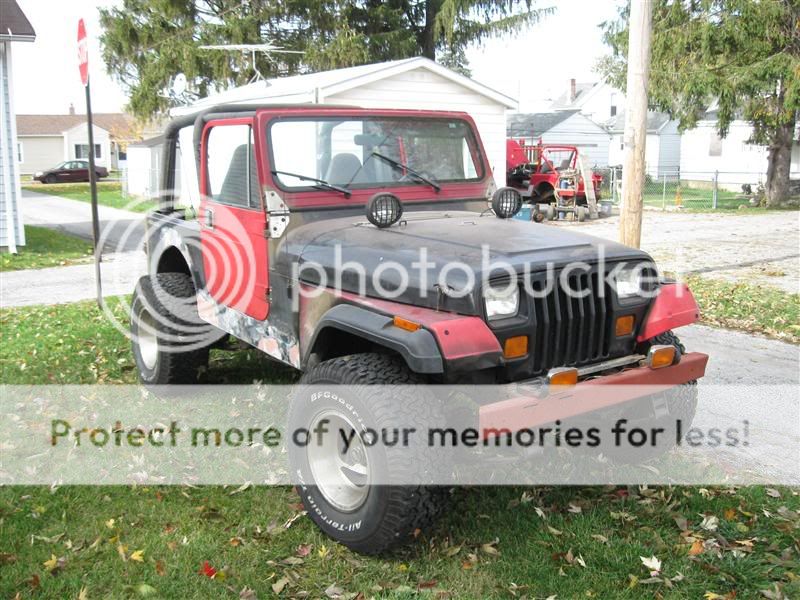

The thing I did like about this Jeep was the fact it had a 4" lift already (mind you it has sagged and sits at about 3" now) 33" BFG AT's and a 4.0, Ax15 combo. Which is what my first 95 was, it even has the Hurst style "T" shift handle like my first did.
Here is a couple pics of how it looked when I got it. Note the custom "flat" fenders made with some street signs. Not my cup of tea.

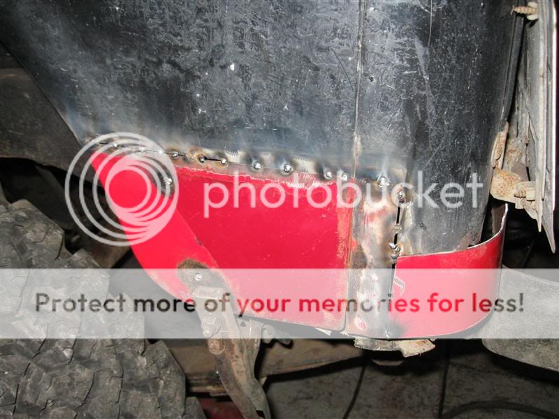

Since I have given away the secret of the fenders here you go. I stripped "Olive" of her front skirts to give way to legs that had not been shaven in many years. I had to break out 80 grit to rid her of the nasty appendages growing below.
After a whole weekend of cleaning, patching with steel, and painting. Olive actually had rather sexy legs up front again.

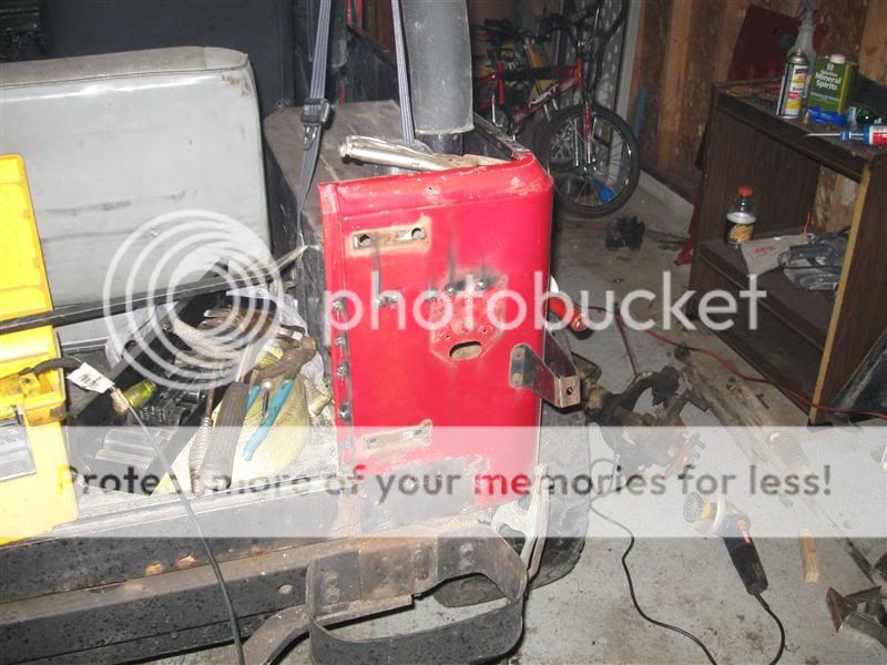

Now on to the sight glass on the front. I need glass on there or I would not see for long. I had to rebuild the windshield mount on her again. This task for involve the red steed placed outside my garage.
There was alot more weld involved than shown in pics. I have a hard time stopping to take pictures while working, that would involve washing my hands of there hard earned dirt.

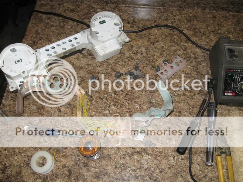

Now for a break from body work, the tach and dash lights did not work properly. I figured a broken wire and some bulbs, Man was I ever wrong on this one. I pulled it out and found the ribbon cable has about a horse stall worth of mud and leaves in it. I dig this out and find that the cable has corroded in two.
I walk out to the 89 thinking I would just swap gauges. OHH no the Jeep Gods say "We have changed the gauges at some time unknown to me." Me growing up with a dad that was a machinist during the day and an electronics repairman at night has its' benefits. I break out the solder gun know I have seen this before on my dad's home work bench.
I put in jumpers past the bad sections, installed some new bulbs and fire her up. To my surprise it doesn't work, I thought for sure I had it. I dug deeper and find that the PO had cut said tach wire behind dash to install his little old Sunpro tach. Fixed the plug and reinstalled, Woo Hoo it works this time, Thank You God.
It was bugging me, why have an aftermarket tach when one is in the dash.

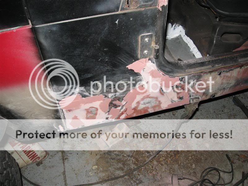

On to the lower rockers and the holes that lie beneath.

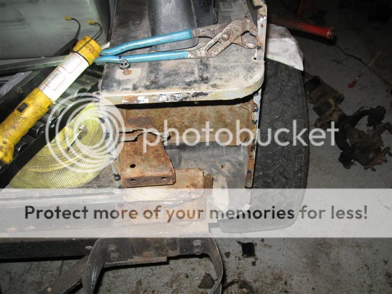

Also the cab corners where shot as well.

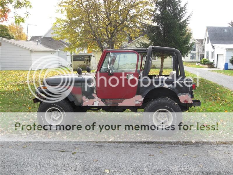

And many hours and weeks later. I missed atleast 2 weeks of work with the camera sorry everyone.
I got some paint on her finally, You also learn why I named her "Olive"
