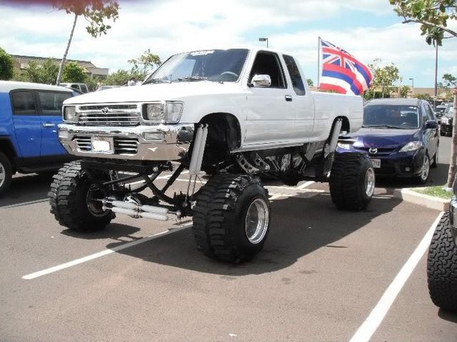

Originally Posted by AmmitOsiris View Post
Well looks the three of us have matching opinions
That and it will look like this... If that's your sort of thing?

Originally Posted by roadyrob View Post
I have run 31" 10.50 on 10" rims for about a year. I have had no problems with them but haven't aired down. I plan on switching to a 8" rim next week but that is because I found some rims I like, not because I had a problem.
EDIT. also, 10" rims will not effect your turning radius and they don't rub. backspacing determines that.
Two points "you didn't air down" tells me you didn't run sand dunes as the OP is seeking advice about. You won't go far with aired up tires in deep sand, I have a second home at Glamis and know sand dunes. Point two, yes backspace is what affects turning radius, but unless you're running 10" rims with 3" backspace you're going to rub. That little backspace ( as the photo above shows) puts more weight on your bearings and ball joints, same problem wheel spacers cause.
