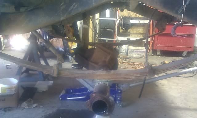

best I can do till tomorrow this was just before we welded perches, 29.9... its steep..... dshaft lines up tho

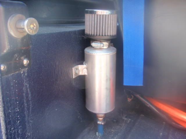

Attached to the vent. Allows you to overfill. Fluid dumps into the can when it gets hot and expands.
Makes pinion bearings happy.
I like this idea
