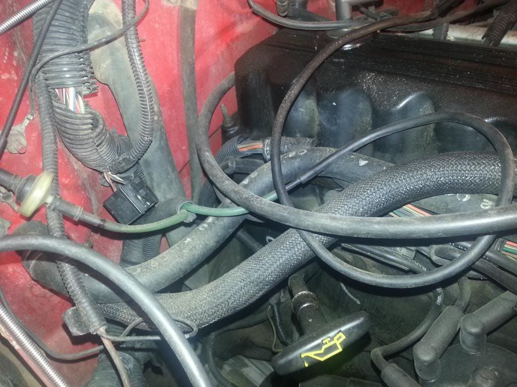

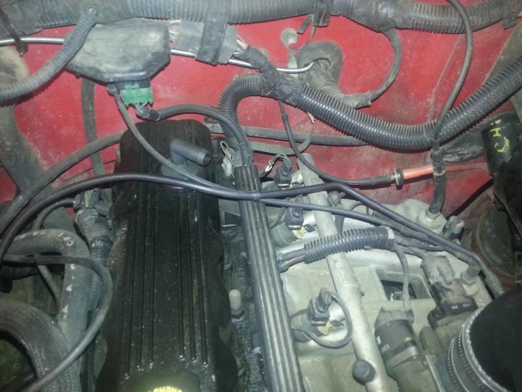

Hey guys my rear pcv valve on my valve cover isn't connected to anything(bought it that way). From my searching on here it looks like it is supposed to connect to one of the intake manifold vac lines. Unfortunately, the line that is maybe should go there is hooked up to some other line that runs OVER the valve cover and disappears under the jeep. My question is has anyone else ever seen this setup? My guess is the previous owner did this but not sure. I have some oil showing up in the air filter from the other pcv valve (the one on the front) so I'm wondering if this may be the cause. Here are some pictures:
Sorry if the pictures are huge...first time trying to post a pic. Thanks in advance for the help!

Hey bud I can't see what engine you have or year from the app but just judging by the pics I would say that the PO saw oil in the filter and decided that it was best to disconnect that line. Is the factory intake on?

It is a 94 with the 4.0. And it had the factory air box on it when I bought it but it was trashed so I replaced it with a cold air kit...maybe not the best choice...time will tell.

So looking at the diagram for the 4.0, it definitely needs to go to the intake. Problem is, that line it should hook up to is already in use...in fact all the lines are used. That third line down (according to the diagram) is the right one but for some reason it is hooked to another line and runs somewhere under the jeep I tried to track it but I loose it. Should I just say screw it and reattach it to the rear pvc valve?

Joker may mean a t-connector. Question is what if the line is just pushed down and not connected to anything? It can't be more that a couple feet long.

yeah wow I'm curious where he hooked that vac line up to... maybe the 4wd front axle disconnect wasnt working so he did that (I think that's run by the vac)?

I think you may be right. Just checked where the mystery line goes. It is definitely connected at the other end to something. It joins with the vac lines that connect the front axle disco and the tcase. But the lines are wrapped so I can't see specifically where it connects to. Here in a little bit I'll see if I can separate the mystery line out from the rest. The suspense is killing me
