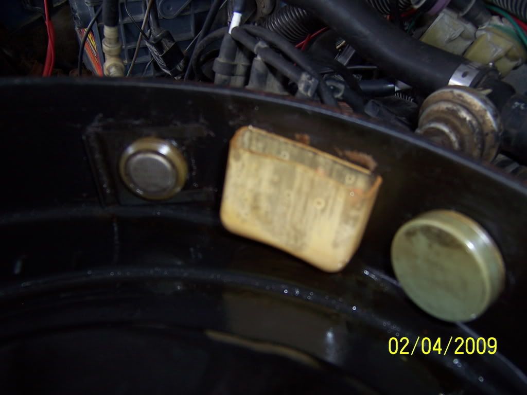

Check out this post, http://www.jeepforum.com/forum/f8/bl...9/#post9747906, I believe that's the "filter"/rear hose he's talking about.
The hose on the rear of the valve cover is just an intake, or rather a blowby vent for YJs

I had my kid take the picture.

Thanks to the both of you for link and pictures.
Jmac, when you get a chance where does the hose closest to the oil cap run to?
If I read the link correctly it goes to the air cleaner. But the way that hose on yours drops down it does not look like it.
