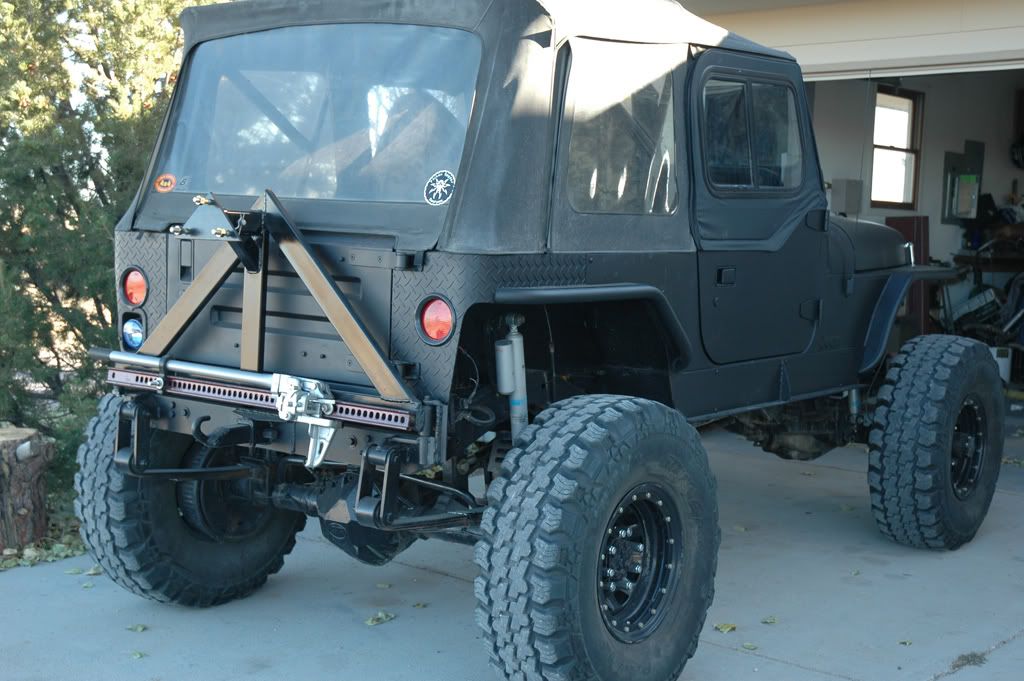

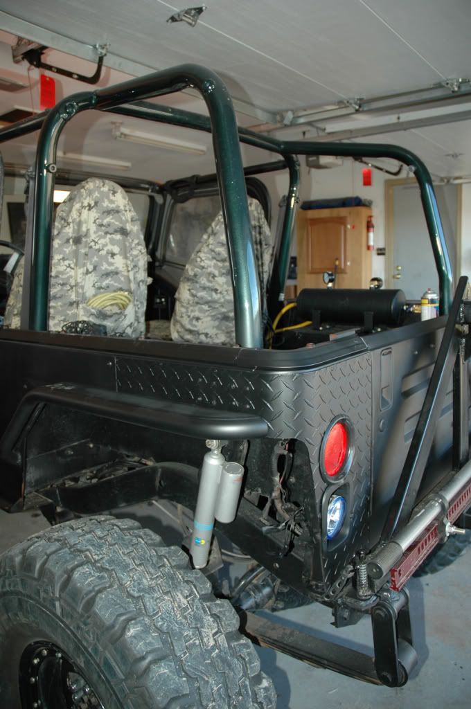

Thanks Max. I work on my jeep alot, my wife has horses so that allows me lots of time to work in the garage. We have a metal fab shop at my work so I've spent a few hours there too. TSE Jeepers you probably won't have room unless your wheels have alot of offset. I first used the ford style mounts, like in the link above, and my shocks rubbed on the tires a little at full flex. I eventually broke one of the welds on the trail, so I redesigned the mounts and moved them a little closer to the frame. Now everything clears but if change wheels I may have to redesign my shocks and sink them into the frame. The mounts I used are different ford superduty ones. I have seen one that the guy used more style shock hoops on the rear and sunk a piece of channel into the frame so The shocks would clear.
