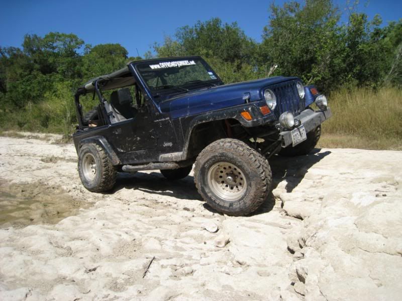

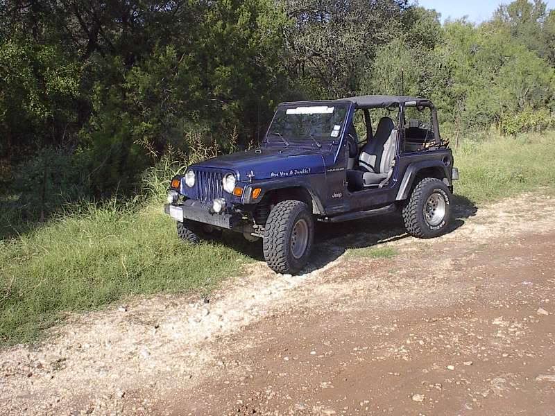

here are mine...
my wheels are 8"

Well, I'd say to stick with the 8" rims with those tires. Since the tire is only an inch and a half wider then the rim, you'll only have an overhang on each side of about 3/4". You'll be more likely to thrash a rim out on the trail, and more likely to blow a bead when aired down.
If you were going with a 13.5" tire, a 10" rim would do fine, but with the 11.5" rubber I say stick with the skinny rim.

Thanks for the input. I've just got stock wheels & tires now & wasn't sure what i needed. Generally speaking where is the "break" to a wider rim? 12.5-13.5 ? OH Nices pics to!! Thanks
