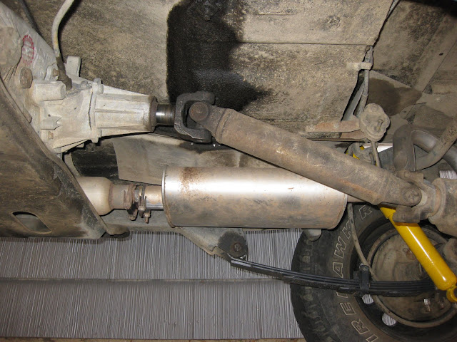

Before T-Case Drop:
After T-Case Drop:
Still not the best angle, but took care of my vibes.
If you have a problem with the T-Case shifting, here was my solution!
