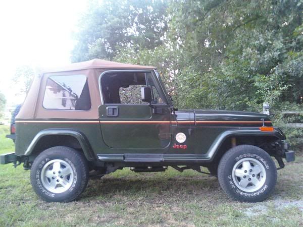

Here are the pictures of the OME 2.5" lift installed on a 1995 Jeep YJ Sahara -
stick some nice 31s under there and open the flares up and this is how a STOCK YJ SHOULD have been sold as - IMO
I cant wait to get this kit, its on my list for my next lift right after my aussie locker install, I've been able to do most of what I wanted to do on my 30s and 1.5" lift, I cant wait for 2.5" and 31s
I agree completely. This look is perfect .
