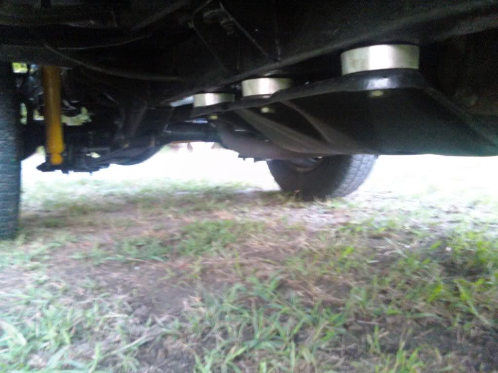

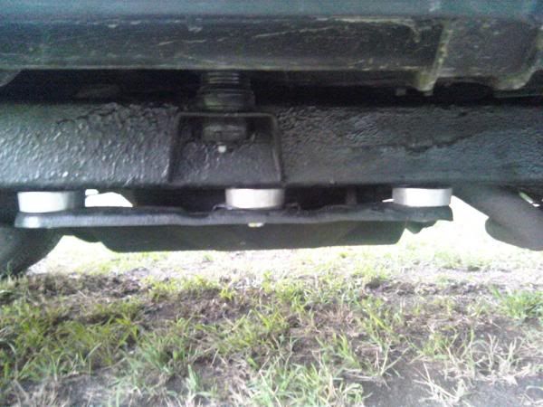

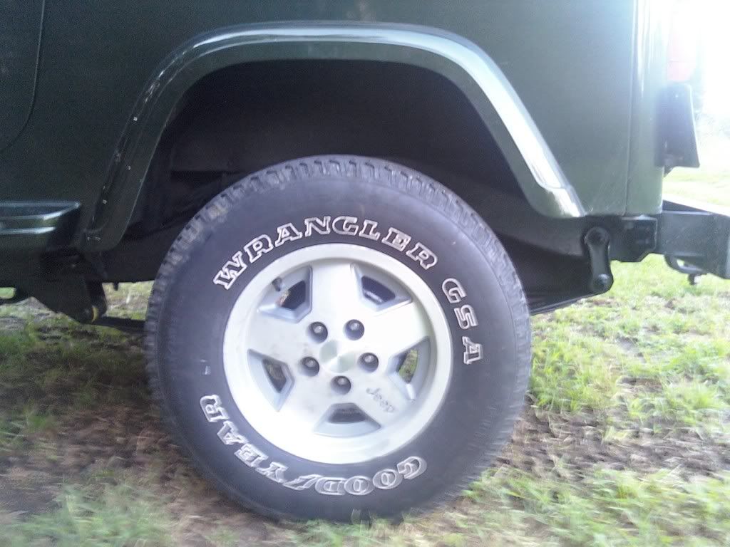

Here are the pictures of the OME 2.5" lift installed on a 1995 Jeep YJ Sahara -

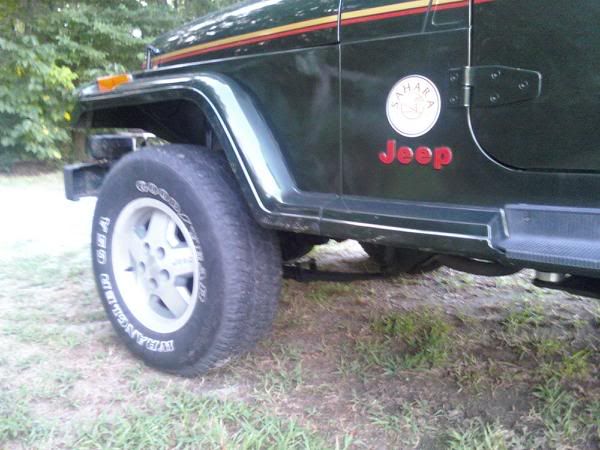

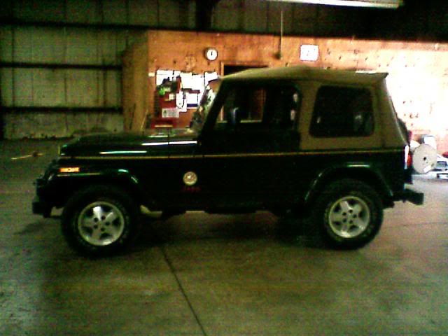

Here are some before and after pictures. The Jeep still have the stock rims and 29" tires on. I'm planning on keeping the rims; I really like the way they look. But eventually plan on going to 31's when these tires wear out. The pictures show the amount of the lift and leveling achieved by the system. I hope these help anyone who is contemplating whether or not to go with OME. I looked all over the net trying to find a before and after shot of the kit installed on a YJ with stock tires, but had no luck. Anyways, here it is-
Before the lift:
Once again, after the 2.5" OME lift:

Also, I getting a vibration at 40mph and above. Did any of you guys have issues with this?

Moonshine, since you just installed your kit, did you have any vibration issues with the rear drive shaft like I just stated above?
southbound is offline
post #41 of 59 Old 08-23-2009, 09:46 PM
moonshinefuel
Location: Los Angeles. California. United States.
Posts: 4,910
Actually I have not installed it yet. You are ahead of me. Your rear springs look right. You lowered the transfer case. What degree shim is in it now? 2 degrees? Because I don't know myself. I never asked the degree of the shim OME sets in there.
AX5/NV3550 Conversion Thread.
Bow Hunting
moonshinefuel is offline
post #42 of 59 Old 08-23-2009, 09:51 PM Thread Starter
southbound
Location: Augusta
Posts: 719
My kit didn't come with any shims. Nor did I have any on the old leaf springs or on the bottom of the axle. I thought this kit was supposed to come with everything one would need, so I'm a bit perplexed. Maybe Quadratec left the shims out by accident, but I never saw them in the list of included items with the kit on the web...
post #43 of 59 Old 08-23-2009, 09:54 PM
moonshinefuel
Posts: 4,910
I think the idea is, you want the driveshaft angled down some from the transfer case to the rear differential exactly like yours is. And then, when you hit the gas pedal, the driveshaft comes close to parallel, but not quite. But the shim is wrong?
Bow Hunting
post #44 of 59 Old 08-23-2009, 09:58 PM
moonshinefuel
Posts: 4,910
Yes, that is strange. You have 2.5 lift? Are you sure it did not come with shims for the rears? The fronts dont need shims, so they wont have them. Look on my profile, I have a few pictures of my rear leaf springs with shims, you say you did not have any?
