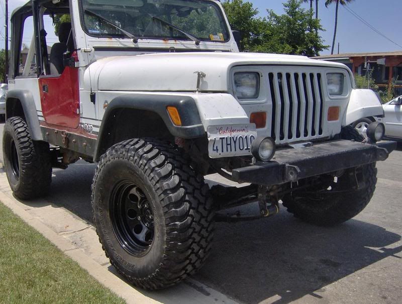

picture below is on 33's, OME springs, 5/8 shackles, 1" body lift, TJ flares.

jbolty, what kind of bumper is that on your Wrangler? I really like the look of it.

Home built bumper, someday I'll get a winch for it. The hooks are from a chevy truck; they bolt right on.
I got my OME stuff from oconee as well. Good guys and the price is about the same anyway. I had them swap out the t-case drop for new u bolts.
I use heavy equipment grease, like for backhoes. Supposed to be less sticky to attract sand and dirt. Just looks like grease to me but it's a cool red color.

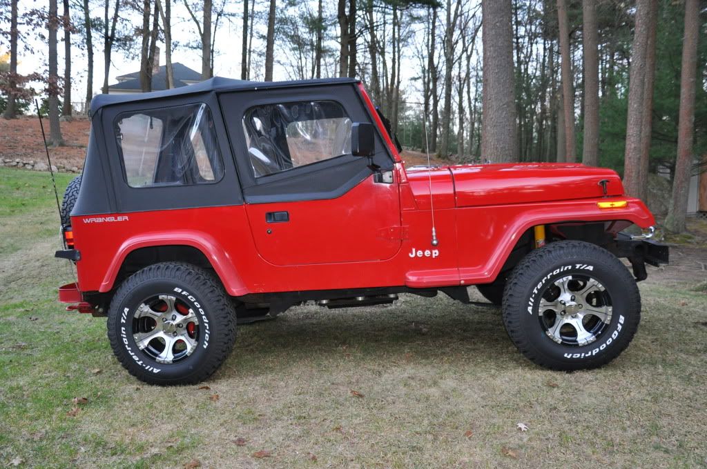

I have the OME lift on mine. I got a whole kit from www.4wd.com. Came with the springs, shocks, bushings, and t-case lowering pucks/bolts. It did not come with the steel sleves that go inside the bushings, so I reused my old ones. I also went to a shop and had some new u-bolts made. I also already had a SYE, so I simply did not install the t-case lowering pucks, and got a set of diffrent angle shims for the rear axle. I'm running a set of 31x10.50 BFG MT's. Stock shackles and no body lift.
Here is aout the only pic I have showing it. I do drive it daily.

Cobra, thanks for the pic. That's exactly what I'm going for. I like the heightened stance that it gives the Jeep; it's just enough, but not too much for what I'm trying to accomplish. I really like the stock look of the YJ and want to keep that integrity as much as possible. Were the differential angle shims completely necessary, or are they more of an option? I've been told by several people that OME designs their lifts to work without any other modifications (with the exception of new u-bolts most of the time), so your installation of the shims is something new to me.

As stated, cut all the bolts you can. Use a couple grinding wheels and buy yourself some new bolts. ~$30 vs. Days of frustration. I ran into some snags with the bolts being hard to get off the shackles. I reused mine, so I didn't want to damage them. If you don't have a lot of space to work with, you will find that you will spend a lot of time maneuvering and preparing to do one bolt only to have to move again. Buy a lot of PB Blaster. Don't waste your time with WD40. It's just not the same on rust.
It took about 3 days. If timed straight, probably about 18-20 hours. (I had a lot of rust)
I ride with 31" BFG MTs just like Cobra Jeep. I get 15 MPG consistently, unless I have to step on it. I run the 2.5L
I'm completely happy with the kit. I like the stance, enjoy the travel in the springs, and more than anything love the ride.
Here are some pictures. Let me know if you want more. I have a ton. This is with a 1" BL.

You will be be very happy with the full OME kit. I installed that along with an OME steering stabilizer. I run 31" BFG A/T's and the setup is awesome. You can't beat the smooth ride. Good luck with the install.
