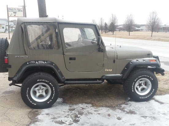

just picked up a 90 wrangler and the guy put it in 4x4 and now i cant get it to go back in 4x4 pull handle back n nothing wont stay there and then theres a knob in dash with red button do i have to turn that to or is that just my locker for the axles ? and can ya tell what size lift i have on this jeep i know theres no body lift it has 33 12.50 15 s on it new-jeep.jpg

Red button sounds like a Posi-lok for the front axle and looks like its a 4"lift with 33's.
