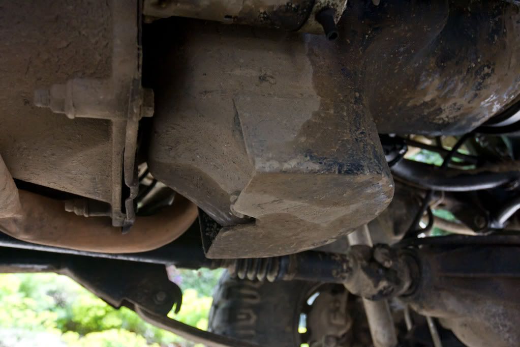

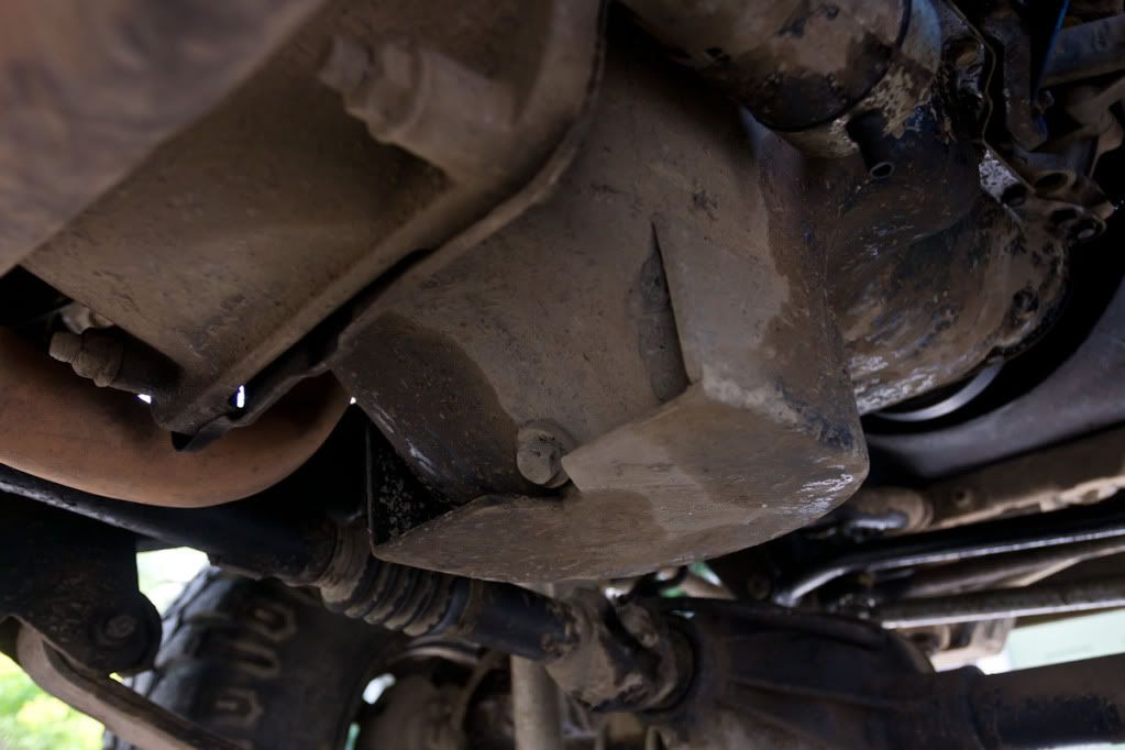

Here's some photos.
It does not go behind the oil pan to hook into the transaxle skid. I have the FabTech plate there. That has a sloped front lip so if you kiss a rock with the oil pan skid, you'll also kiss it with the transaxle lip. Smooth would be nice but I have a 4 cylinder, save weight. Yeah, that must be why, right? :- )

And hey, check out the photo. That was brand spanking new a week ago, looks like it took a rock already. Glad I put it on...

Thanks paint....Looks like it did the job!
