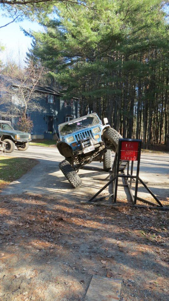

post #10 of 17 Old 12-23-2012, 11:23 AM
'92 vegas YJ
Location: Portsmouth
Posts: 2,618
1990 Chevrolet Truck C1500 1/2 Ton 2WD - Pickup
This is what im running. I like the OEM rubber lines vs. SS lines. look at the passenger line in this pic(you can see it behind the shock). Decently flexed right now and the line hasnt even begun to stretch.
