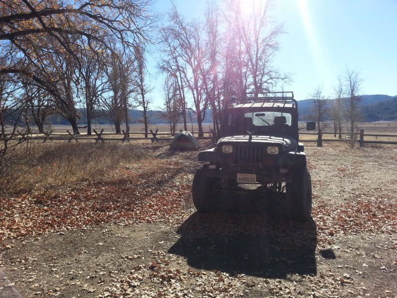

word up JF YJ peeps. I have been busy with work the last month but over the weekend I was able to take the YJ from Forestville where my parents live all the way to San Francisco (About 68 miles). She was running pretty rough. Got her to a mechanic to get the smog done and I'm finding out I didn't do a very good job hooking up the vacuum lines apparently. He is going to take a look and hopefully tomorrow it will be running smoothly.
