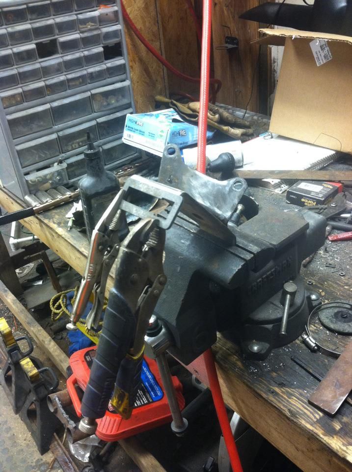

I did the 242 swap mostly because in my area at the time i couldnt find a 231 for less than 300. It bolted right up in my jeep however there are a few things to workout. I did have to install a different shifter gate due to the extra gear and so it is a straight pull back between gears. Also the metal tab that connects the shift linkage to the case i have to modify because when in 4lo the linkage forms a straight line so wont disengage without the help from prying it up with a screw driver. Then since the cherokees didnt have the vacume disconnect i just fitted a posi-lock setup. Only thing i havent gotten to is the speedo. I currently use just my gps for speed and range between fill ups but when i can get ahold a cherokee someone is parting out im gunna try splicing the correct connector into the yj wiring. yes there is less aftermarket support but in my opinion its worth since i deal with alot of transitioning between soft sand and harder trails the 4wd full time is nice.
Here is a pic of the gate i mentioned
