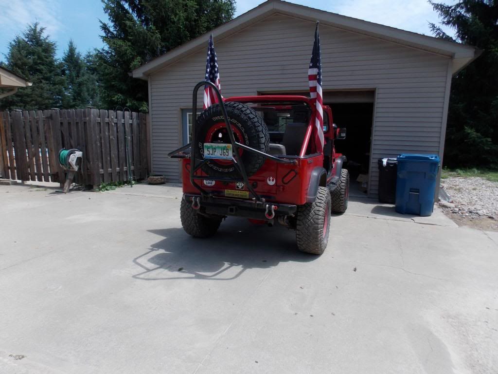

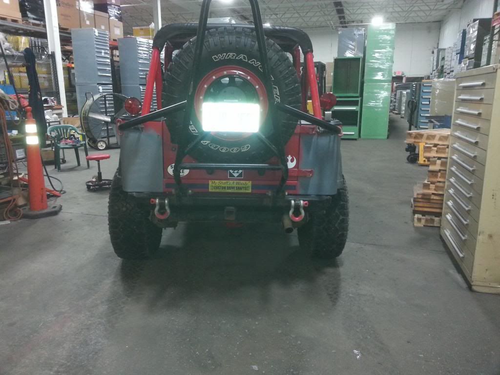

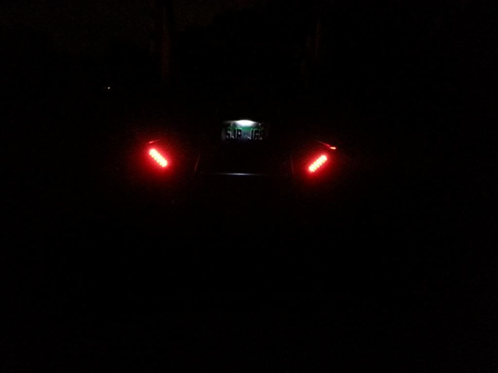

I wanted to do something a little different than the standard 4" round LEDs, this is what I came up with.
Turned into a 4-part project..
Part I: License Plate Relocation
Part II: Gas Filler Relocation (TJ Style)
Part III: Body Work
Part IV: LED Tail Lights
'90 YJ with some stuff

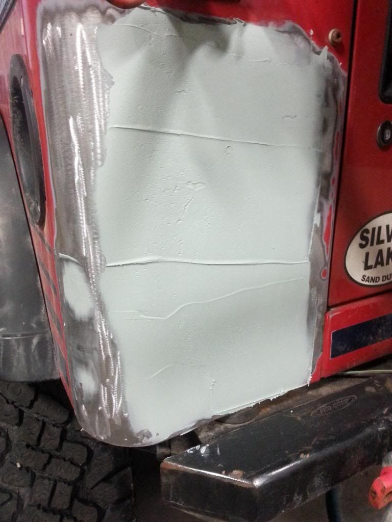

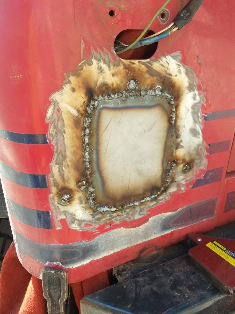

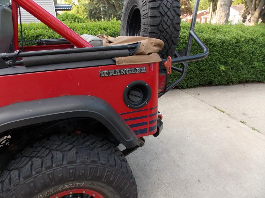

Very nice. I like it. When you did your fuel filler relocation how did you attach the piece of metal where the old filler was?
jsd1991yj is offline
post #5 of 5 Old 06-30-2013, 09:46 PM Thread Starter
JEEP_Nut1218
Location: Houghton
Posts: 797
Thanks!
I filled all the small holes with weld and made pieces that fit the larger holes and welded those in.
