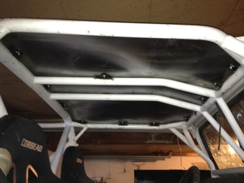

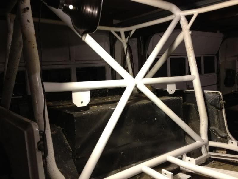

The stock B pillar sport bar will fold easily if its not supported with some cross bracing. It needs triangulation to prevent it from folding. I used the stock bar to work from. Added an astrex looking bars. X with a cross bar. tied it to the frame. You still need A pillar tied to the frame and over head support.

Poke. Looking GOOD!
Whats the easiest way to tie into the frame? Drill a hole in the floor and weld it up?
