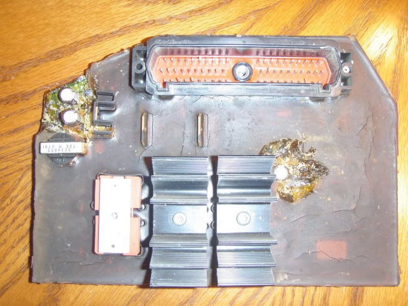

im confused. my ecu doesnt look like any of the others on here that have replaced the caps. not only that, but the caps in mine are two 220uf and one 470uf. so i dont have a clue what ive got? my jeep is a 91 4.0 yj. heres a pic...
because i didnt have the 470uf cap i just plugged the ecu back into my jeep and hooked my ignition coil back up. fuel pump came on, it cranked for a few and was wanting to run but wouldnt idle. when i gave it some gas while cranking it, it would run, but not idle with my foot off the pedal. after about 3 minutes, it finally started to idle. i let it run for about 10 minutes.
so where does that leave me? do you think theres still something that needs to be changed out? (either the caps or the ignition coil) or do you think maybe something was just loose and i snugged it back down when i hooked everything back up?
That is a standard ECU. If your CEL came on when you cycled the key then it wasn't the cap issue. I think you were just not getting the key cycle correct. Look at this and retry it:

By the way, how the heck did you get the gunk off the top of the computer board?
