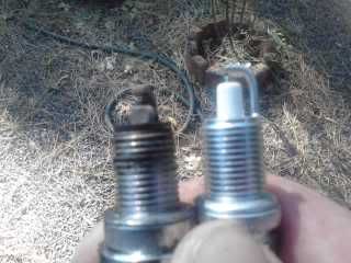

so i know it is not the only problem. but found this today, what do you think. big difference, now on to the carb rebuild!!!!! one on left is ngk one on right is champion both for same model

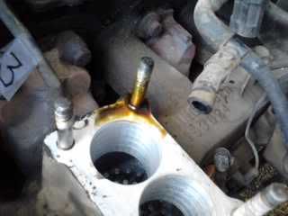

this was in between my gasket and base i think it was leaking
