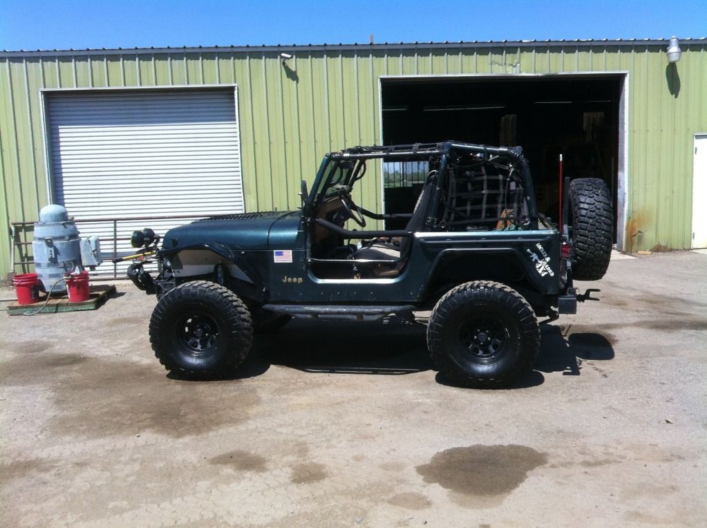

12.5s look great but they hang out of the stock flares so what are the laws about that where you live and is there a state inspection??? Alabama was pretty laid back a few years ago so I would guess it hasn't changed. I went 4" and 33X12.50s and have no issues. So if it is at least possible go for it the look is great.

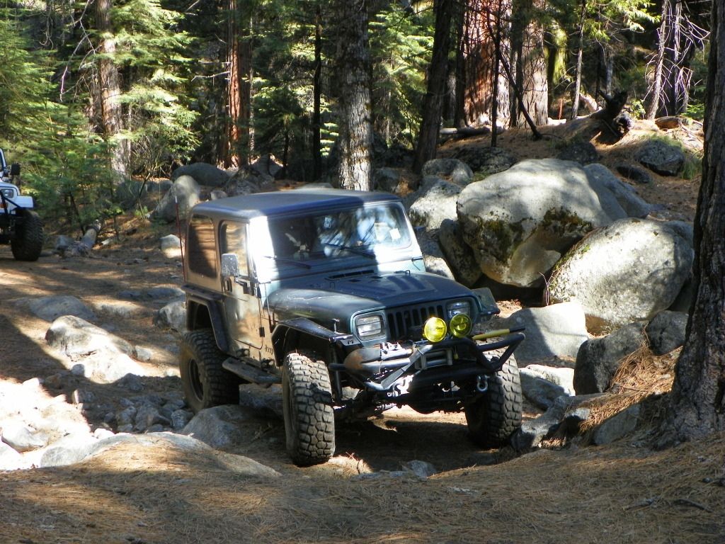

I run both.
I have some 35 12.50's that I run on the street and light rocks
And I have some 36 10.50's that are used for hardcore rocks and mud

Rock guys run both. The most popular tire I run into is a swamper irok 36 1350. I prefer my narrow tires because I can pick a line and have more room to turn midway without blowing my steering box. They also just look meaner.
