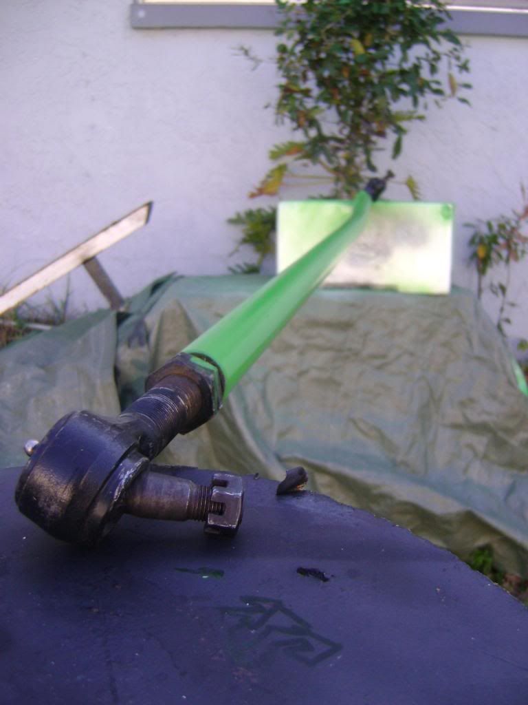

Not sure if anyone cares but here are some pics.
This is the old (Stock) Tie rod with no SS on.
This is the new ProComp SS and my old Stock SS (nether will be used).
This is the (new to me) F-150 Tie rod. As you can see it has a small dent.
-White Jeep Club Member 231-
of course you know that the dent weakens the larger tube to the point that it's probably no stronger than a factory size tie rod that is straight

I apologize, I have LIED. Its not an F-150 Tie rod. Its a aftermarket heavy duty YJ tie rod (I think rugged ridge). I didn't get a chance to instiall it because my drag link was to small. But thankfully my friend also had the drag link so its being painted today.
Im purchasing new grease housings and pins for both bars.
*regurding the dent in the tie rod making it not as strong.. Thats okay. Ive never dented my stock one plus I rarely wheel on rocks. This upgrade is 80% for the appearance. hence the lime green paint.
