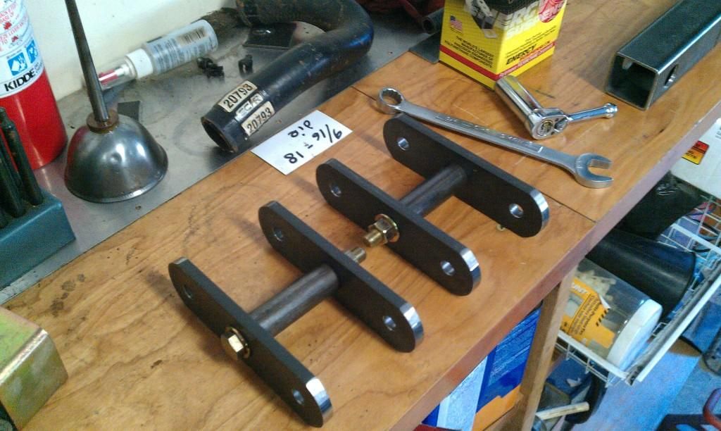

Make your own for $21.
Tom

Stock shackles are 4" between bolt centers. At 4", there is really not much room for the cross braces you see on most after market shackles, and those shown above. The only way to get stronger is buy/make some of thicker metal, but still two pieces per spring. Here is one possibility. I've gotten things from them, good place.

The ones above are 5" shackles made of 3/8 x 2" flat. They can only be used in the front. The rears have no cross braces. Not enough room due to the frame.

perfect thread my front broke and was wondering if I could just make my own.
Question, why did he add center bracing, the originals dont have it.. prolly why they broke but they are also not .375"thk...
Pics of busted shackle
what should look like,

tom_sprecher
Join Date: Dec 2012
Location: Marietta, GA
Posts: 630
Having read some about shackles the center brace stiffens the action of the shackle. Without bracing you get more flex for off-road. With bracing makes the ride stiffer for the street.
You need enough shackle lift to use the braces. At 1/2" of shackle lift my homemade pieces with braces will work on the front, but not on the back. I'm also using greasable bolts with the zerks on the insides because I'm lazy.
Tom
tom_sprecher is offline
post #11 of 18 Old 03-04-2013, 03:54 PM
USMCBuckWild
Location: Sneads Ferry
Posts: 975
The center bar will add stability/rigidity and take some of the stress off of the bolt head and nut that mounts to the bushing in the spring and in the frame. If the bar weren't there and the spring was forced laterally all the spring and axle weight/pressure would be applied directly to the outer bolt head. This way it sandwiches the bushing and helps transfer (share) the load across both plates.

Good answer,
how many of these shackles have busted/broke at the bolt head/nut instead where mine did?

Assuming you made your own 3/8" thick 4" shackle plates, I would think there is enough surface on the front of the front shackle to add maybe a 1.5"+ wide brace, which would not likely hit anything as the front shackle swings forward, and would not hit the frame as the front shackle swings backward. This would improve the on-road safety. In the back, I don't feel the brace is needed at all for safety since the quick forces of steering are only on the front.
