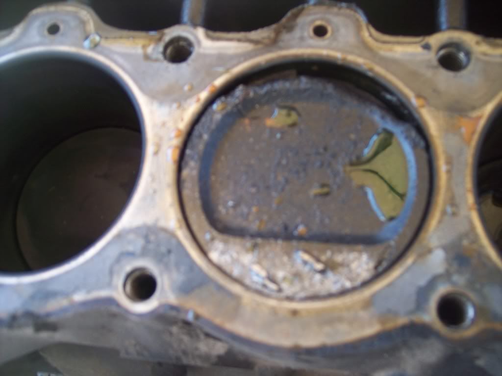

sorry for no updates lately, been real busy. got the old motor tore down and found this
anyways, i got the cam out of the old motor gunna reuse it in my new one, ordered lifters and timing chain kit today. picked up my cylinder hone and a piston ring compressor too. should be putting it all back together by this weekend. o and i had a valve job done on my head so its ready to rock now

There is no way I would go this far and install new lifters on a old cam. It may save you some money today but it will cost you twice as much down the road when your new lifters take a dump because there were put on a old cam.
I have plenty of cam info in my sig.
Looks like you have been detonating, that is the usual damage.
