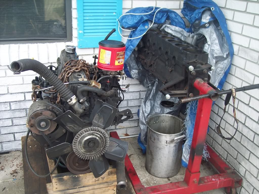

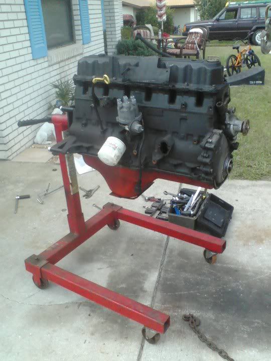

update, i went to discount auto parts today and ordered new rings, rod bearings, and a top end gasket set. 150 bones later it will all be here friday and ill start tearing the motor down. engine will be on the stand this afternoon and i will take pics

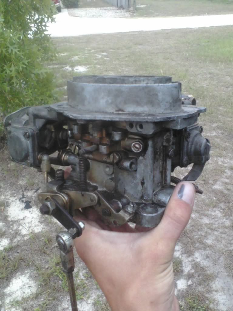

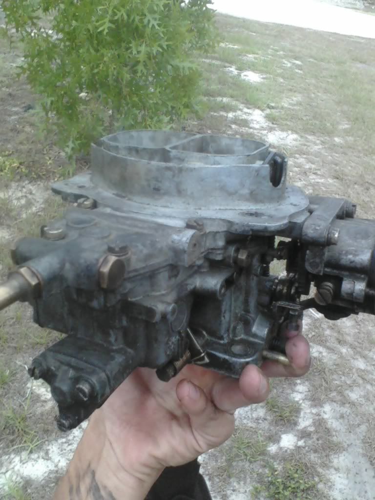

got a carb with the motor. guy said its a webber but i have no rightly clue. can anyone chime in and tell for sure?

Do you have a ball hone to break the glaze in the bores? If not you will be needing one.
That looks like a Weber to me.

I dont have a ball hone but i have a buddy who does thats gunna let me borrow it. after looking at pics i think it is too. just wish i could find out which one it is so i could buy a rebuild kit for it. or do u think id be better off with the holley i have on my other motor?

If the holley is well tuned and you know how to keep it sweet I would keep it and sell the Weber.

love your sig! That looks more like a Holley to me, but if it is a weber, it's stamped. Anything all all pressed in?

thanks! i got it from the you might drive a yj thread! its definetly not a holley, if it is they made too completely different ones about that size, i have a holley here along with another crappy little carb. ive checked up and down this carb and cant seem to find anything stamped in it. got some free time tomorrow and gunna try and clean it up and see if i cant find something.

found a stamp on the carb. 34 dgfc??
That's a Weber.
http://www.quadratec.com/products/51312_57_07.htm

update, tore the motor down today after work. pistons, connecting rods, crankshaft, and cylinder walls all look good. the bad, i have an exhaust valve stuck on my number 3 cylinder, whick bent one of my push rods. so options as of right now. valve job at the local machine shop and complete overhaul on the valvetrain including a new cam and lifters; buy a new head for 260, or do the 4.0 head swap. any ideas?

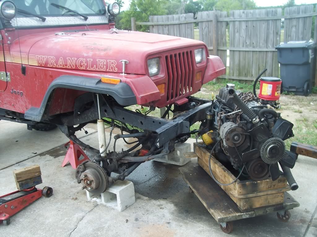

new update. pulled the original motor out of the yj today. tomorrow im gunna break it down for storage and steal a pushrod from it, maybe the cam depending on what it looks like.
pulling the old one
outside the jeep
both of my girls together
