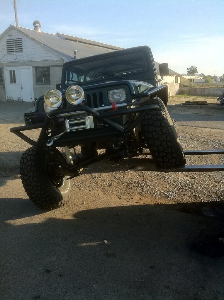

I finally got some time this weekend to start working on getting set number 1 of Metal Cloaks new Yj stretch corners bolted up to my rig.
These corners are designed for those running a 2-4 in stretch in the rear of their YJ and would like a little more room. You cut about 4 inches of metal out at the bottom of the stock wheel well.
Before, the chalk line is roughly where you need to cut
rough cut
scraps
installed with their rub rail
Current

finished photos

I did need to make some modification to the warn sliders to get them to fit. I traced out the rough shape with some soap stone and got to cutting
Ended up with this
