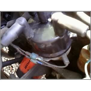

I checked the rotor looks fine and the distributor is turning fine. For some reason I am just not getting a strong enough charge back out of the coil. Someone told me the spark coming back from the coil should be strong enough to jump a inch or so and sound like a knuckle cracking and I dont have nowhere near that heck the only way I can even tell its getting any juice is because of the test light. Autozone says the coil nor the main computer can not be tested. The guy before me cut the plugs off the pickup coil so I had to wire them up manually when I put in the new distributor could that be causeing me such a week spark going to and from the coil? I going to try and post a picture of the wiring.
SOMEONE PLEASE HELP....LOL
