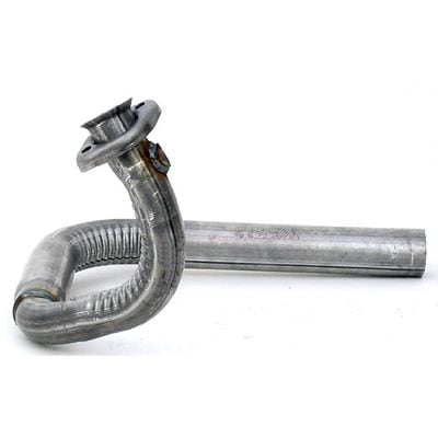

I'm in the middle of this install. I ordered a '99 manifold (Same part # for the '94), a '99 Magnaflow down pipe & Catalytic converter, and an OEM muffler. I went with the Magnaflow because it is mandrel bent and full stainless steel. Here is a link:
http://www.amazon.com/Magnaflow-2322...&vehicleType=6
Install of the manifold went really smoothly, bolted it all up no problem (Thanks to the shop who installed the previous one using anti-seize on the bolts). Went to put on the down pipe and it doesn't fit. Its bent too far such that it won't line up to the manifold without hitting the oil pain. Not to mention the flange bolt holes are too far apart to line up to the studs and it won't reach the studs anyway.
I assume the problems are stemming from the down pipe not being manufactured properly, and not a generic TJ > YJ problem? Anyone who has done this swap care to add their experience?
ETA: Looking at this stock photo on Autozone's website, it looks like the Walker down pipe has a much less shallow bend directly off the manifold than the Magnaflow one I received.
And here's the Magnaflow piece: Notice the might tighter bend.

I used the walker downpipe on my YJ, I bolted right up without issue. I did have to use a few reducers to mate up with the flange that mates to the cat. The pipe clamps leak a little, I would weld the reducers up if I did it over again.

When I did mine, I kept the 4 bolt connector that was stock on my YJ. I just had to weld on the flange to the TJ downpipe.
If yours has the slip style it should work fine. As was mentioned you may need a reducer depending on what size exhaust tubing you have in the Jeep now.
Its a good upgrade, the TJ design is routed much better

Gotcha, sorry didn't see where this was resurrected. I'd guess its mfg error. I used a walker pipe and it bolted right up to a yj manifold and cleared the oil pan with no issues.
