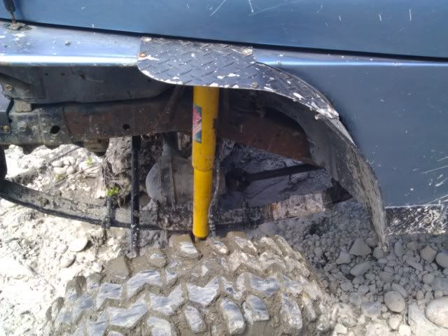

I amde these from some alimium and some old thick rubber truck mudflaps....
best pic I could find, just cut the alumium and bolt it thru the top of the fender, the rubber goes on the backside, and follows the insdie of hte fender.... couple screw to hold it and your good...
the rubber bends nicely if I catch something and the metal on top is nice and strong, no problems after 4 years of running them... will get replaced with some metal cloaks some day but for now it keeps the police off me
those are 3.5" extensions... 6" may look goofy but if it keeps the locals happy!!
a truck flap is about 8" wide so trim it up and good to go.... any autoparts store will sell thick truck mudflaps.....
