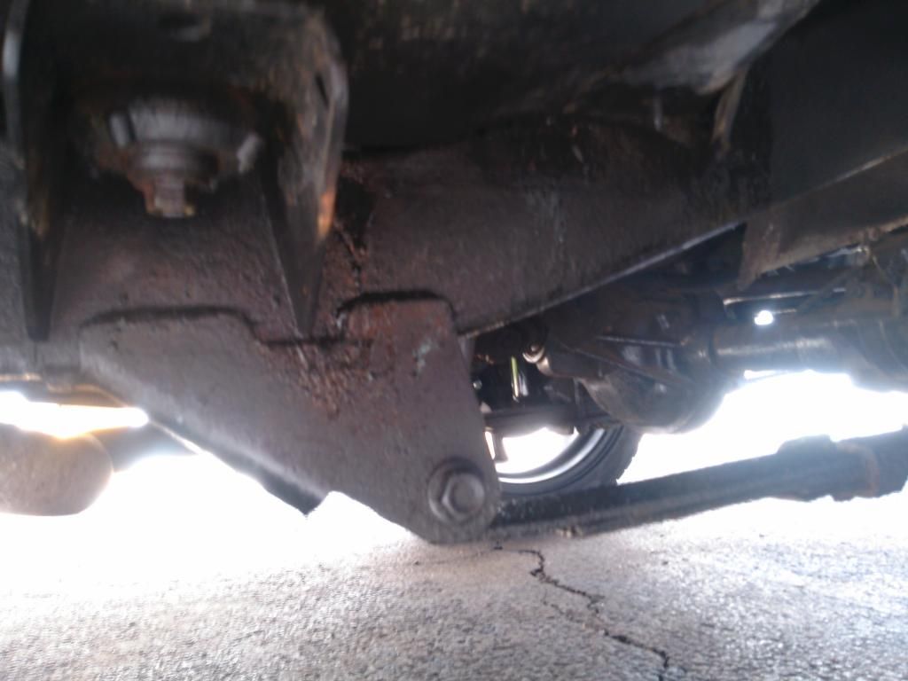

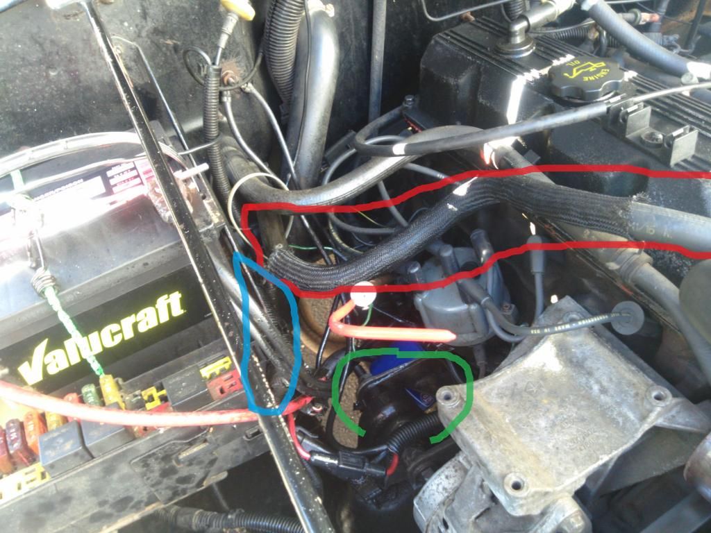

Hello, today I took the jeep out on the road for the first time and I noticed that there is an oil leak near the passenger side. I noticed it was dripping from the leaf spring on the passenger's side and that it there was oil on the base of the battery as well and the surrounding areas as well. There was one hose that had a good amount of oil on it and it is circled in red. What can the oil leak be from? This jeep is just headaches on top of headaches. help is much appreciated.

That is a heater hose and about the only thing that would be leaking in that area would be coolant. Its fairly common to leak from the bottom of where that hose goes into the fire wall.
From the looks of it,(mesh sock, spring clamps) its the original hose from 1991. Time to change them out and clean off the drippings. NAPA carries those hoses with the "s" curves in them.

Well the valve cover is nice and dry so I doubt the leak is coming from there and I am sure it is oil because of the color and smell. I also noted that there was a little pool of oil by the base of the dipstick. Is that a possible location? I also noticed that there was some blow by after seeing mist come out of the dipstick tube. I added Engine repair by Bar's to correct that. I have yet to clean the pcv valve.

There are only so many places it can be comming from... Its in your battery tray and really high up on that coolant hose and I see RTV splooging out of your valve cover all over the place which tells me that it wasn't a real gasket.
