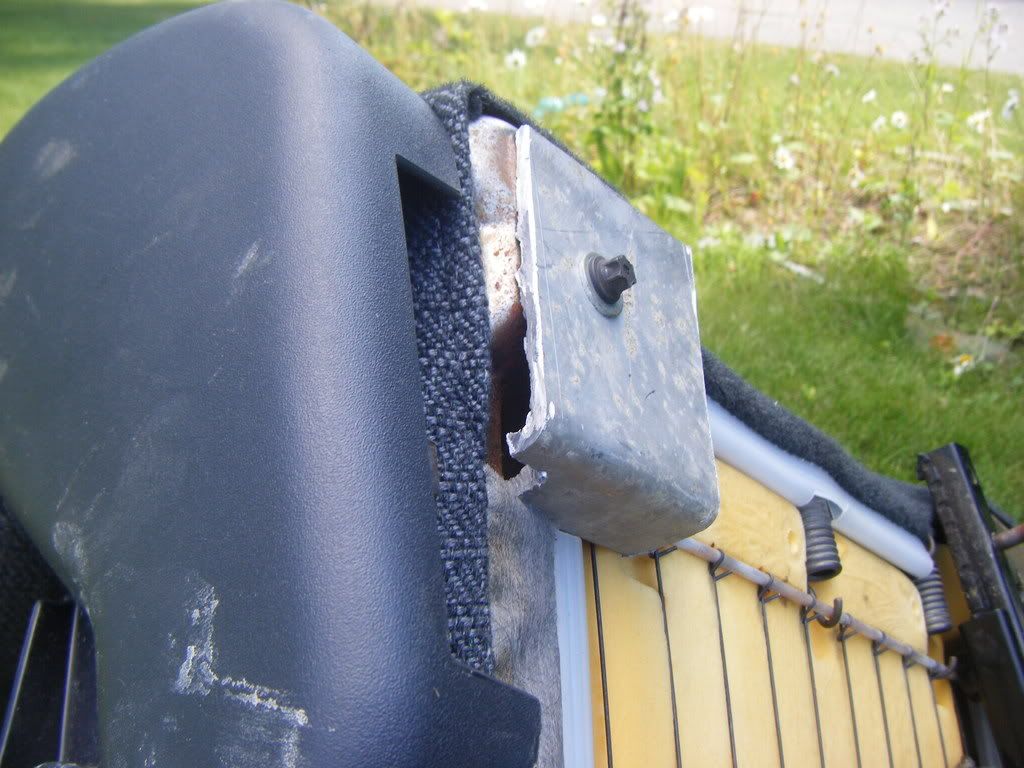

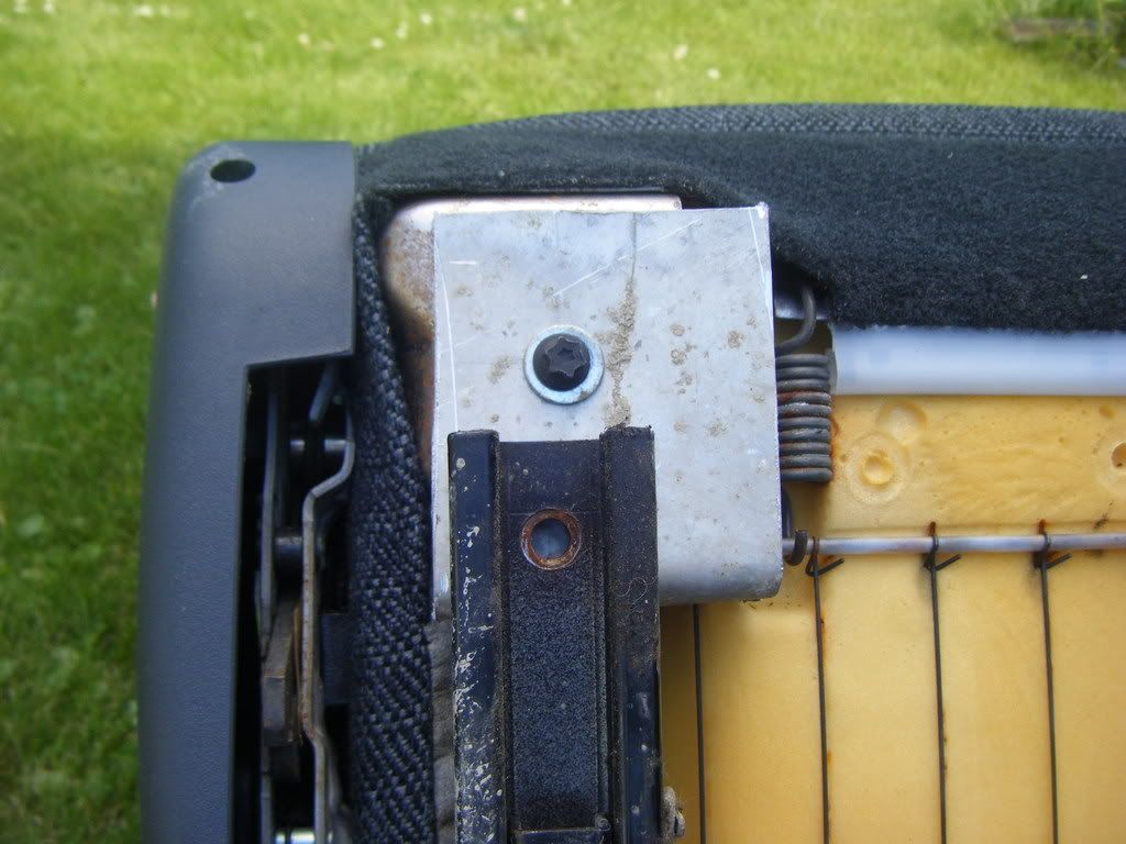

I bolted a pair of pontiac seats into my jeep out of a 2 door sunfire. They where not direct bolt in, I had to make an adapter out of angle Iron, it took about 5 minutes per seat to make the bracket. Basically you have to relocate either the front 2 or rear 2 mounting holes. It was REALLY easy, if you can use a hacksaw (or sawsall) and a drill, you should have no trouble.
It is by far the BEST upgrade I have done, and I wonder why I didn't do it sooner.

I did my 90 from same a coupe sunfire....
It was same, some angle iron is needed, why not flat steel....you will see why when you get them out and line it up, I was lucky and had a chunk laying around so all needed was cut to size but ya, not mcuh to it really......
like the other guy said took maybe 5 mins, took longer to find the damn piece of steel...
one thing of note, I used about 3-5 washers uner the REAR of each seat between the floor and the riser, the cavi seat slopes back alot, naturally it sits lower to the floor in the car so the slope is needed, the washers made it more comfy on the legs.

That's exactly what I had to do. I had a couple of chunks of 4x4x1/4 sitting around and used those. two bolts in the seat bracket then from the new metal to the seat riser. They tumble and slide back and forth just like stock. I moved mine a little off center towards the middle so there was room for the back to recline past the roll bar.
