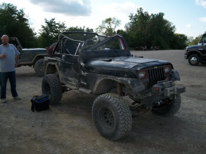

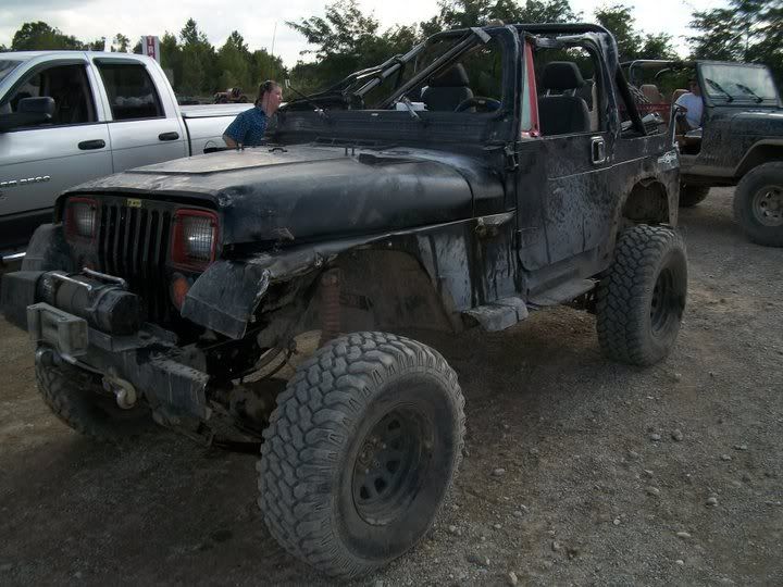

After my buddy rolled over this weekend I decided to get a cage. His rear cage held up well but the windshield collapsed almost into the seat. I am looking for one that adds onto the stock cage that goes completely to the floor. Anyone have any experience rolling one of these types of cages?

We were climbing a very steep hill that had concrete poured on it to prevent erosion. I went right up it and waited at the top for him. I couldn't see him but I heard the tires break loose and then hop sideways and then a couple of thuds. We got out and saw him laying upside down near the bottom of the hill. He was a little banged up but ok.
It caught on fire when I rolled it onto its side because the fuel line had been knocked loose and then the battery grounded out. He had a couple of small fire extinguishers that knocked down most of the flames. We used wet sand to put the rest of it out.
