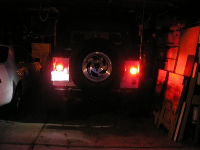

Yesterday I went looking for these lights, and I could only find the passenger side. But I did find a kit at Kragen for about $60. Both lamps are in there, plus a bunch of wire and a cheapo license plate bracket for mounting on a trailer. The wire at least I can use elsewhere. The package looks like this, and I took a closeup of the part number.
I wired it up and cut it just like Cobra Jeep did, except I pulled some wire into the lamp and used the crimp connectors that they provided. Then I used RTV to hold them in place. Of course then I had to get the Stant EL-12 flasher afterwards. Man they work good. I especially like the License plate light.

Just for comparison, here is my setup using the stock-style LED lights. These have LED reverse lights and plate LED lights as well.
These I got from Pep Boys, $60 a piece. Nice job, Cobra Jeep, got the same look as I have, but for alot cheaper,
