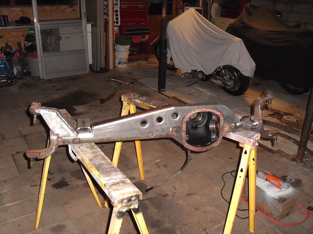

post #30 of 43 Old 05-14-2010, 08:45 PM Thread Starter
CoverinEarth
Location: Erie, PA
Posts: 216
Well some lazy-a$$ stopped over to help today:
Got a little welding done:
Tubes are both sleeved:
And a little mock-up shot of what the finished product will look like:
The lower inner-c gussets still need to be finished being cut out, the uppers are done, just gotta weld up the driver side one.
Lots of grinding and welding left to do, still need to weld the perches and that sexy Ballistic Fab truss as well.
-Nick
