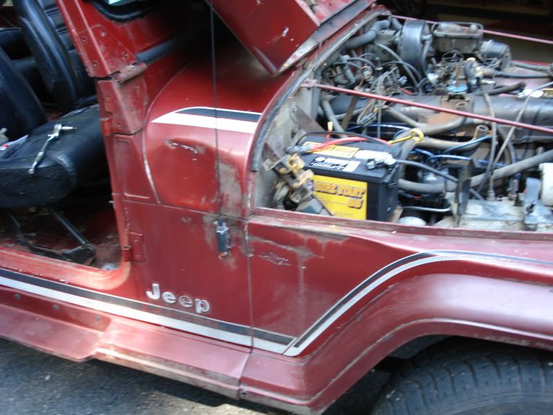

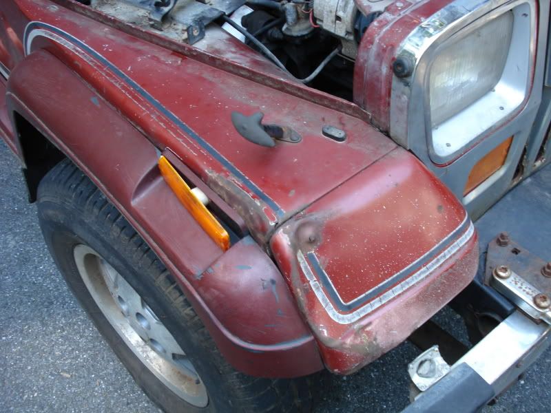

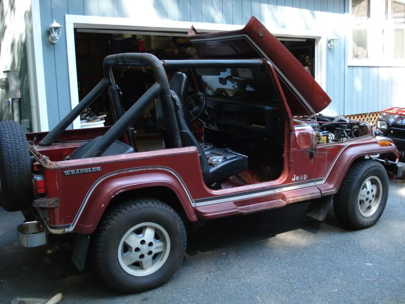

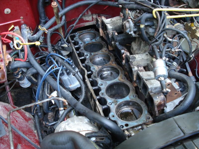

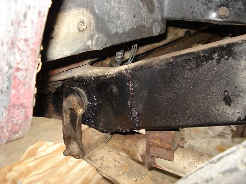

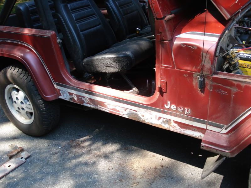

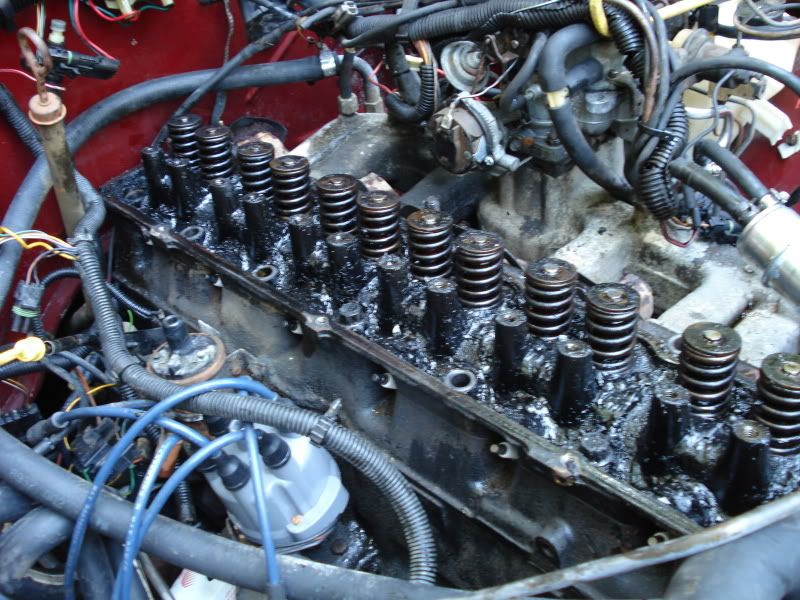

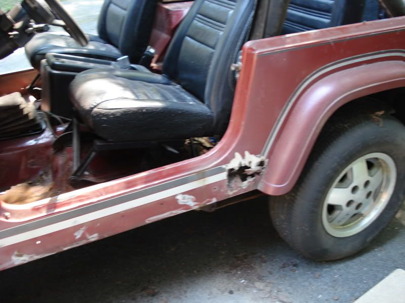

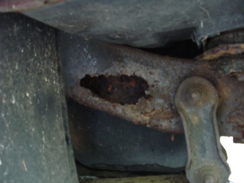

I am I almost finished with round one of my Yj build. My son and I have had a blast fixing this old jeep up. I picked it up for $400 from a cop friend of mine, he realized it was way out of his league. I came out of Alaska and had been sitting in Maryland for 4 years. If it sat any longer there would have been no saving the jeep. It has the 4.2 and tf999 auto. The jeep ran and drove when I picked it up but barely. The motor was seriously sludged up and an intake valve on #5 Stuck open.
Here it is when I got it home. I ripped the hardtop and full doors off I quickly had the jeep torn apart. You can see what I found:

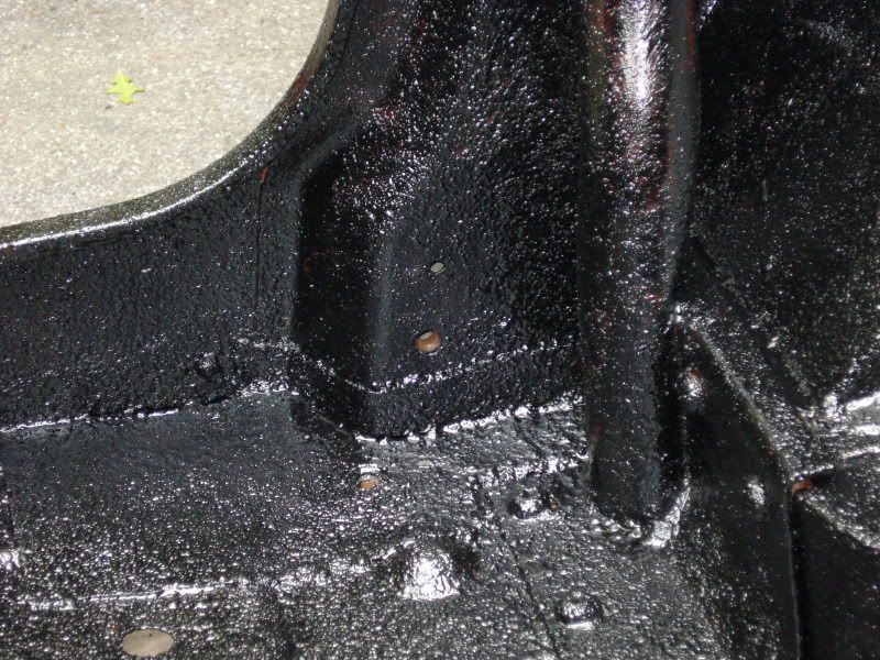

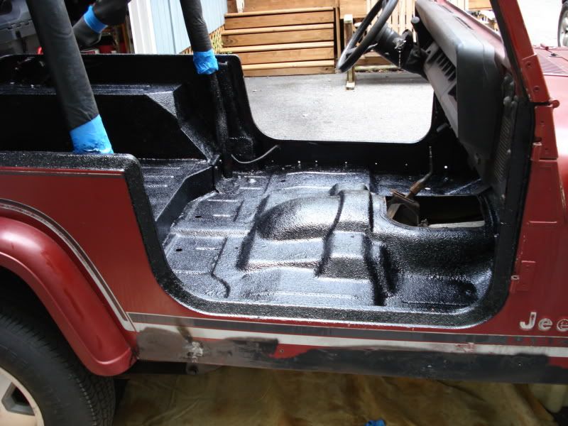

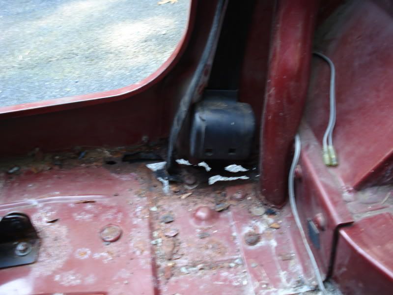

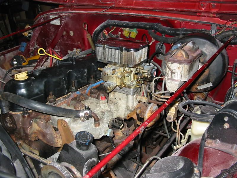

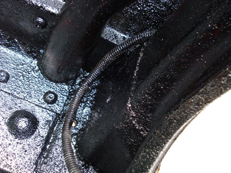

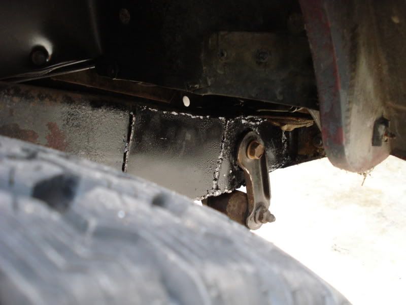

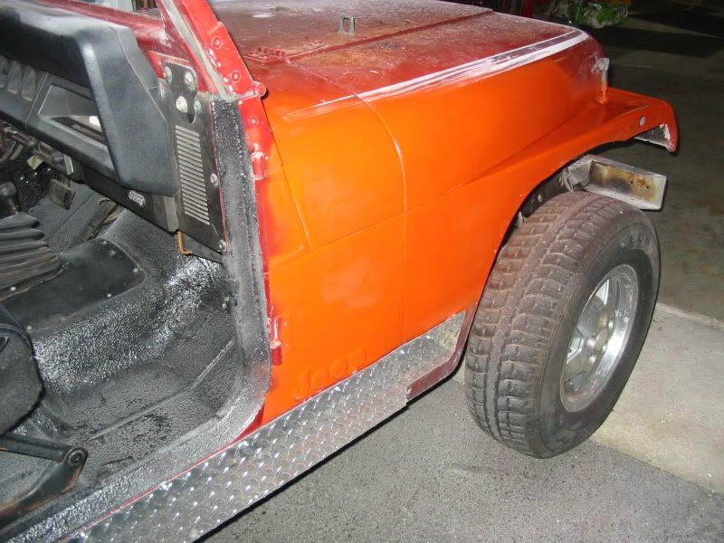

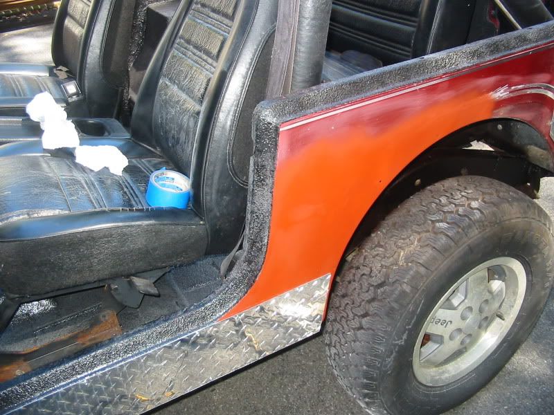

I began to repair the frame and tub. I used a buddies plasma cutter and cut the bad pieces out and welded in new metal. The frame is soild for now but I am sure in a few years I will have to some serious work. The dents were the worst part. I hammered and dollied them back into shape. I also had to rebuild front seat belt mounts. I prepped the floors and put 3 coats of herculiner. I carried the herculiner around to the body seam. I also ordered some diamond plate to cover some of the bad stuff:

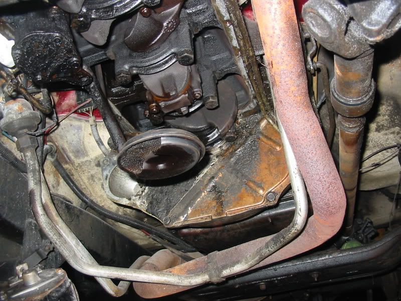

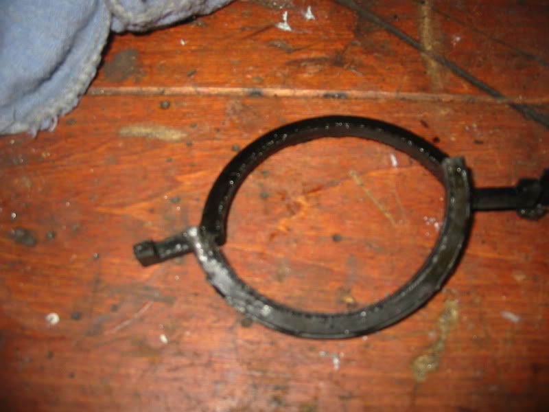

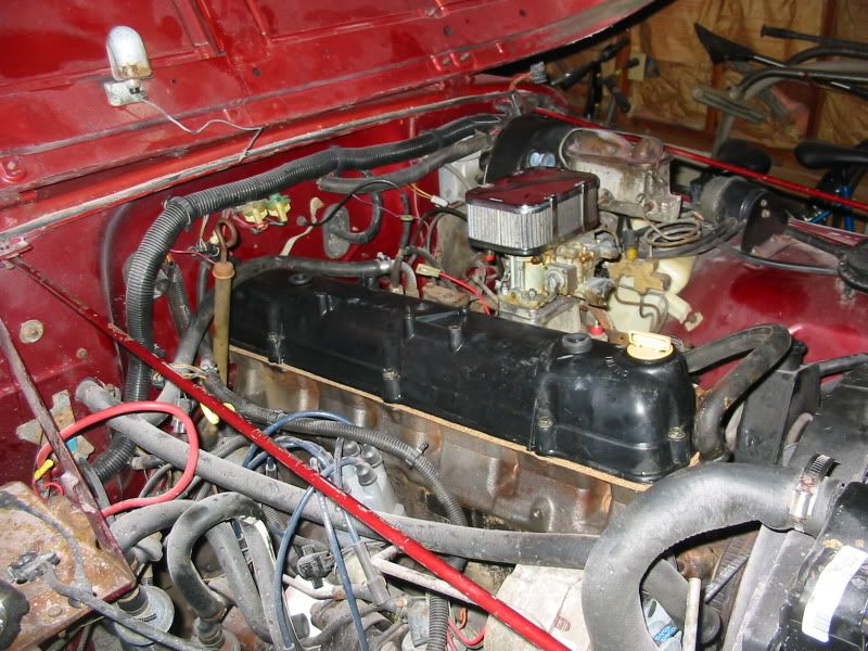

I drained the oil and filled the base with 2.5 gallons of kerosene. It sat for 2 weeks. I found the rear main leaked. So off came the oil pan. The main bearings look new. Now signs of brass. I also picked up a light bar and Weber carb, both were $150:

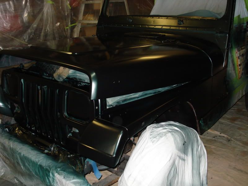

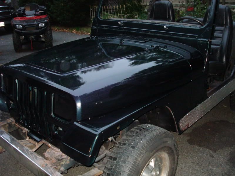

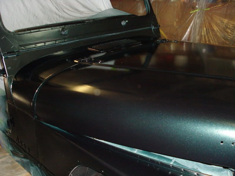

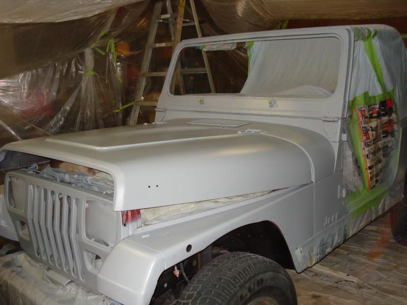

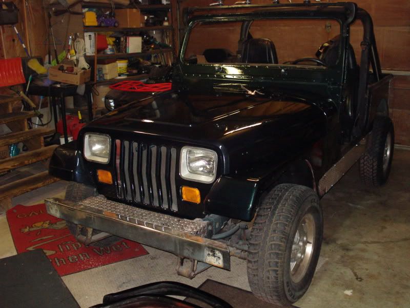

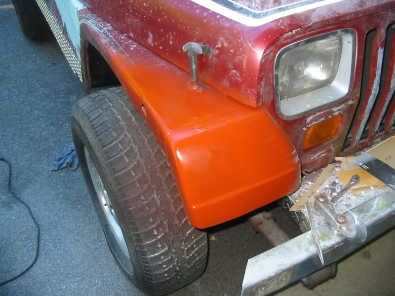

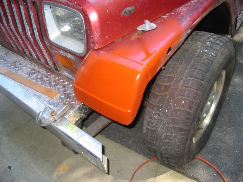

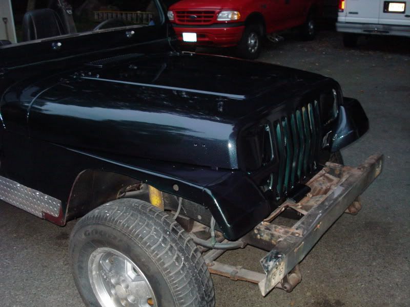

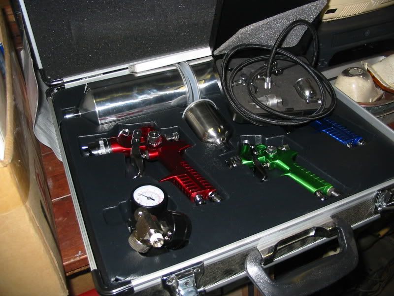

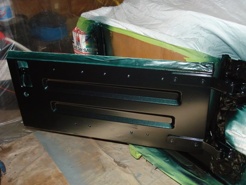

Now for paint. I decided on a dark metalliac green. I had an excuse to use my new cheap paint gun set. I turned my dads garage into a paint booth. It work well. I also sanded the old flares and painted the satin black:
The ghost flames are Hot Hues voilet pearl. They look blue against the green paint. I also added a slight amount of pearl to the first coat of clear. THe paint turned out real smooth. I think the only wet sanding I will do is the hood. Tomorrow I finish putting the Jeep back together. I will get some good daylight pics. I still have to do the Nutter mod and get the motor running.

Thanks guys. I don't know if I work quick or am just impatient. My main goal was to stop the rust. I am sure it will always be a constant battle. THe fun part for me was beating the front fenders back into shape. I never used a hammer and dolley before. I work on cars for a living so doing the body and paint work was a great change of pace. I am usually working under the hood not on the body. I will get some good sunlight pics tomorrow with the flares back on. I am waiting on a skid plate for the gas tank and the linkage for the Weber carb.
