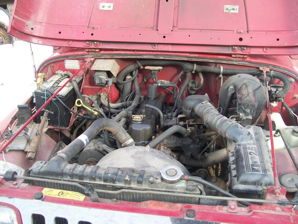

What a bummer today, did not enjoy this ride at all, talk about slow, on my way in I actually did hit 5th gear but going slightly downgrade, on my way home I never left 4th, seems like I have to mash the pedal to the floor to get this thing to move, Come on! my 80 CJ with the 2.5 has more pep than this and that's running 31s and 3.54 gearing. Something must be seriously wrong, this engine idles ok and seems to run good has 115k miles on it, there are no noises. I filled up the tank and then I discovered some cracked vac hoses when I got home and have replaced them, i guess I will see what tomorrow brings. It does ride down the road nice and straight, does not wander nor sway, I was surprised with the amount of play in the box. I fixed some cluster lights that were out and cleaned the dash a bit, I also removed the stainless dash trim, I like it better without, didnt take any after pictures today. Also my steering column lower bearing came today but I didn't install it yet, maybe this weekend...

so I have found and fixed some more vac leaks, it seems someone replaced one behind the motor with an oversize hose that was not a tight fit and hence was leaking, it runs so much better now, i have gone thru all the vac hoses and replaced most of them, the 4wd light is still on though, not sure what to check next on that, funny thing is it wasn't on until I started fixing vac leaks. I also removed the lightbar to cut down on drag as suggested but i will be taking the rectangular lights off of it and mounting them to the front bumper ends on some offset brackets so they sit behind the bumper profile, will post some pics when I get that done. I am also going to do something with the stereo, it's not wired in properly and when I shut the key off and then back on it starts to play the CD from the beginning, I also need some speakers, it just has the two stockers up front and they sound like crap, has wires running to the back behind the seat but there is nothing hooked to them.

Did you happen to take pictures regarding the vacuum hoses replaced? As in which ones you replaced and where they are located? I always get the feeling my 93 should have more power than it does even though its a 2.5. I've been meaning to check all the vacuum lines too but I don't even know where to start.

I replaced pretty much all the vac hoses, there were a few that looked like they had been replaced not long ago and were nice and tight, i did one at a time so there is no chance of screwing up
