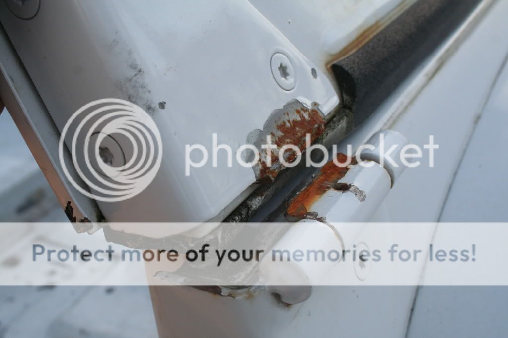

Oh and this which is friggin awesome oh and all the friggin torx bolts are like stripping or breaking so I'm going to have to like drill out a ton of them and then re tap or clean up the threads and then go to allen heads.
Haha the first time I folded down my windshield, the passenger side hinge snapped just like that.
did you fork out the money for new ones or weld it? I'm thinking about welding it and then sending all my hinges off to be powder coated

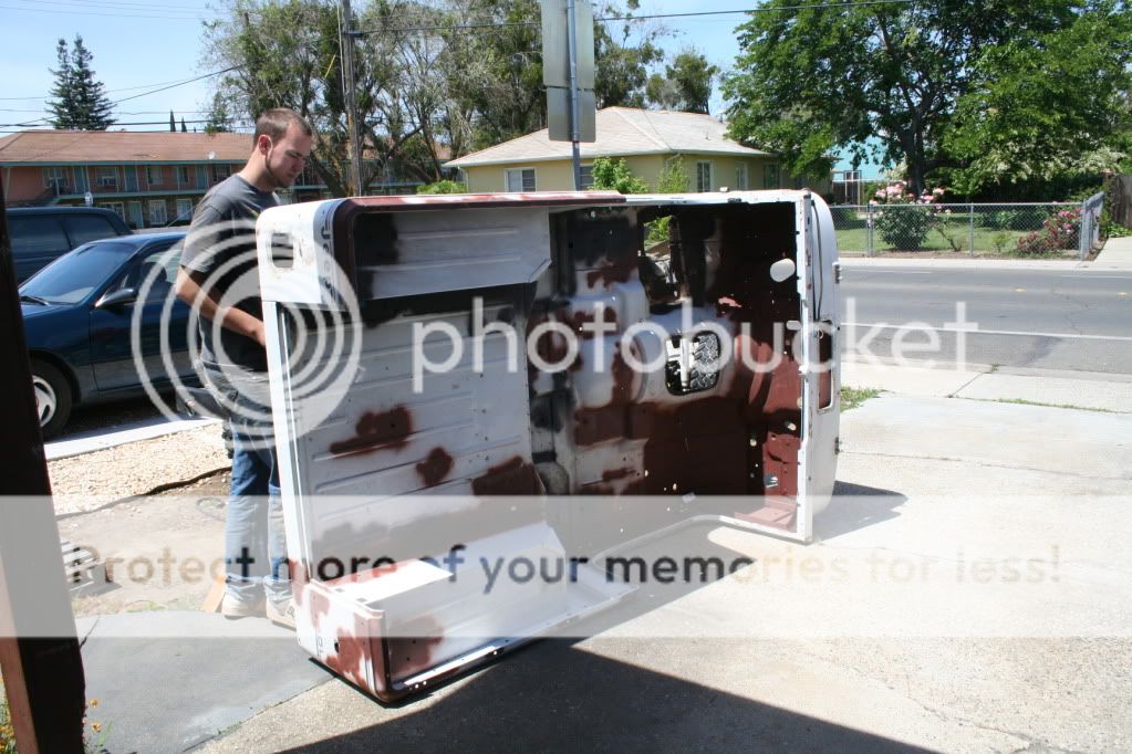

So first off I pulled the tub off everyone I know was busy so I got it most of the way off and then my mom helped me and I got it off completely... first picture of the day...All the red you see in the picture are areas I have already removed surface rust....

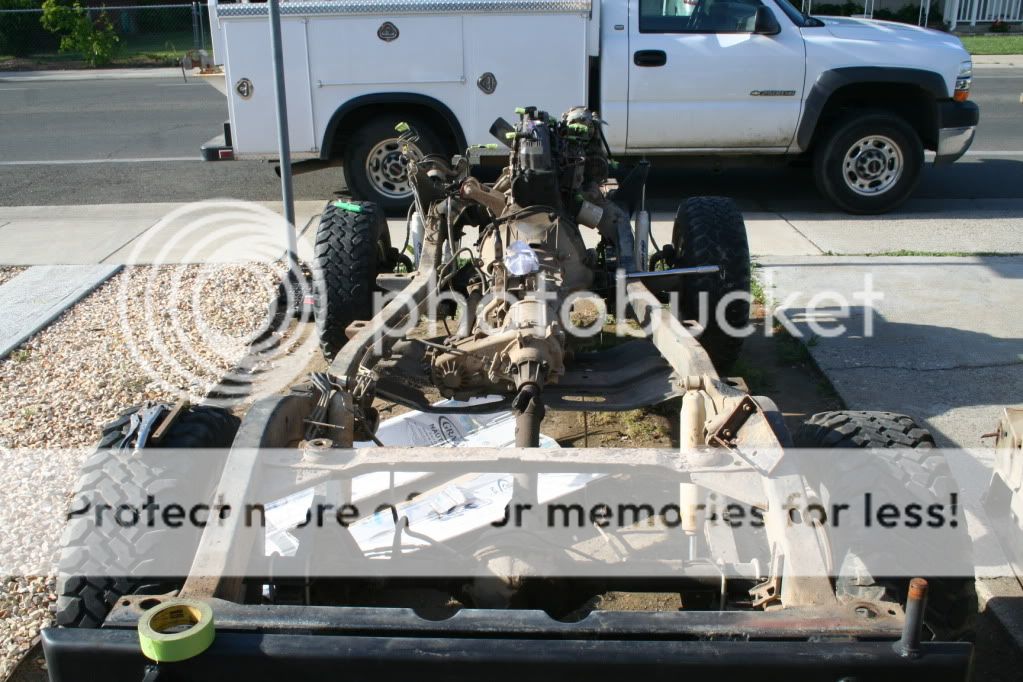

Then Once I got the tub removed I started removing stuff from the frame and the gas tank......The frame is being removed ground down and por 15-ed so it has to be completely stripped this wasn't in the original plan but dang if I'm this far into it mise as well...

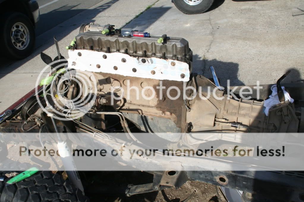

Then I ran into a couple of snags. I don't know how to remove the brake cables....The wrenches are just stripping the bolts so I think I'm doing something wrong.... Anyways I moved onto the rest of the engine I can pull.... I'll be posting up some questions rite after this post in tech to help with the rest of the engine pulling which I hope to do tomorrow..The piece of cardboard is to kind of keep crap out of the ports

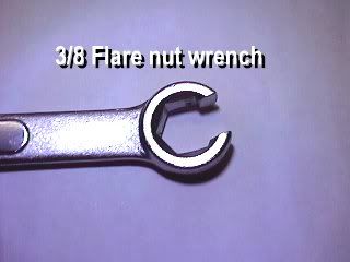

You'll need a flare nut wrench to get off the brake line fittings.

No, it's just a different style of wrench. Not sure on the size.
They look like this:

okay yea I remembered what they look like rite as soon as I seen a pic just didn't know they were called that or thats what they were for I guess they apply more even pressure around the whole nut
