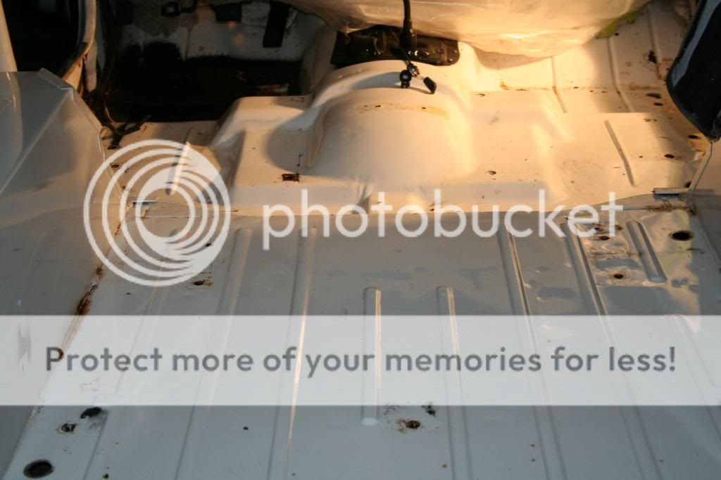

There's a lot more crap in there than you'd think huh..... I mean when you're taking it all out to line it...
Originally Posted by Goobersbro View Post
hmmm P.O didn't mention this when he was telling me how great the jeep was
Exactly why I hate carpet in a Jeep.
So are you just putting tubes up front and leaving the stock flares in the back? You building the tubes or ????
No I am building tubes for all around probably won't happen till like January but who knows the steel isn't all that much. The flairs are comming off tomorrow though

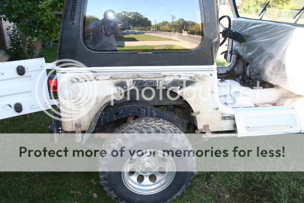

Back rear fender removed.
Passenger side
Moved to the drivers side and found this under the driver front fender. I like that its rite next to the jeep emblem its perfect jeep +rust

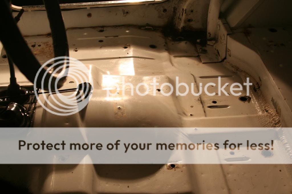

After removing all the fenders I simple greened the inside and got it cleaned real good so I can start seeing areas I need to tackle
And the tool of the day award goes to the grinder
