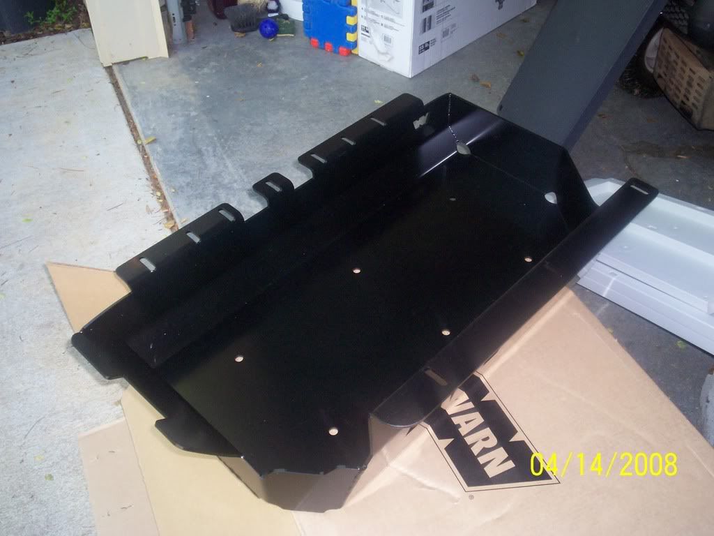

You gotta love coming home and seeing this
This thing looks a lot better than the stock one
Now what sucks is i get to walk buy it everyday this week until Saturday, maybe Sunday. I have school and work this week and then i am going to the beach to see my g/f. I am coming back Saturday so maybe i will do it then, It seems pretty simple to put in.

Alright, got around to installing the skid plate, pretty simple install
1. Supported the axle with jack stands and the skid with a jack(my dad's fathers day gift) and a peice of wood
2. Then took the bolts off and lowered it enough to unhook the vaper lines, electrical connection, and hoses.
3. Then lowered and swaped the old skid for the new one, all you need from the stock one is support straps.
4. Then put it back up, connect everything and bolt it up.
Pretty simple only took about an hour and did most of it by myself.
