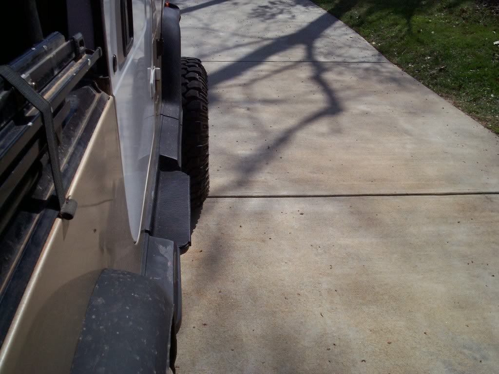

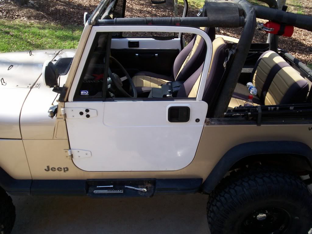

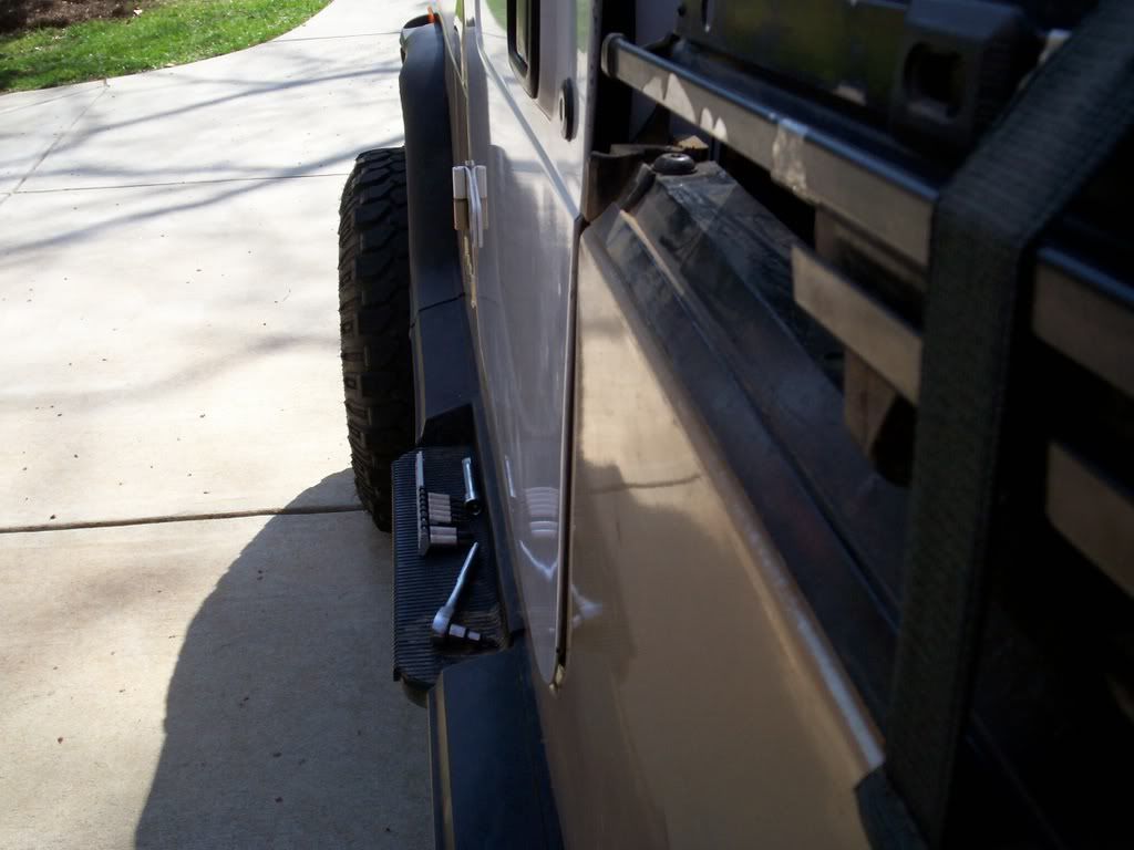

So drove up to southpoint with nothing on the jeep and came back with these,
The only problem I have is a gap at the bottom of the drivers side door, hard to tell with the pics but noticable in person. I am searching for a good write up but if you have any pointers to help me out that would be great.
no gap
gap
no gap
gap
I hate recommend this but it worked for me. I had a junkyard hard door that was the same way. Come to find out it was a bit twisted. I fixed it by first rolling down the window. Then grabbing the lower corner of the door with one hand on the upper part of the lower half of the door (you know what I am trying to say, not the top window channel) and giving a good tweak on the lower portion.
