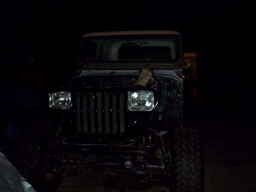

The temp gauge isnt working now, but the t-stat is opening and all is well. Im probably gonna get a cheap mechanical gauge set because i dont trust the electric ones anyway. I just ordered the correct shims for the rear so hopefully i'll have em by the end of the week. I got a few pictures but it was dark so they kinda suck.

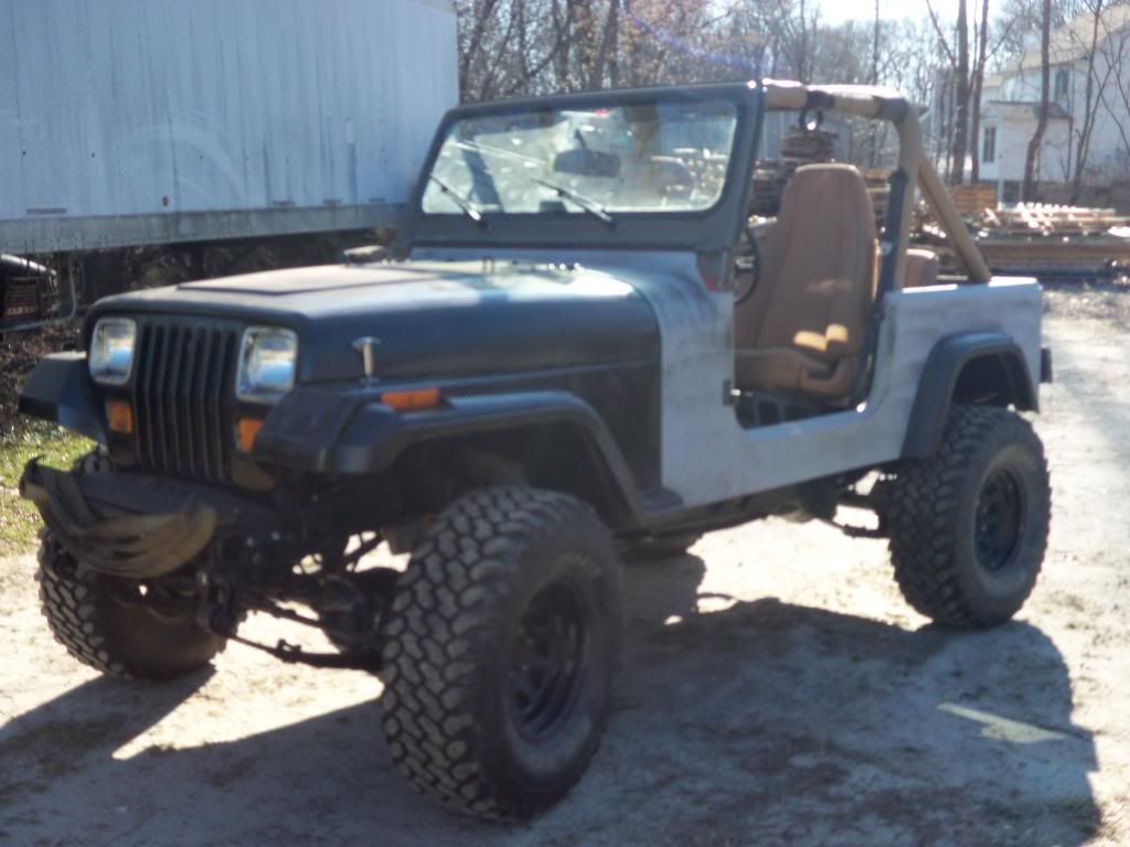

on friday night i got the roll bar fitting right. the older style bar didnt quite line up right in the 95 tub. i just egged out the holes a bit. saterday i welded the bar in, herculined the floor, put the seats back in. pretty much finished up just about everything. this morning i changed u joints in the rear shaft and painted it and put it in. then bled the brakes and took it for a ride up and down the driveway a few times, I havent got my shocks yet. hopefully tomarrow or tues. i need to get insurance back on it too.

the build is gonna slow down a bit till spring, but I should have the tube fenders done by the end of next month. Its driveable now and I cant spend any more money on it right now. after Christmas I will buy bumpers for it and make my spare tire mount that will take the place of the rear seat. hopefully spring comes quick, I want to paint this thing

drove it home tonight!! happy b-day to me lol. installed the shocks this morning.
