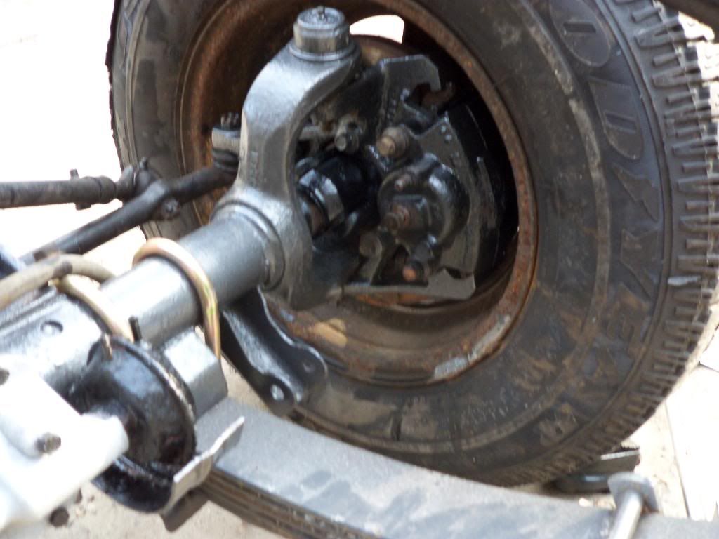

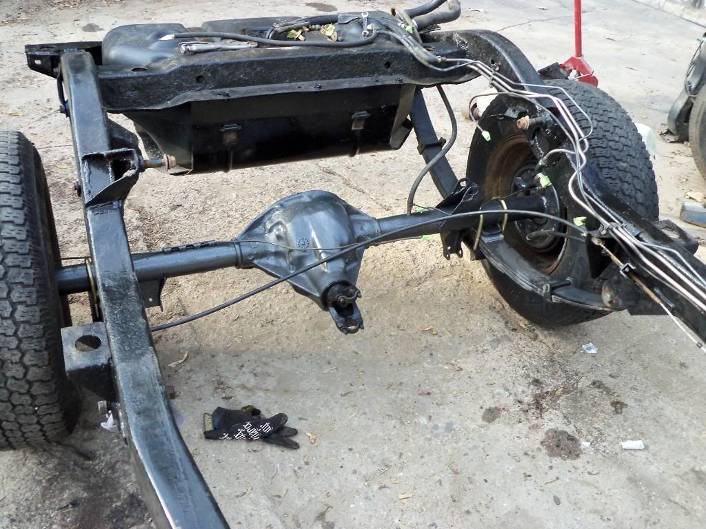

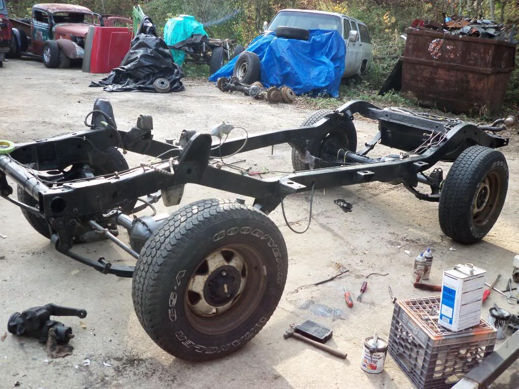

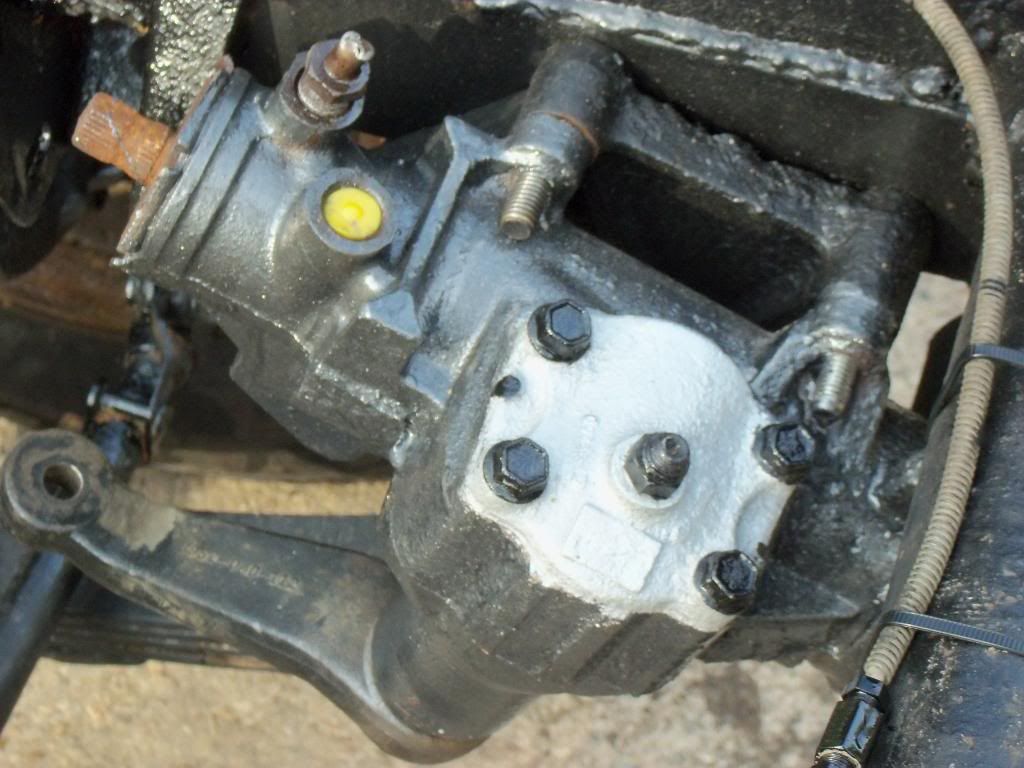

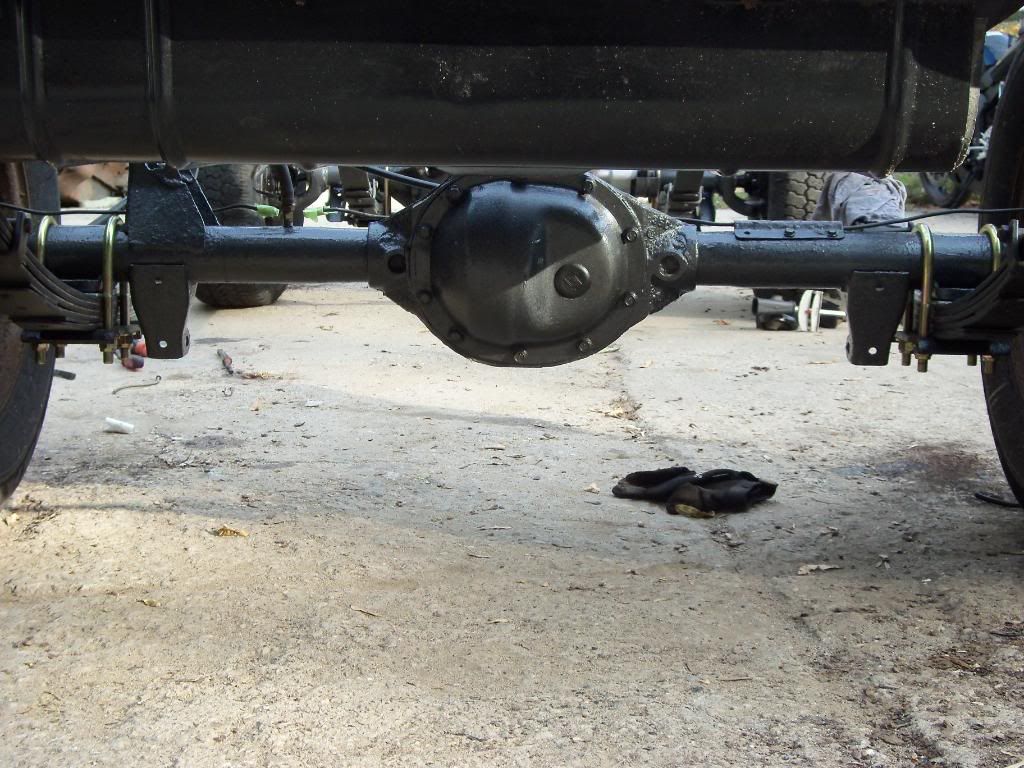

well i didnt get the motor cleaned yet, but i did get my frame rolling again !!! im very happy with the lift, i was happy with the height before, but the rear springs were broke so i just went with the 3.5.i cleaned and painted the axles(i think they look good) i got the gas tank installed and the lines and whatnot. replaced the rear ebrake cables. i found out that im gonna need bigger shackles for the bds springs, the military wrap doesnt leave much room(kinda knew that already) but it should be alright for now. i think i might be getting a little carried away with this thing, after all its just supposed to be a winter beater oh well it'll be nice.
i put the other steering box in because my old one had a stripped bolt hole. i cleaned this one and painted it up.

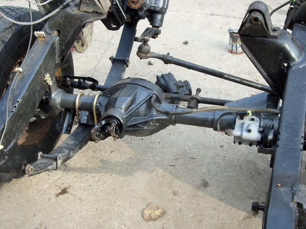

front axle
rear axle

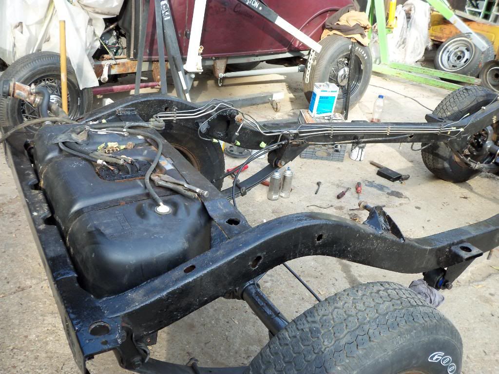

gas tank and lines

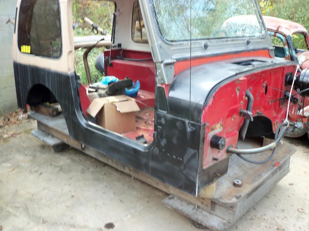

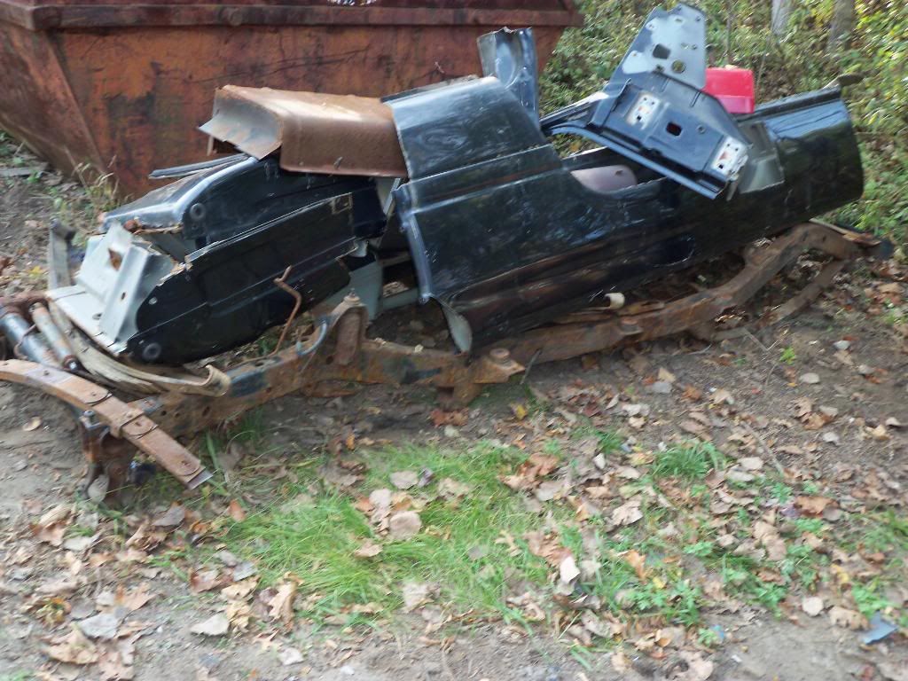

the parts jeep frame is under there, ready for that mess to get hauled away

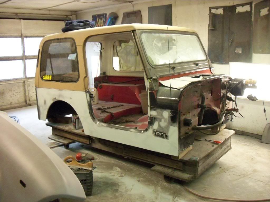

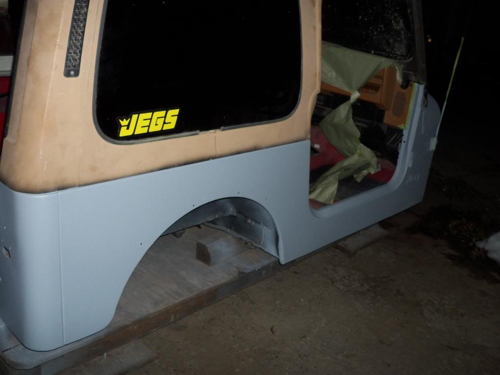

bodywork all done on tub

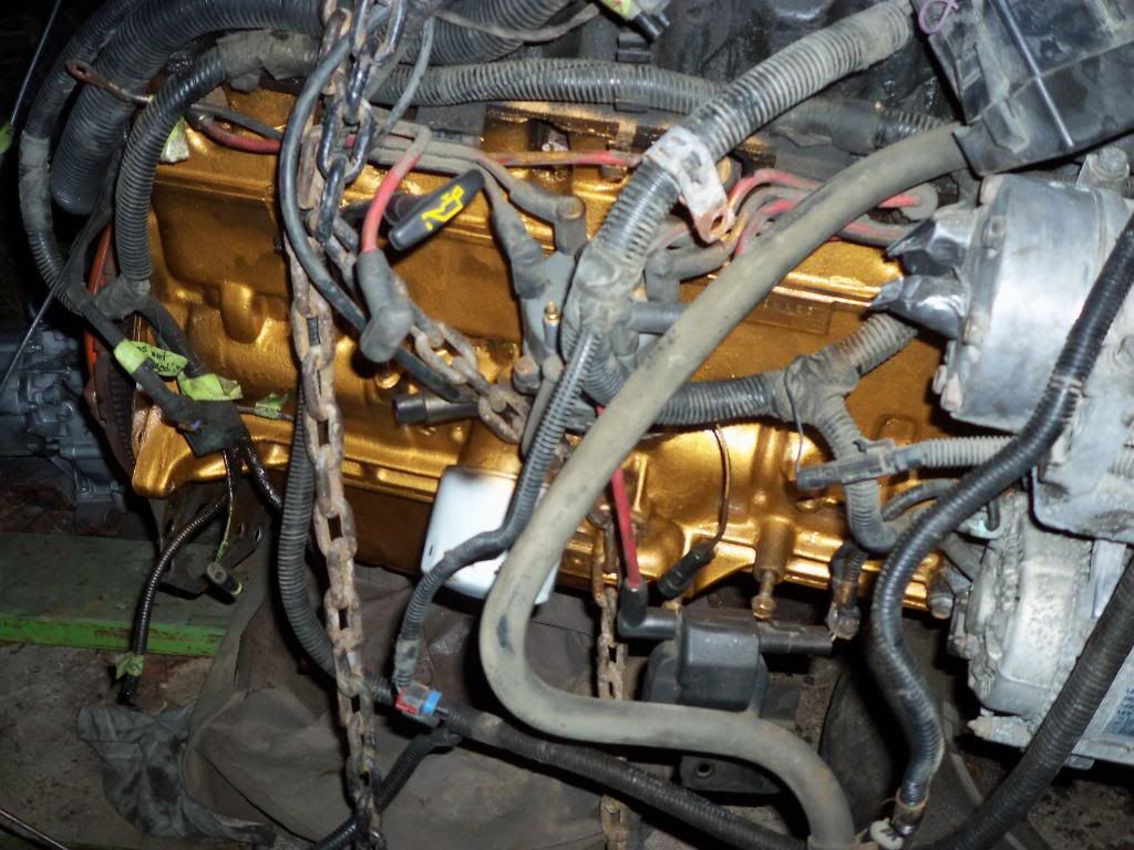

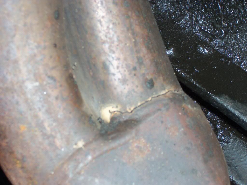

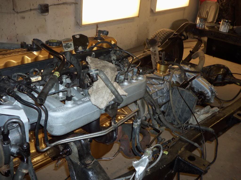

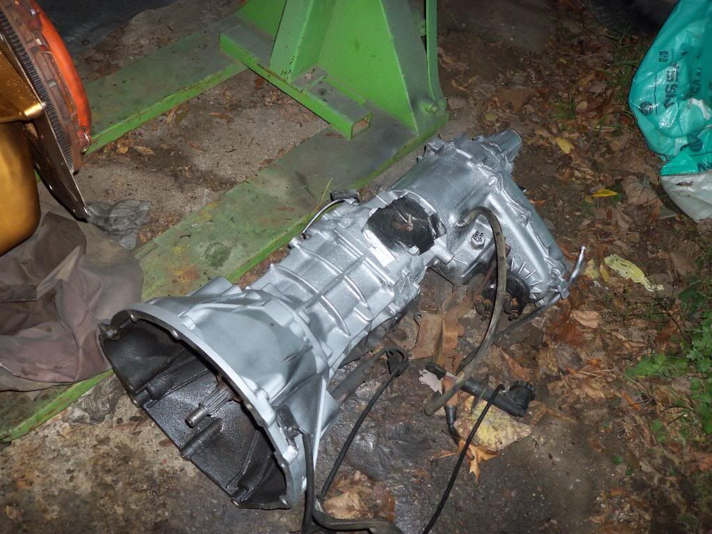

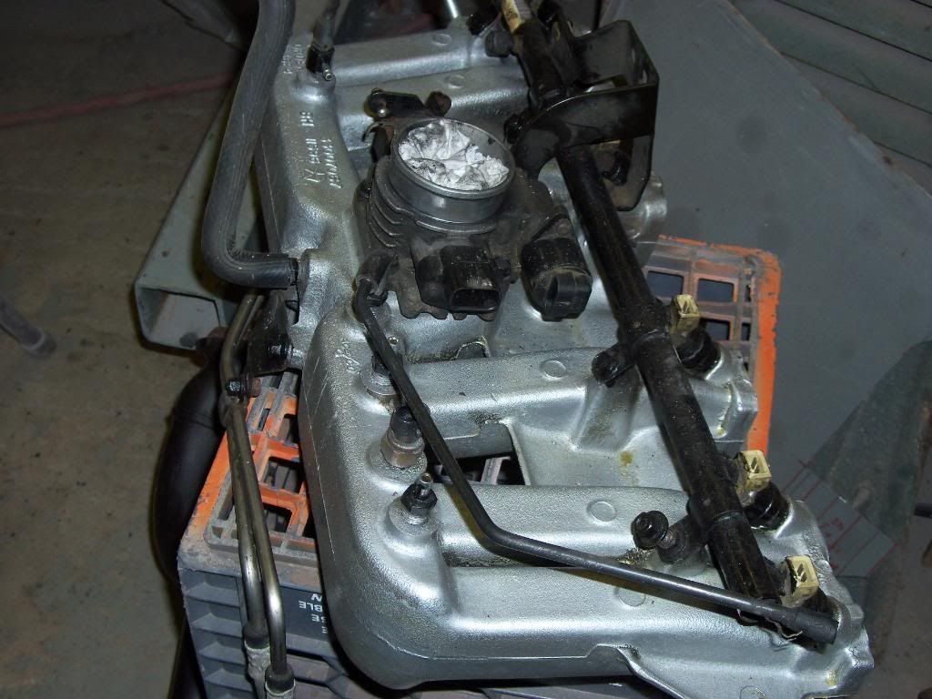

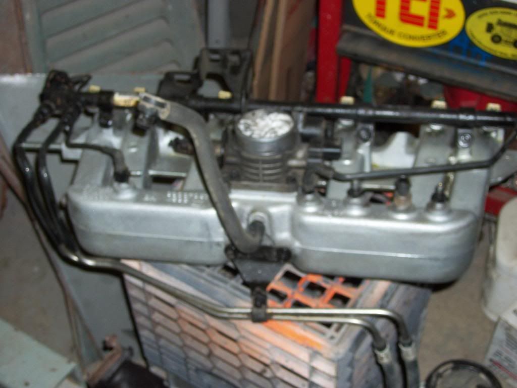

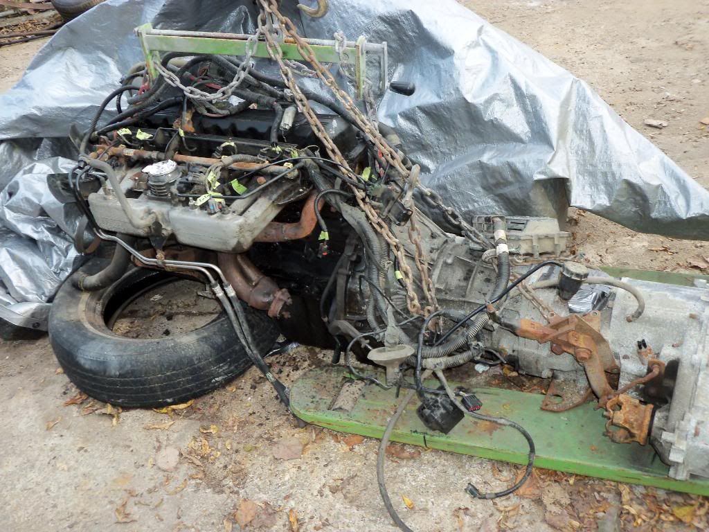

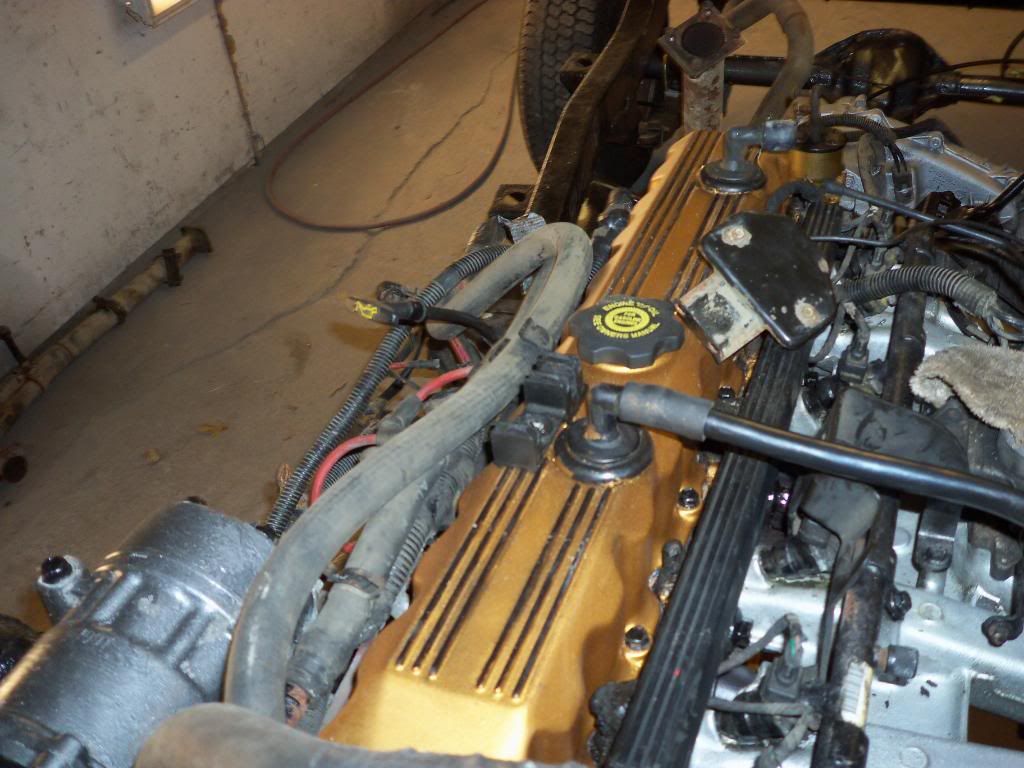

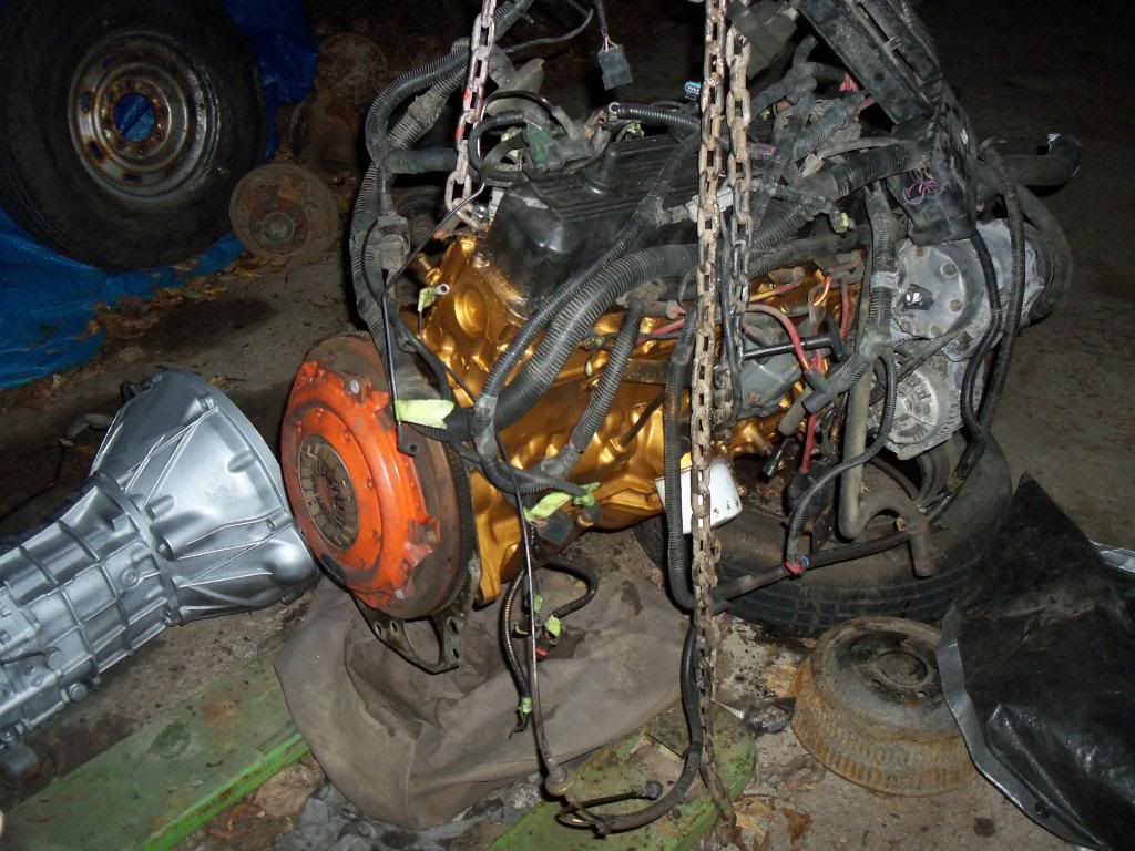

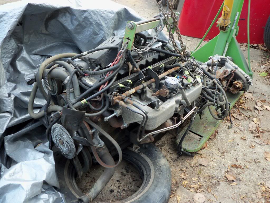

i didnt get nearly as much done as i'd hoped to this week. i did pull the intake and exhaust manifold off as well as a few other things. i popped the tranny off to put the clutch from the old motor in, (almost new centerforce clutch i got with the tranny when i did the ax15 swap) and found out that i really didnt need to because the clutch that was in it looks brand new, oh well i guess i have a spare lol. i welded up the crack in the manifold and painted it up. i painted the intake, and tonight i finished up cleaning the motor and painted it up. i have to take the valve cover off anyway so i didnt bother cleaning and painting it yet, while its off i might just dust it in the sand blast cabinet. all the wires and dodads made painting the block a real pain, and thinking about it now your never even gonna see most of it.

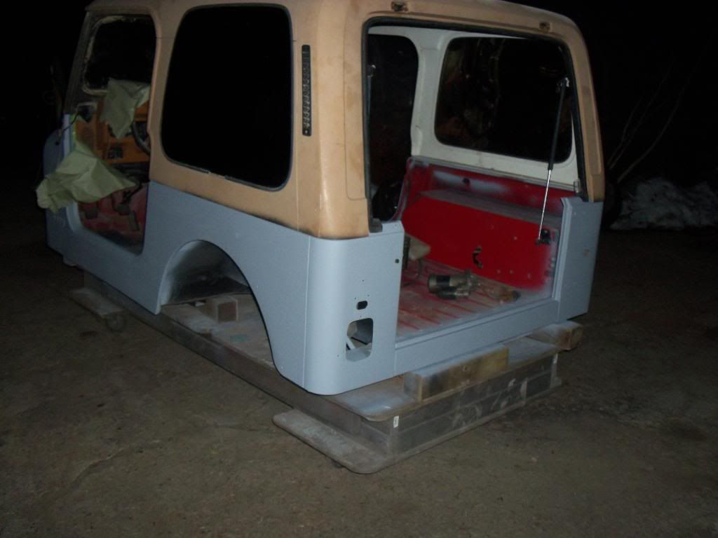

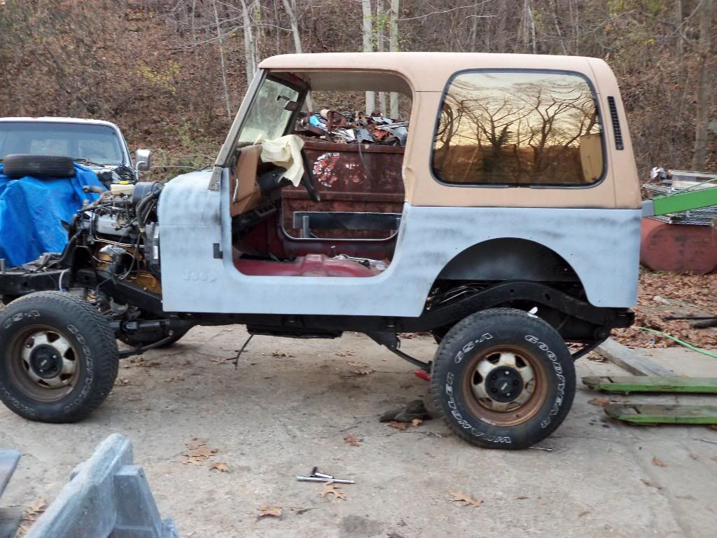

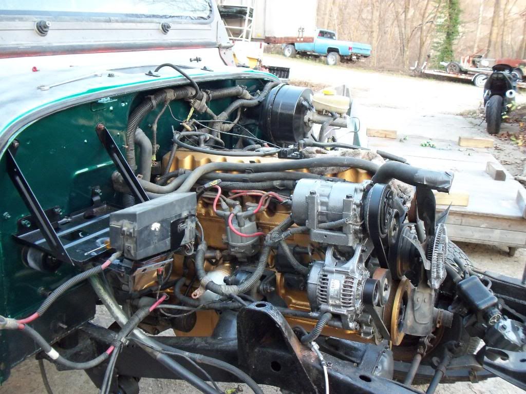

sprayed the hi build primer on the tub. it doesnt really look like im gonna be able to paint it till spring, but thats not gonna stop me from driving it this winter.

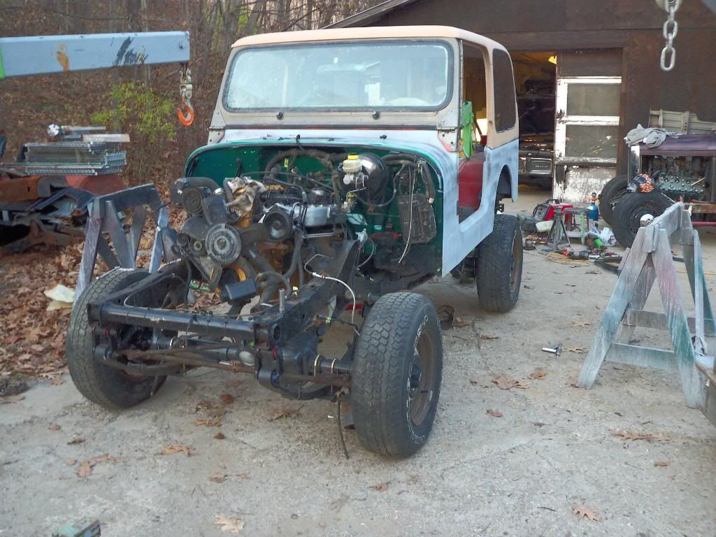

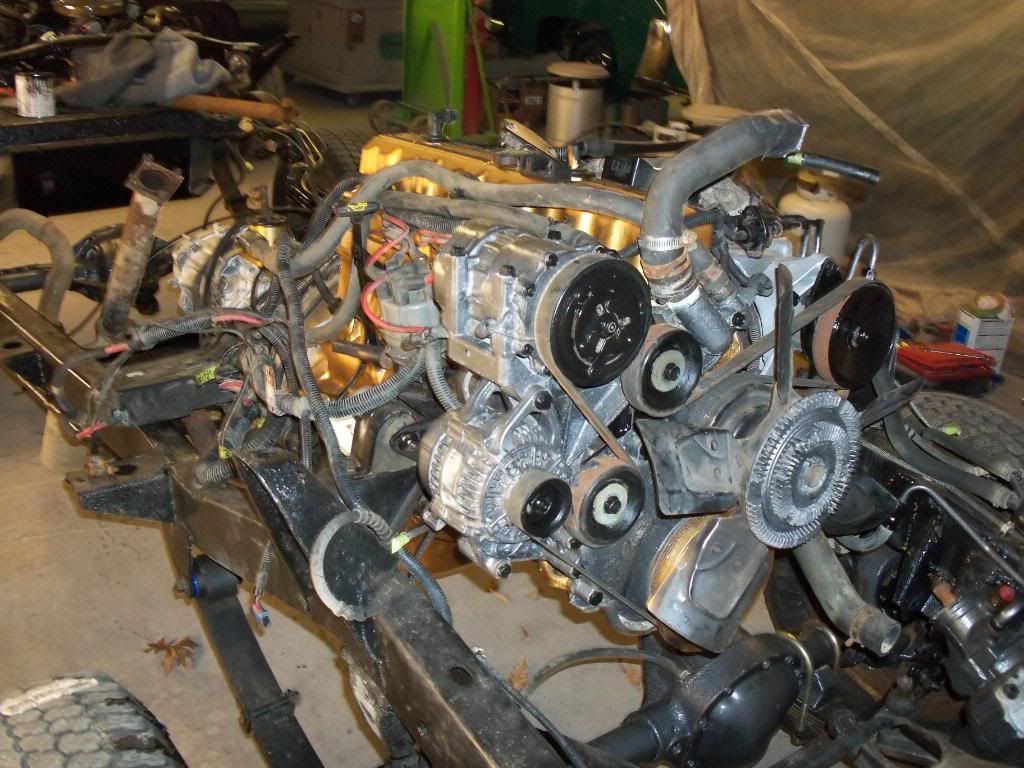

i put the motor in last weekend(outside in a snowstorm ) i painted the valve cover. now im really at the point where i need to start ordering parts again. I think im going to get the daystar 1 inch body lift kit, i need new bushings anyway so figured why not lol. i need to get extended brake lines, shocks, and u-joints. Does anyone have any suggestions for shocks? what are the cheapest decent shocks? Tomorrow im gonna paint the firewall, and as soon as i get the chassis all set(at least from the firewall back) i can bolt the tub back on the frame. i dont mind waiting till spring to paint it, but im not pulling the whole thing apart again! anyway here is some pictures
Primer!

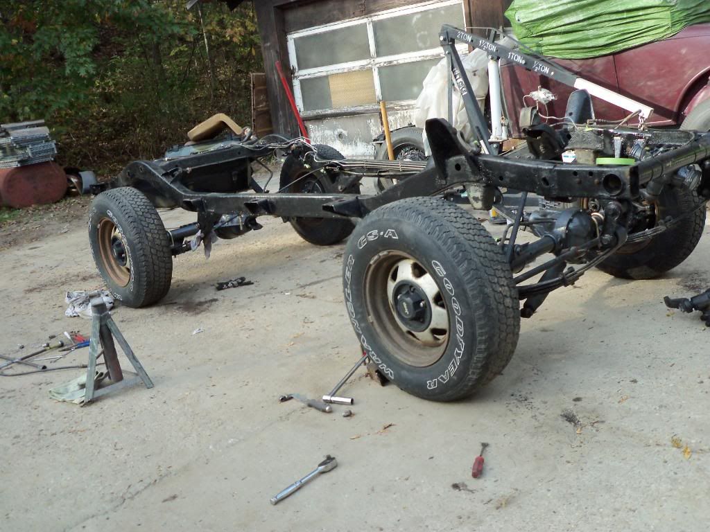

Chassis
and i'll build my exhaust tomorrow too, it was non existent on the 95 and the the 88 had a few holes, so i found some stuff around the shop.

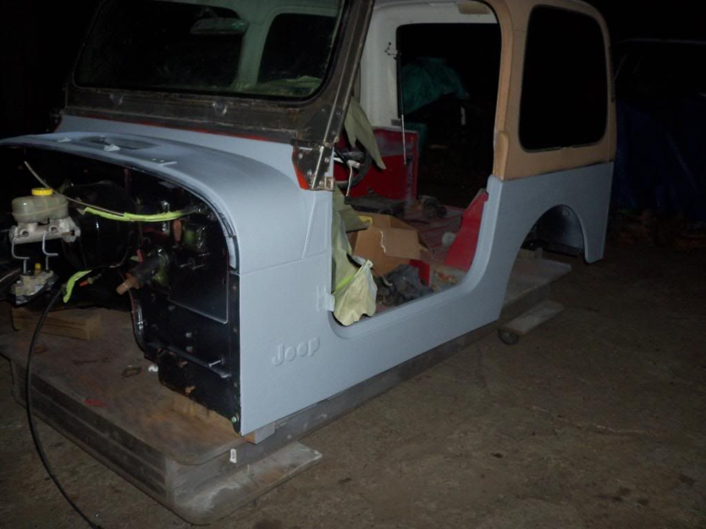

last weekend i painted the firewall, but this weekend ive got to repaint it. i sprayed the base then realized i didnt have enough clear . i got some parts, i installed the extended brake lines. I still need to finish the exhaust and do the transfer case drop. also found out i got the wrong axle shims, i got 2.5 degree shims for some reason and i think i need 8 degree. ive got alot going on right now, between the jeep and trying to fix my grandma's mobile home. 2 BIG projects that cost me alot of money, to add to that i just blew the rearend in my El Camino(daily driver). everything has gone wrong this past week, but hopefully at the end of the weekend the tub will be on the frame( i got the prothane 1in. body lift)

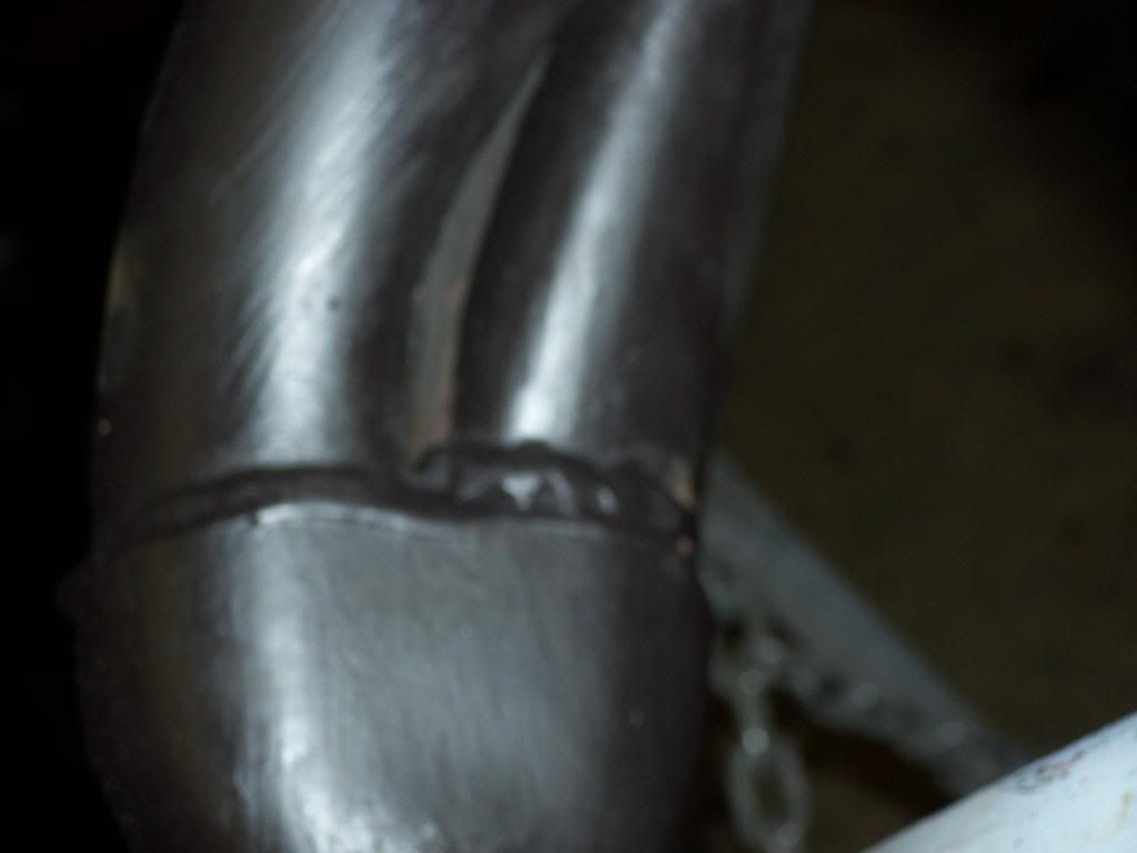

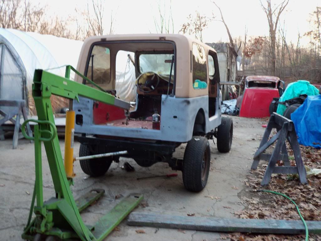

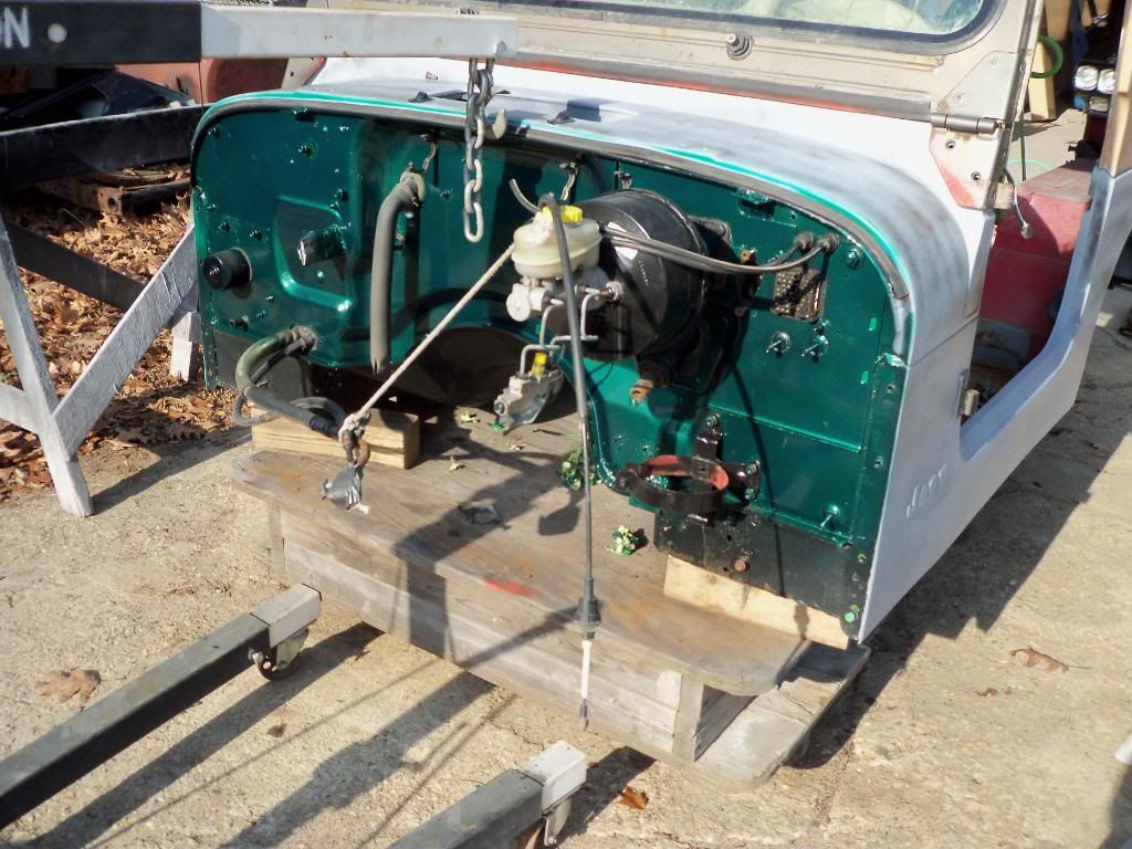

I done it! I got the the the tub on the frame. I repainted the firewall yesterday and made my transfer case drop with some 1in square tubing. I finished up the exhaust today. I got scared a few times trying to put the tub on myself, when you've got a big ole hunk of steel, that weighs god knows how much swinging around 10 feet up in the air its a lil nerve racking. but I got it on there and got all the bolts started. BTW I highly recommend the prothane 1 inch body lift, its complete and the instructions tell you what you need to know. now I cant wait to put the 33s back on. its almost looking like I'll have this thing on the road before I can fix my car. just a few more things

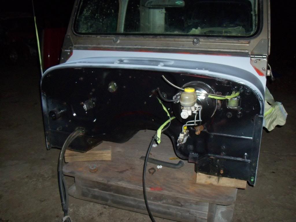

firewall
it looks funny right now
this week after work im gonna try to get all the wiring set, the rollbar in, inside herculined, and at least the grille on. hopefully next weekend it'll be running.
