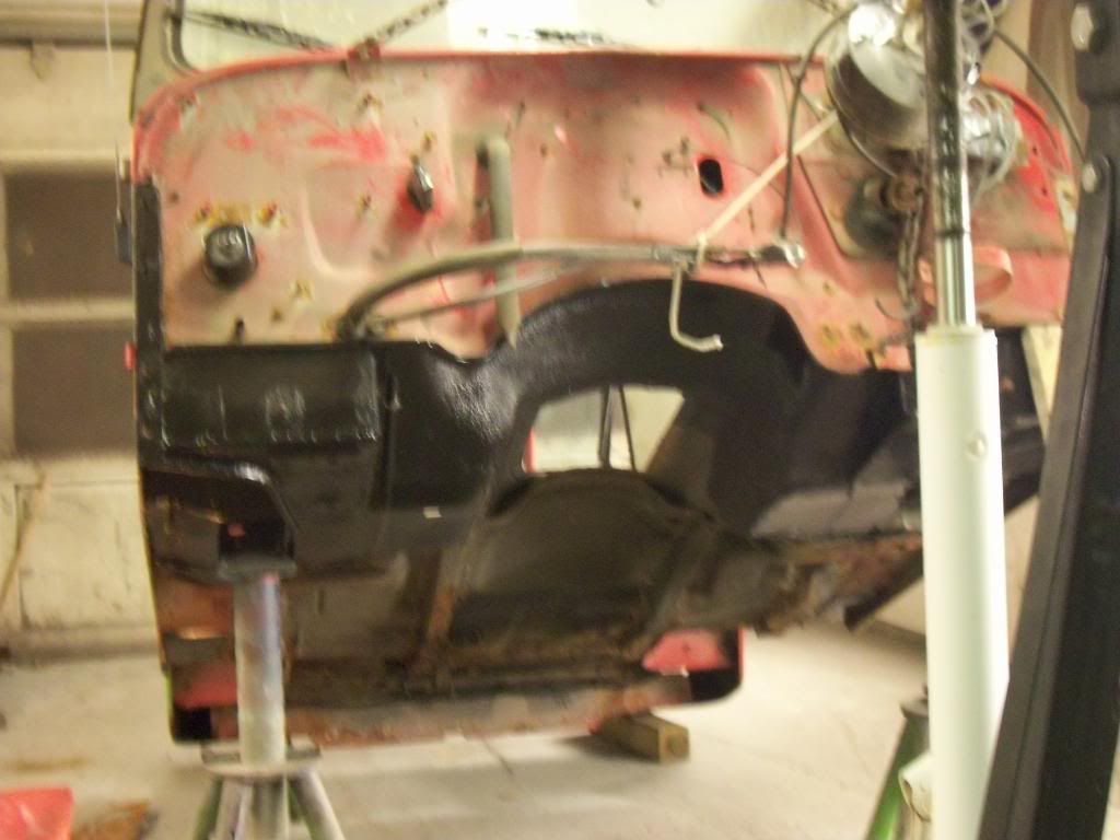

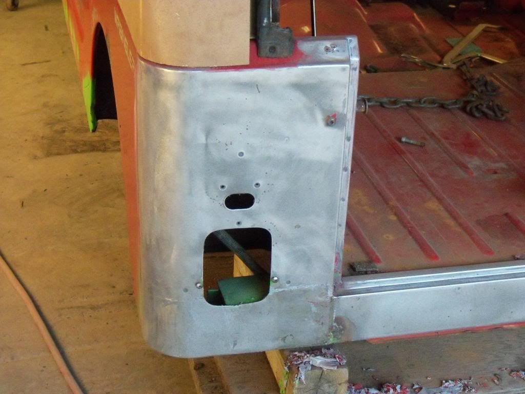

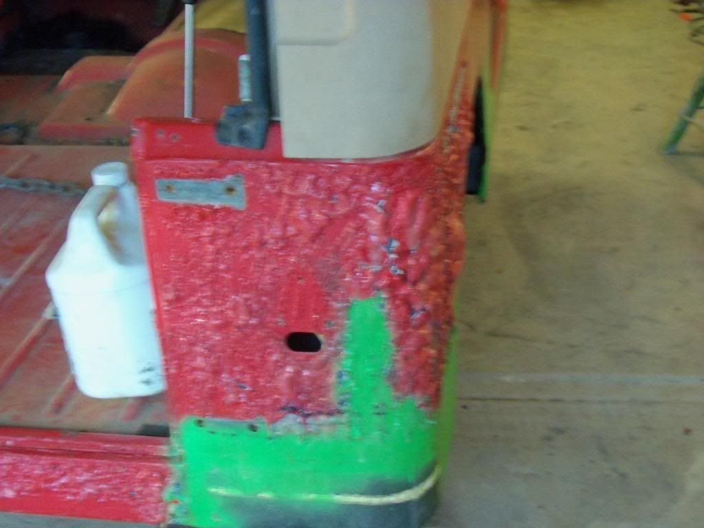

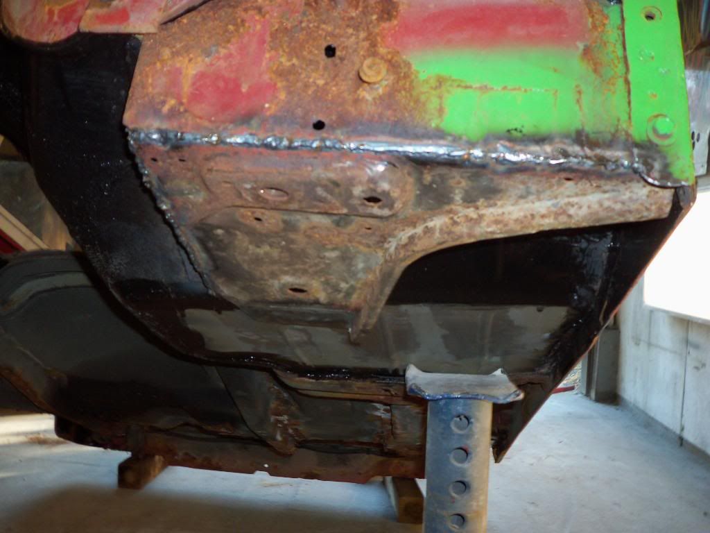

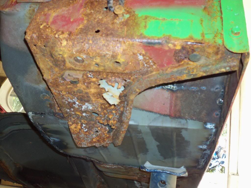

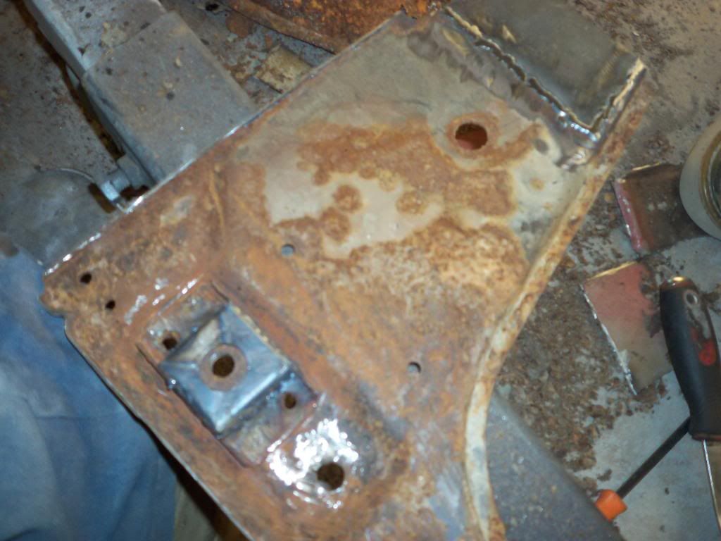

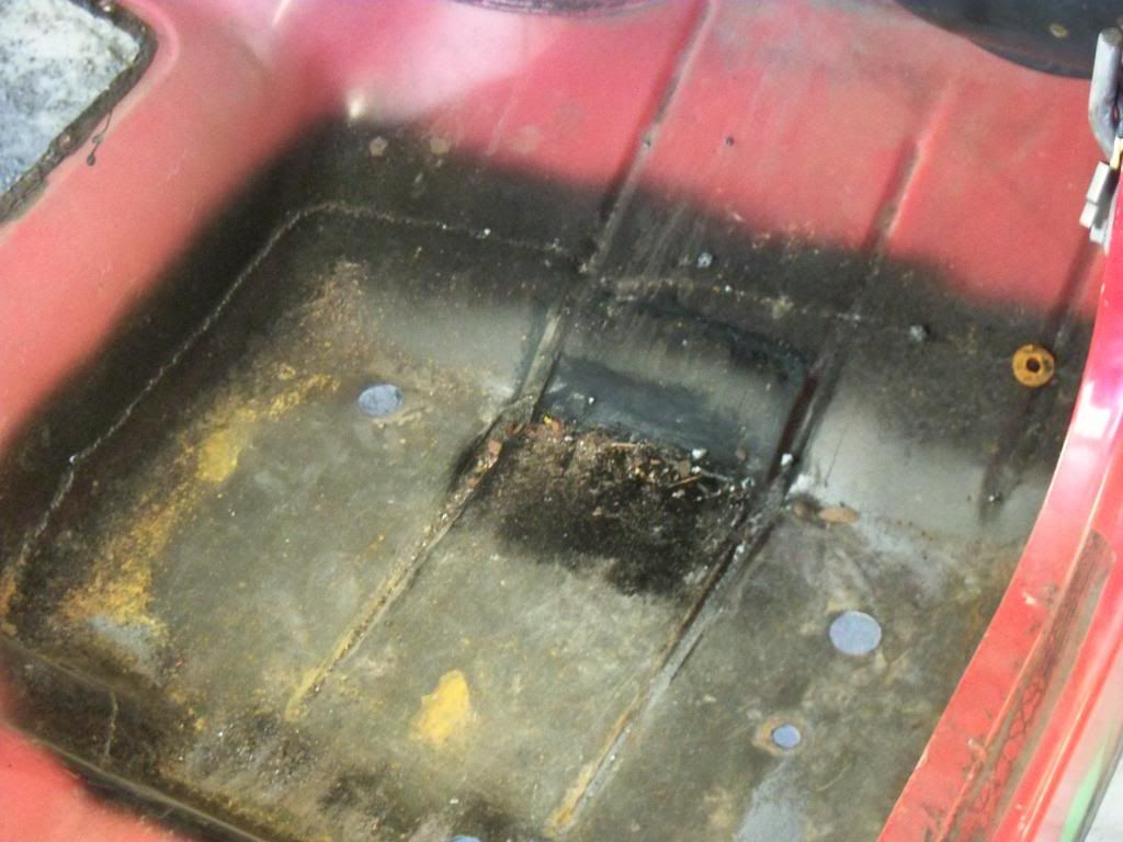

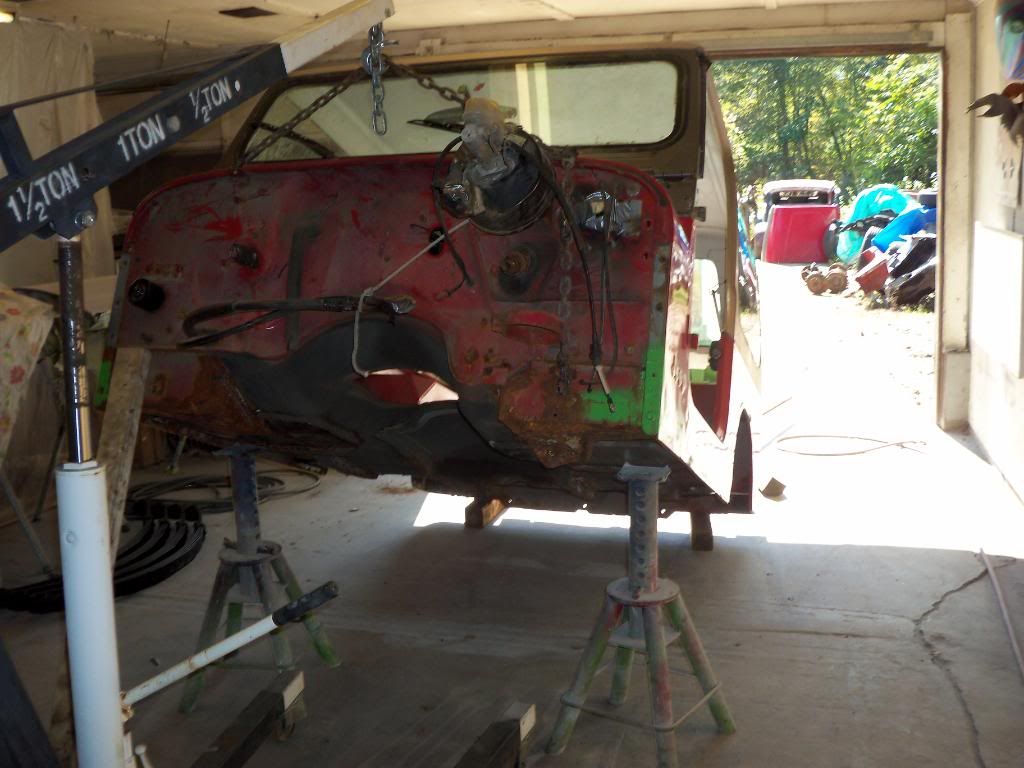

i havent gotten alot done in the past two weeks.the mustang that was in the way took a little longer to get done because the other guy i work with decided to have a heart attack 2 weeks ago.but since friday night i feel i have done alot!! i finally have a spot inside to work again (for now) the floor is fixed on both sides, i repaired all the body mounts underneath, i got rid of the other body and the 4.2 and the axles. i picked up my new springs, I ordered them without bushings and then found out bds springs require special bushings so im still waiting on the correct ones. all the welding is done on the bottom of the tub and i brushed some paint under there, and now im ready to start bodywork YAY!!!
Floors
fixing front body mounts
i cut the braces off the other body
started painting underneath
then i had to jack up the back and fix the rear body mounts
then i got bored and started stripping lol
tomorrow i'll sandblast the welds and start muddin er up.

Originally Posted by rulppa View Post
What is this stuff you use to get paint off like this?Seems pretty effective.. nice job, keep it going!
its paint stripper, any autobody supply store would have it, or an advance auto parts store. the stuff im using is real cheap stuff, usaually it doesnt work worth a crap on stuff with multiple layers(several repaints) but luckily this jeep has the original extremely thin factory paint and it basically just fell off. for thicker paint i'd recomend this stuff http://www.autobodytoolmart.com/klea...3-p-12815.aspx , its expensive though.

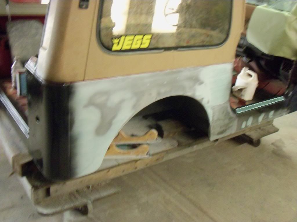

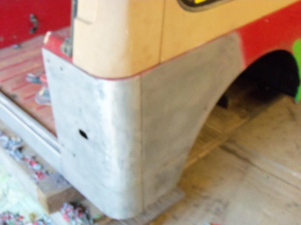

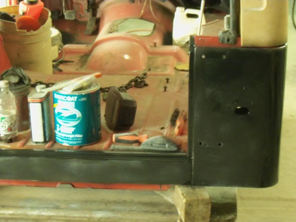

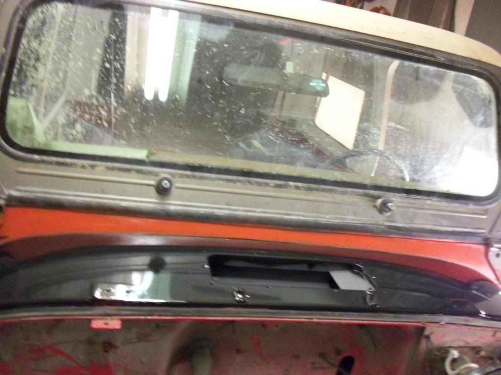

I didnt have to work today so i messed around with the heep a little bit. im kinda disappointed though i didnt get as much done as i should have, i guess im just tired lol. i stripped the whole passenger side and the cowl. i sandblasted the welds and started spreadin mud. i got the rear tail panel done, the right rear corner, and the cowl done and ready for high build primer.
the rear corners were pretty rough. after the bodywork was i sprayed a sealer over it because it might need to live out side for a couple nights this week.
the cowl was pretty good, just a couple dings. i used ppg DP90 epoxy primer thinned out a bit to seal it up.
by the end of the week the tub should be done. i dont have enough money for the hi build primer just yet so that might have to wait till sometime next week, unless i just steal some from work

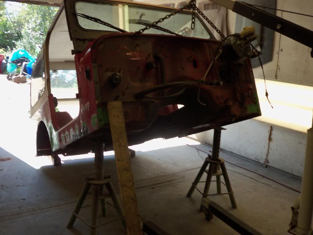

I finished the bodywork on the tub last week. i pushed the other frame up on the cement pad and pulled the motor, gas tank and lines. im gonna clean and paint the engine tomorrow night, this weekend i'll pull the axles and clean and paint them. then i can build my chassis.
