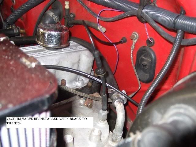

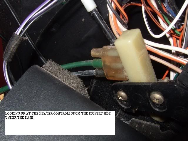

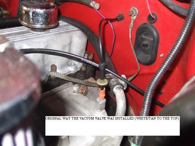

After reading this I was curious if mine was correct or not. I don't know if the guy on the assembly line didn't care which way he installed the vacuum valves or what, but mine was aparently backwards too. Switching this around did seem to help the amount of heat in the vehice. Pics follow. I also took a clearer pic of the hook-up of the vacuum lines to the heater.
I just checked under my hood, and it's like the first picture, but when I disconnected it to flip around the black tapered side is clearly marked V A C... the stem on the blonde end is also much thinner, so I'm going to say it is already on correctly and it's not meant to be flipped around, and if it worked better for you after you ran it backwards, it's probably defective. I looked under my dash and the vacuum lines are where they're supposed to be. I guess my heater core is clogged after all.

jaminb
Location: Canton, MI
Posts: 818
i flipped mine around, it does not make the air any hotter, if anything is is colder, but it puts more air out, which helps it get around the cab more. So when it really cold out, its still going to be rather cold in the cab.
