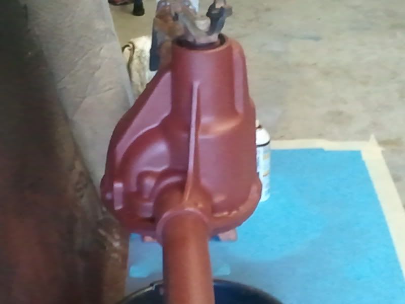

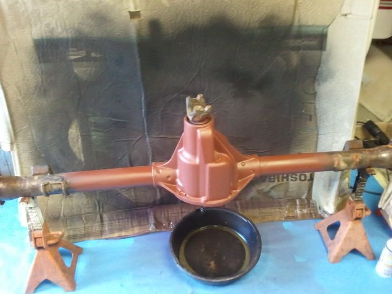

update time..
I have had to make some major modifications to this project due to funding.
Gearing has changed from my dream of 4.10s to the reality of 3.54 since the dana 44 had them in it. I found a front dana 30 with 3.55s for 95 bucks on Craigslist.
I pulled the Dana 44 out of the backyard and hit it with some primer.
I need to complete grinding of the old shock mounts off still
I am working on getting the brakes together now anyone have a good diagram for this?
Spring perches are ready, new shock mounts are ready.
I have have alot to do to finish this....lol

Score! finding those matching gears will get you on the road cheaper and quicker.
Those shock mounts look gone enough. why did you grind them down and just just cut them off closer? either way... leave the nubs. you plan on showing that thing?
Just do the brakes one side at a time. Hit the cherokee forum up for pics or a diagram.
A tip- while they are both pulled out. go over the yokes and make sure that it will be easy to bolt up the u-joints when you are ready. I didn't do that and had to deal with it after my axles were mounted under it. they were clogged with junk

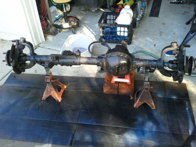

Originally Posted by ssyj94 View Post
You could just get a 4cyl 4.10 front and regear the 44 to 4.10. The 3.55's arent goin to be much of a gain in gearing for 33's. Ruffstuff sells an install kit with perches, ubolts and spring plates thats reasonibly priced.
Its funny you say get the 4.10s that was my original plan to take a dana 30 and 35 eeek out of a four banger. I found this axle on the Cherokee right next to it.
