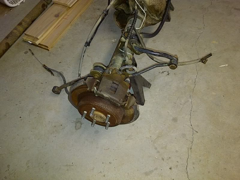

Pics of the 8.8 I picked up, looks to be in really good shape.. It is 3.73 gears so that is my plan to go with. I will be regearing the D-30 with new bearings, carrier etc to match this one..

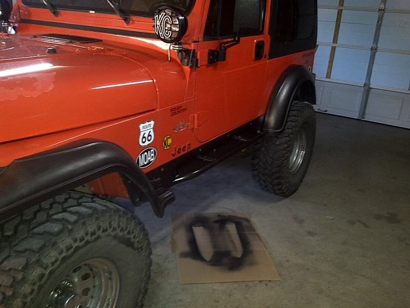

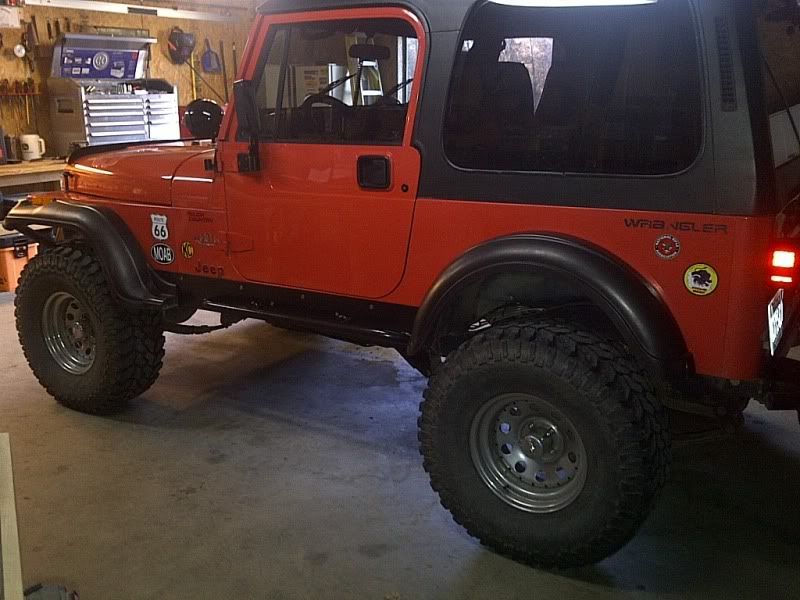

Here are some pics with the sliders finished up... I think I am going to like them but it takes a little bit to get used to them when you step out of the jeep, they sit much higher than my old nerf bars..

Those sliders look good. Where they hard to install? Thanks for the info about the lights. I will talk to some of the vendors on the Arkansas Crawlers forum about a set.

Looks good! They'll give much better ground clearance than your old nerf bars.
Thanks, no they were actually easier to install than expected.. I did have to go buy some additional hardware, the longest bolts that came with them was 2.5" and I needed 3" to reach through the two rear bottom holes.. I also upgraded the hardware to 3/8 bolts. I think the ones they sent were metric something but they were a little smaller. I still need to beef up my washers on the inside of the tub but I think I am going to cut some 3/16 or 1/4 plate and use on the inside to stiffen up the tub walls a little.
Let me know If you need any help... , im no expert,but I have one 8.8 swap under my belt.
