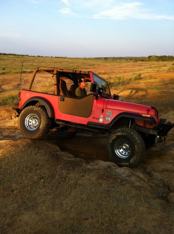

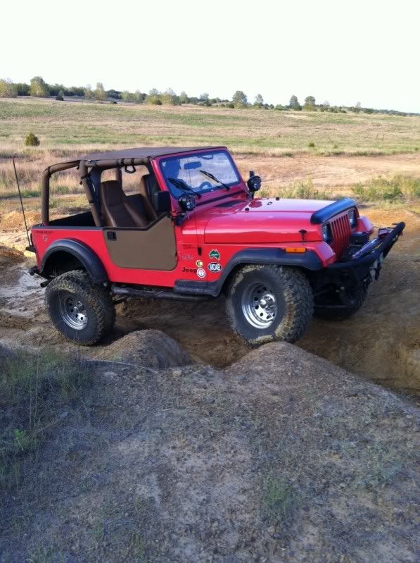

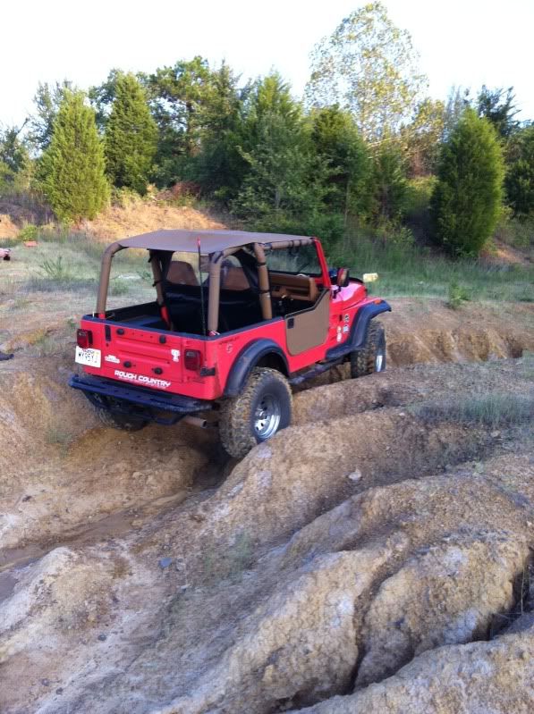

Played around on a washed out ditch today to see what the locker would do. Not once did I get stuck due to opposite corner wheels spinning on me. It seemed to work really well. Still not a good test of the locker but that is coming soon on a weekend when I have the time to travel a little.
Flex Shot - I think Flat fenders are coming next..

Tim, I love the look of my flats and they work great. I think we have the same amount if lift and I moved up to 35s one I put them on with TJ flares in the rear. I guess my only concern is how messy they are going to be in the mud/rainy season. I bought the MCE ones
